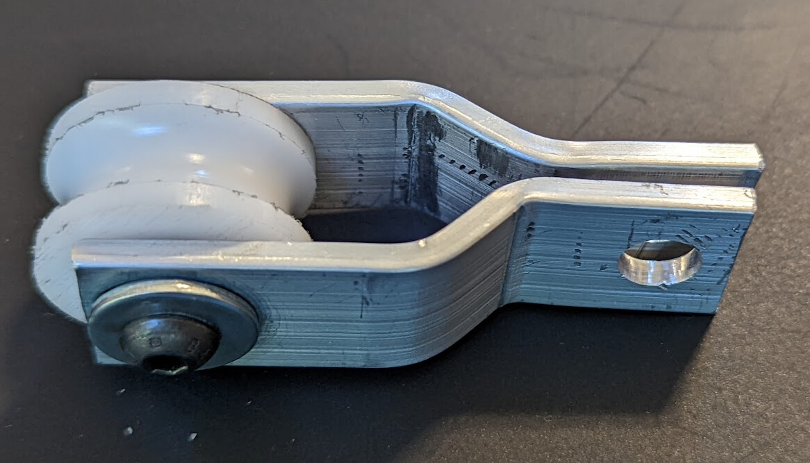

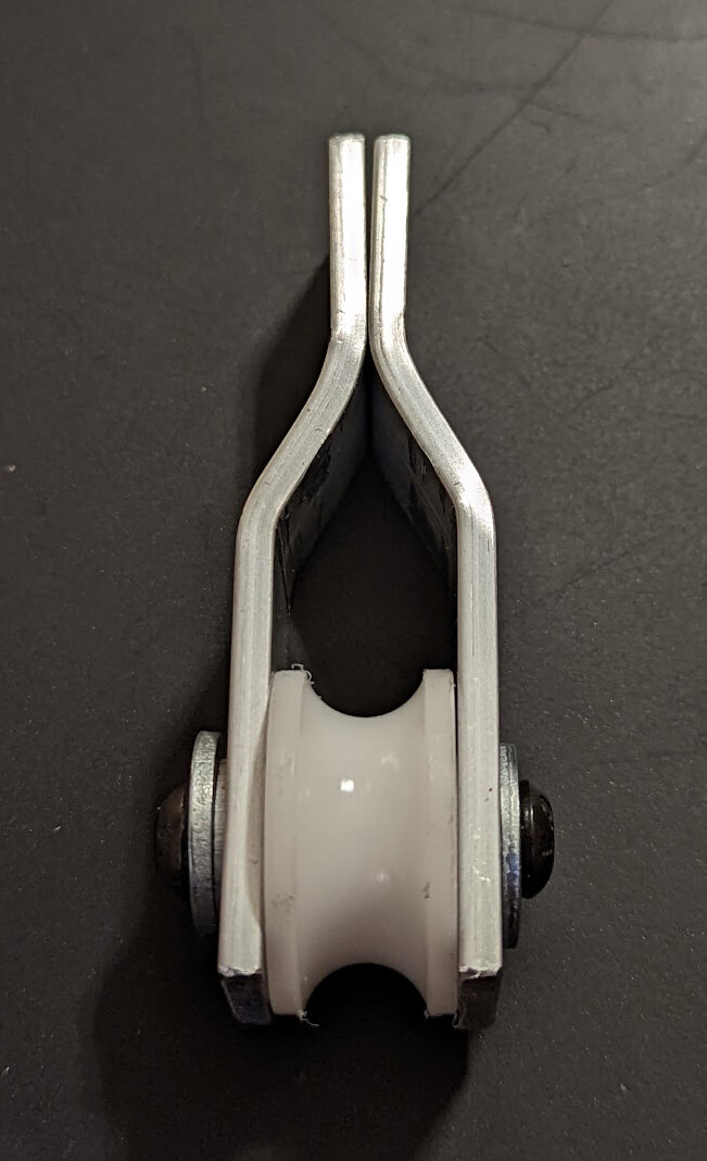

(On this first pass, the ½" holes are closer to the end than the hole diameter because we changed our mind about design partway through, and I could have rounded the edges on the straps. But for a quick and dirty low-load snatch block set, I was pleased.)

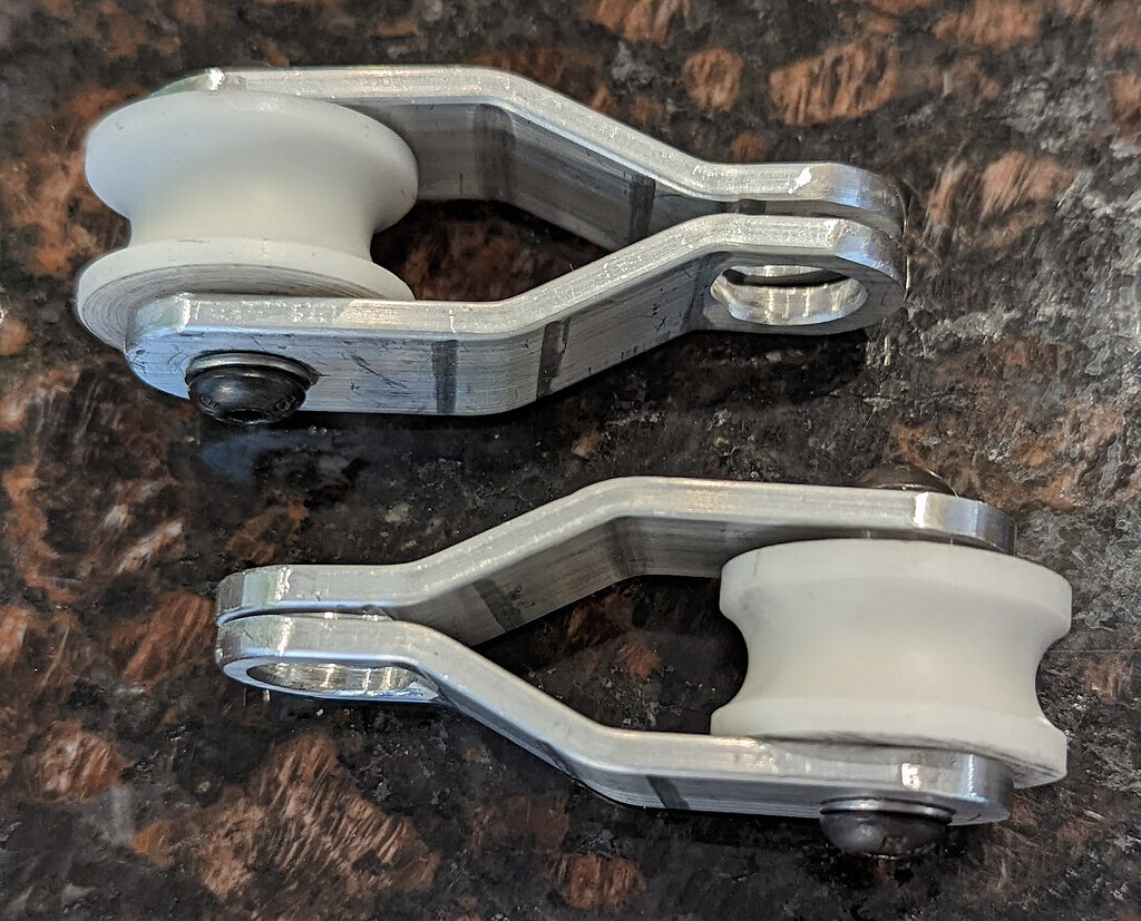

Second set went way better and faster. Figured out how to bend the strap better, so it’s more even, and left more meat around the bushing for strength. This time I remembered to chamfer all the hard edges on the pulley.
The slight outward bend at the loose end of the strap means that when it is loaded, the straps will tend to pull away from the pulley and thus avoid binding.
I didn’t think to polish the outside of the bushing, and if we ever make another we’ll probably do that.
More pictures, just because…
Got a report: The snatch blocks worked well. :tada:

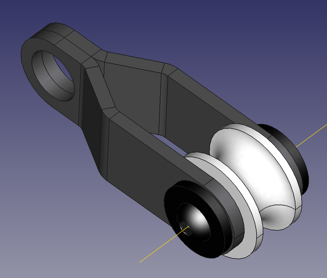

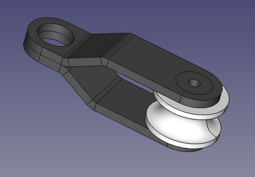

I got a request that the open hole should be ½" like the bushing hole on the next revision. Also, the square corners offend my sensibilities, so rounding the corners…
I’m having some trouble getting fasteners to show up in the right place in my assembly because I’m still learning the Assembly4 workbench, but so far the model looks like this:

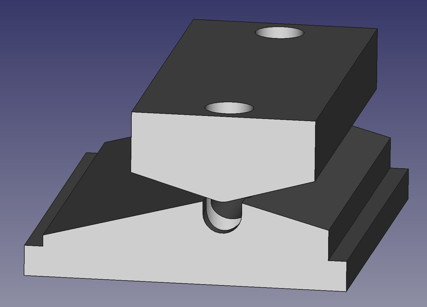

Also, a set of blocks to 3D print or machine to form the bends at the right lengths and to the correct angles, using a vice or press, and accounting for 2° springback in the aluminum bar:
It’s wide enough to do two bar segments simultaneously, so that they are a properly matched set. :relaxed: The different lengths on the bottom block are references to set the lengths of the two ends of the bars.
Figured out how to add the hardware correctly.
I’m not done making drawings, but I think the model is at the point that someone else could reasonably benefit from it, so here it is:

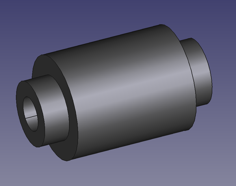

I put shoulders on the bushings so that I can avoid the weight of washers on the ends. There is no real need for washers on this.
I also shortened the arms a bit to remove unnecessary material.
I added (amateurish, that’s me!) drawings too:

Inspired by the 3D printing press brakes experiments I did a few years ago, I wanted to try 3D printing bending blocks to form the bends in the arms of the snatch blocks.
I modified my bend forming block and anvil to have guide pins on either side, and to have steps in the anvil to set the lengths for the pieces to bend.
I 3D printed the bend forming parts out of PETG. Mostly solid layers, lots of perimeters, with a few 80% inflil layers deep in the inside to speed up printing a bit.
I tried bending a scrap of ⅛" 6061. This… isn’t anywhere close to a 150° angle, and the plastic deformed.
I guess I should try PLA, but really at this point I think that the right thing is to redesign them a bit and mill them from solid aluminum instead. I need to think about the right way to do that.
Two more pieces on my scrap PETG pile, one very slightly bent piece of 6061 scrap, and back to the FreeCAD drawing board!
These will be interesting to machine. I wonder whether I need some more tools for this? :smiley:
