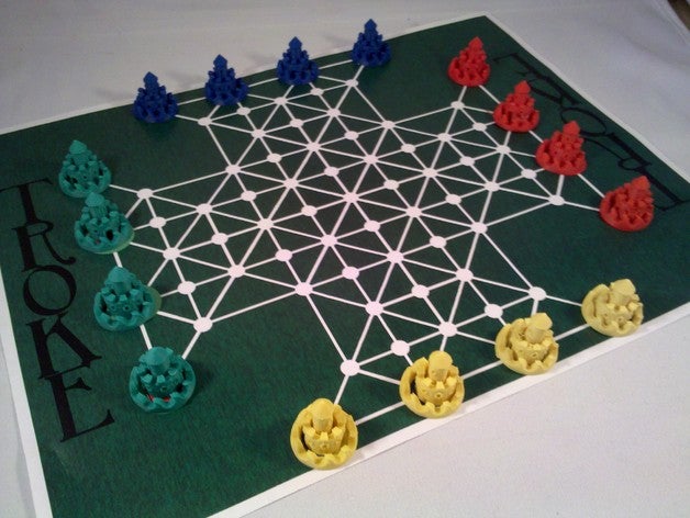

The pieces came yesterday and I was BITTERLY disappointed.
Imagine if you printed a chess set to be played by ants. That is what I got. TINY TINY pieces, pretty much worthless. You can’t see the wonderful detail from the design.
So, I’m wondering if the original files are that size, or did I make a mistake, or did the company make a mistake, or what.

So, maybe you could advise me. How do I get these pieces to be about three times larger than they came out? The circular piece, the “Moat” came out barely one inch in diameter.
The game is named Troke, and I found the files via BoardGameGeek.

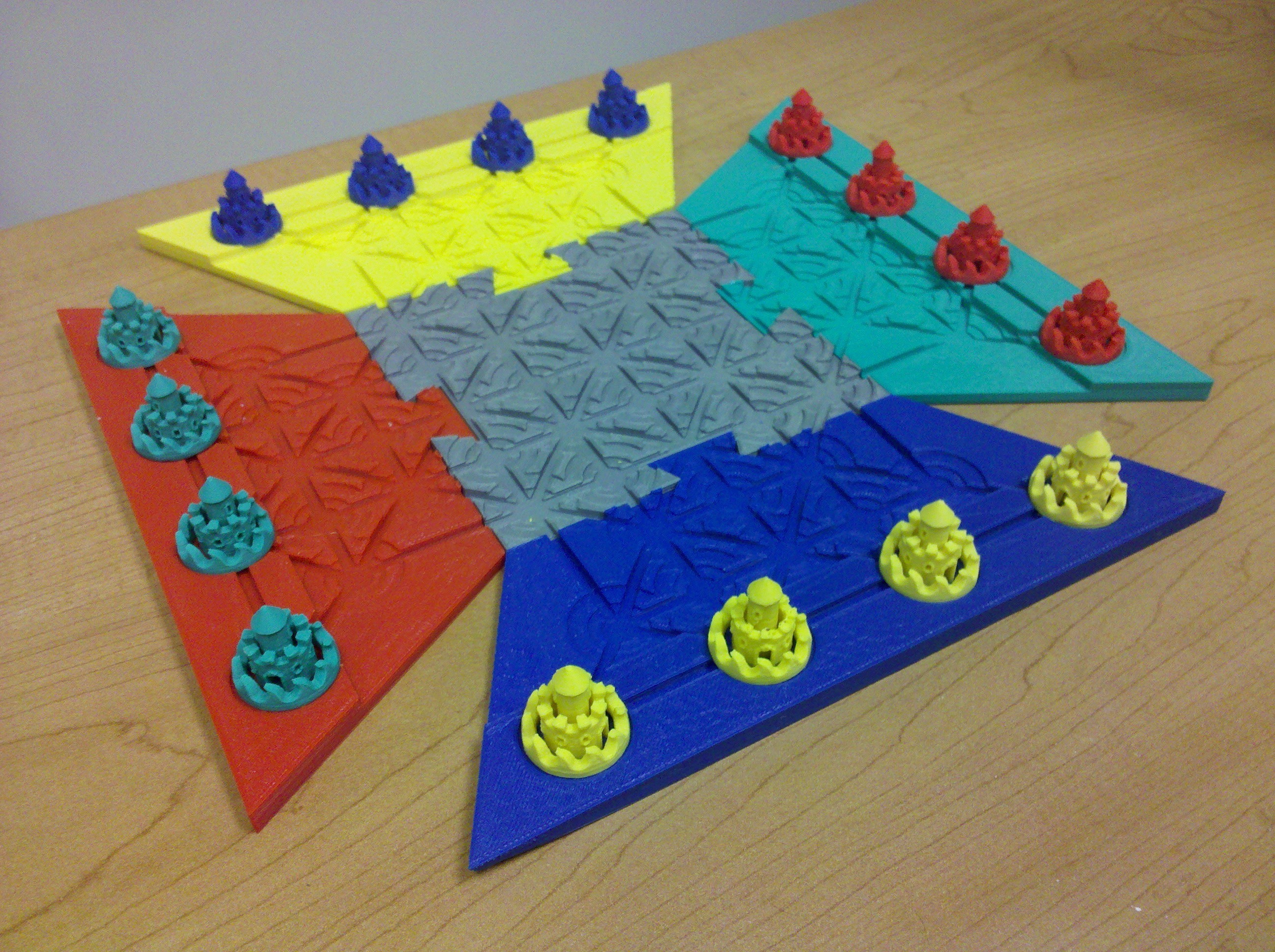

I downloaded the files and opened them with Windows 10 Print 3D app, which allows you to change the units on the fly and see it rendered on a grid with dimension markings. The sizes of the 3 parts are (roughly) ~18mm, ~8.5mm, and ~7mm.
If you changed the units to inches they become significantly larger than what is shown in the pictures of people playing the original version on the game site, but would be more in line with the graphic shown of the 3D printed pieces (but hard to say for sure with no item in view as a concrete size reference).
Also, the playing surface that is shown in the 2nd picture on Thingiverse seems to have been omitted–the STLs are not there, just a PDF (that is an 8.5x11 inch sheet).
