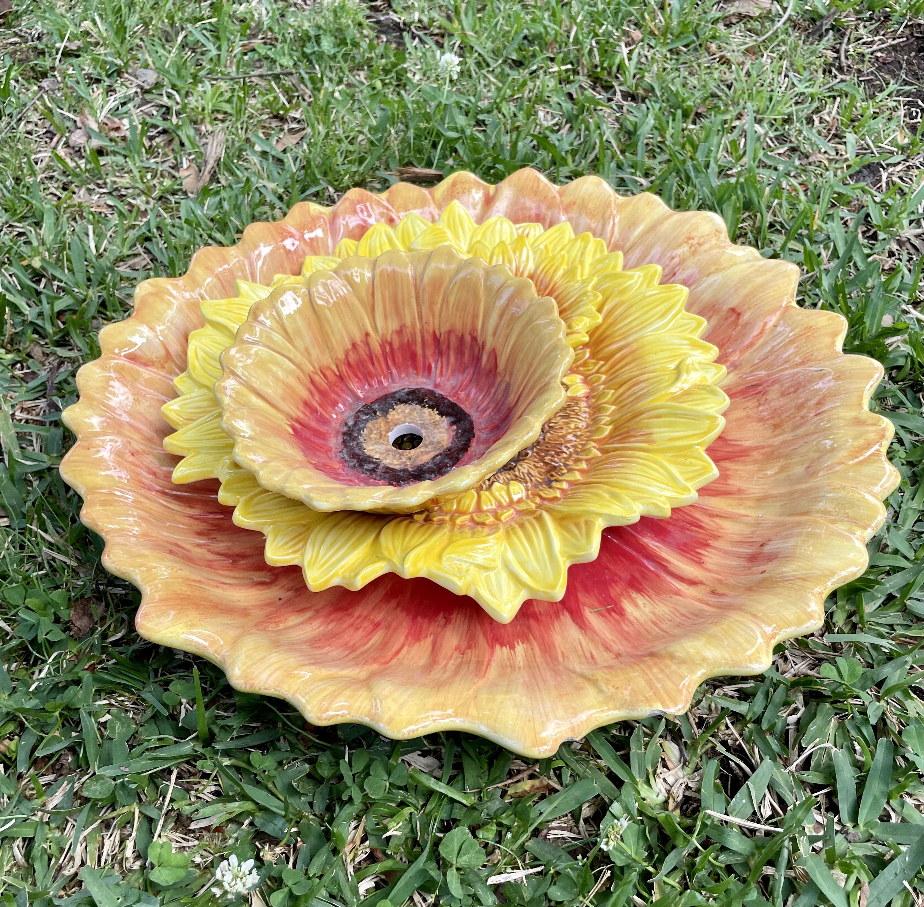

Over the years we’ve had a number of different fountains. Some homemade, some store bought. The wife decided it was time for a new one and gave me 3 ceramic sunflower plates we haven’t used in a long time. She said she wanted to use these to make a new fountain. Challenge accepted
Biggest plate is about 16 inches in diameter. The general idea I had was to have a bucket base and a stem that run up the center of the plates. Water would go up the stem and cascade down from the top and back into the bucket

Turned out really nice.
It has a small amount of splash out, which isn’t ideal, so I’ll have to keep an eye on it until the parts for the auto refill come in from AliExpress. I’ll also use an algicide to keep down on algae growth.

Bet the ceramic drilling was nailbiter…
Yeah, this design shouldn’t have problems with clogging, but I’ve had that issue with past fountains as well. Usually used some filtration foam to act as a coarse filter, but you would still need to clean it out periodically.
The diamond hole saws were actually very smooth drilling. The trick is getting them started because they like to jump around until they start a groove. Using the laser cut hole jigs made it very easy to get started though.
