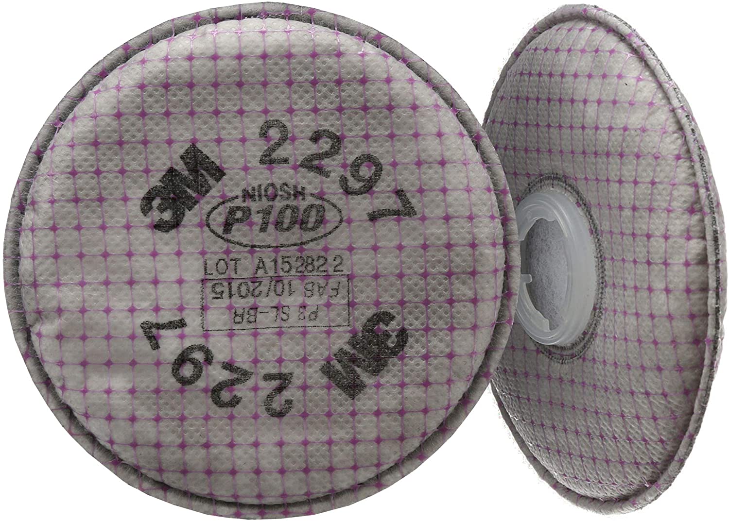

i think i need a pair of P 100 Cartridge, but when i go to amazon there is multiples options for the same Cartridge , like :
Acid Gas
Ammonia Methylamine
Formaldehyde Organic Vapor
Organic Vapor Acid Gas
so with one should i pick?
also i am planing to work with a router and make some wood work, i think that for that i need a dust Cartridge, right? or i can use the same P 100 Cartridge? Thanks!

If you are worried about chemical irritants from laser engraving/cutting carbon filters will work just fine (anything that says organic vapors). I see these particulate filters with a small about of carbon that would probably work just fine.
i will give a try to that carbon filter, thanks for your help bros!
