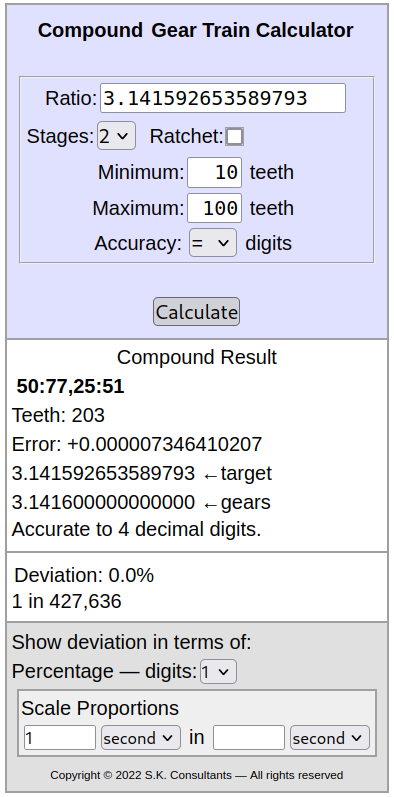

Let’s look at an unreasonable example, approximating pi (in particular, the approximation 3.141592653589793; which is the default example) with two stages:

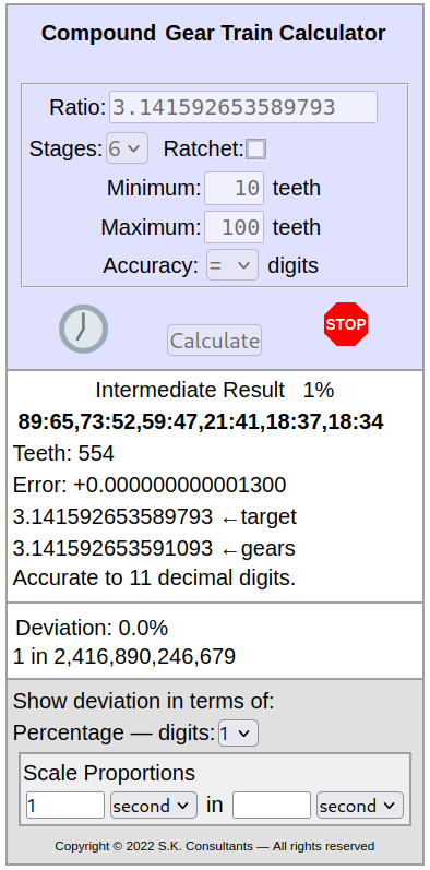

Going to six stages explodes in complexity. It takes a while even to find an intermediate result (less accurate than four stages):

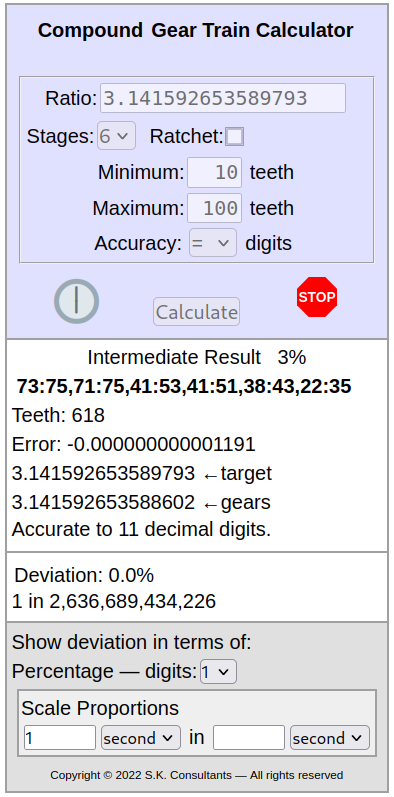

After about a minute, it finally finds something more accurate than four stages:
After maybe another minute, 11 decimal digits of accuracy:
A few minutes later, it still has the same result after covering 1% of its search space. I’ll leave this running for a while! :smiling_face:

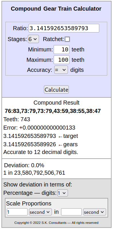

Sometimes if I leave that tab open while doing something else, it makes progress! I now have a solution to my entirely theoretical problem that is within one part in 23.6 trillion, 12 decimal digits…

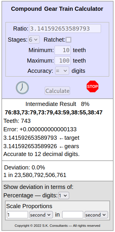

By leaving my personal computer on the calculator tab while working on my work computer during the day, this finished, and it never found a better match than it found somewhere in the first 8% of the search space.
