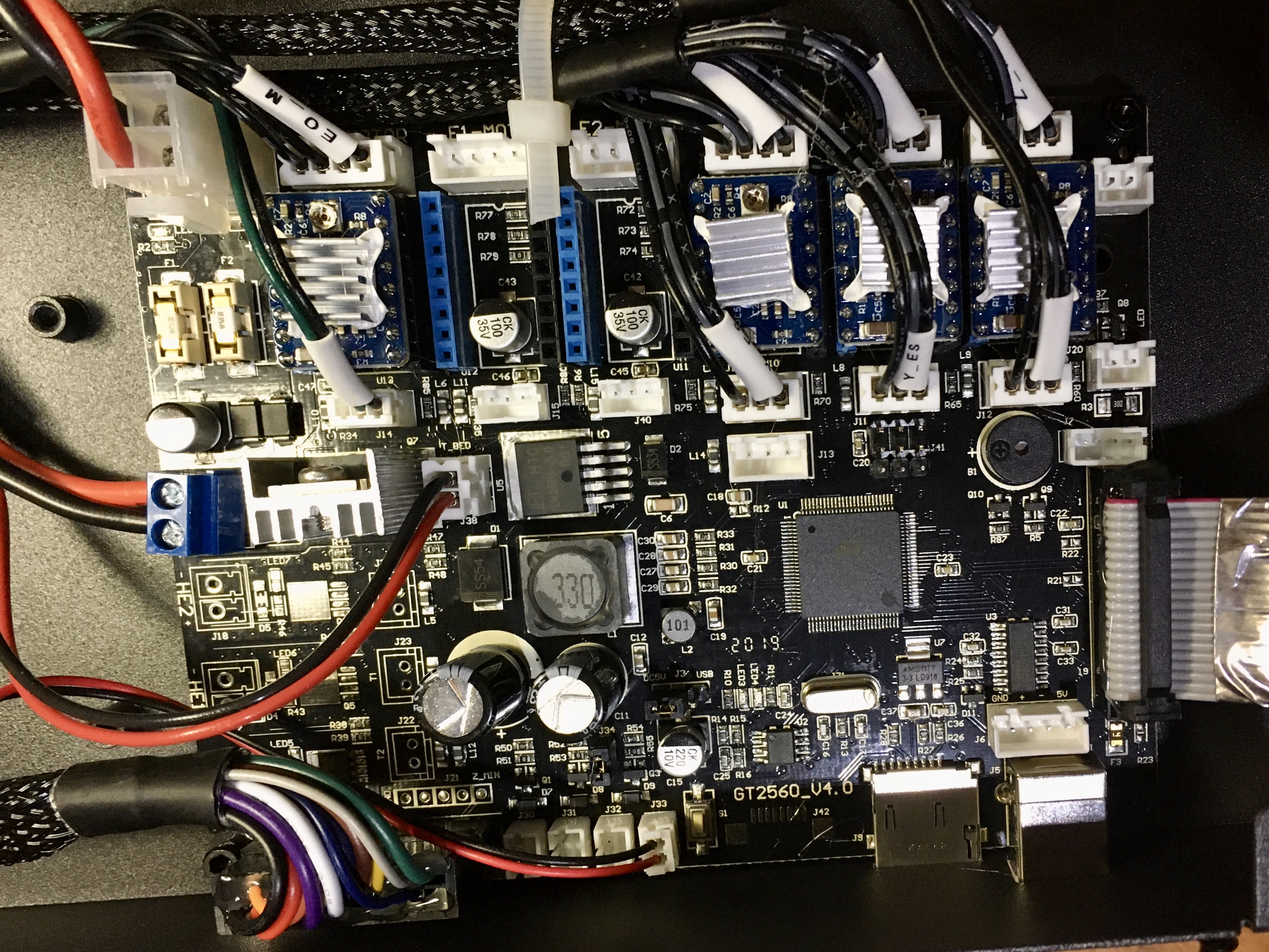

The control board is Geeetech’s GT2560 Ver 4.0 and it comes with A4988 Stepstick Stepper Motor Drivers, which I will be upgrading to TMC2208 Trinamic drivers for quieter operation.

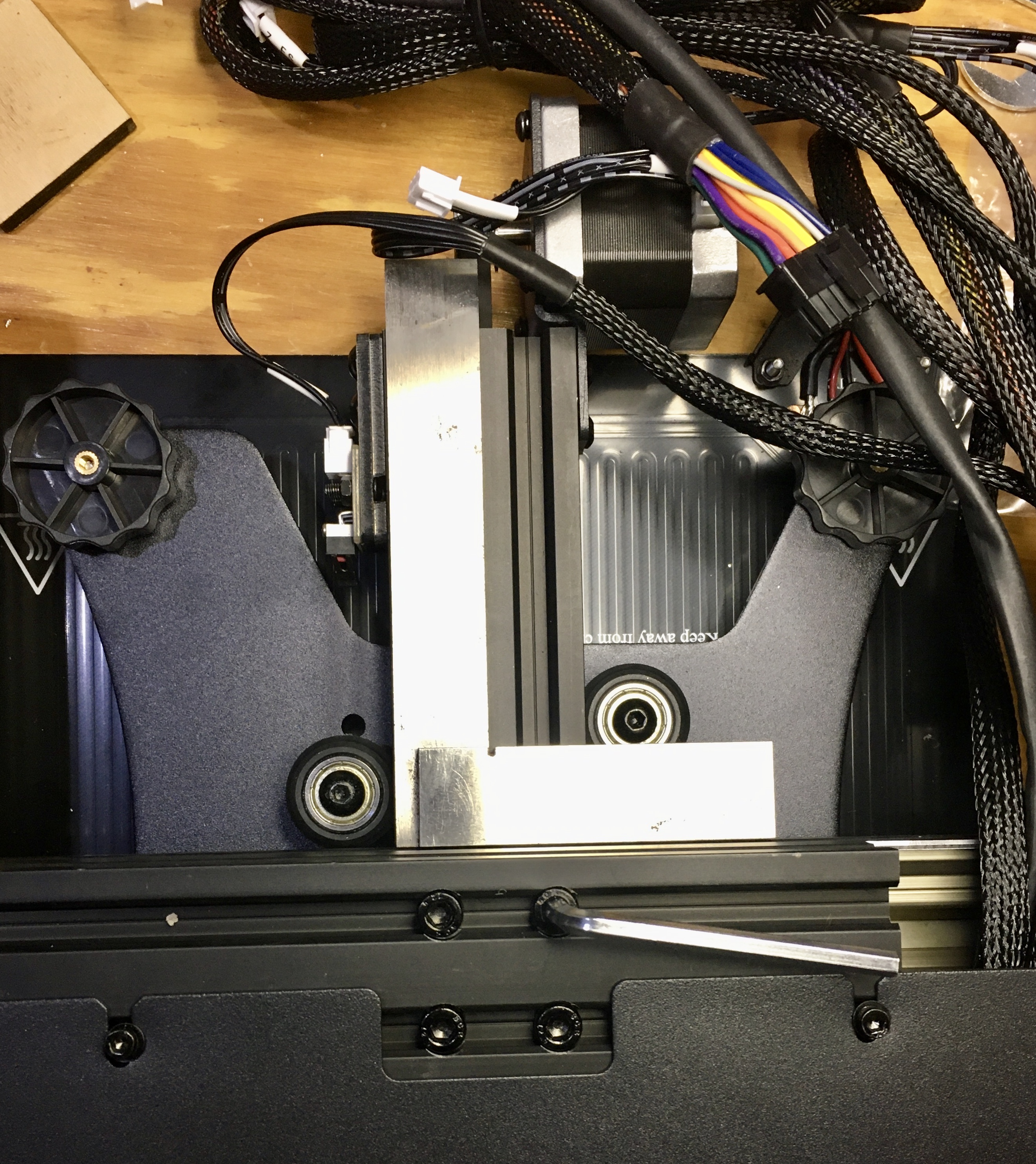

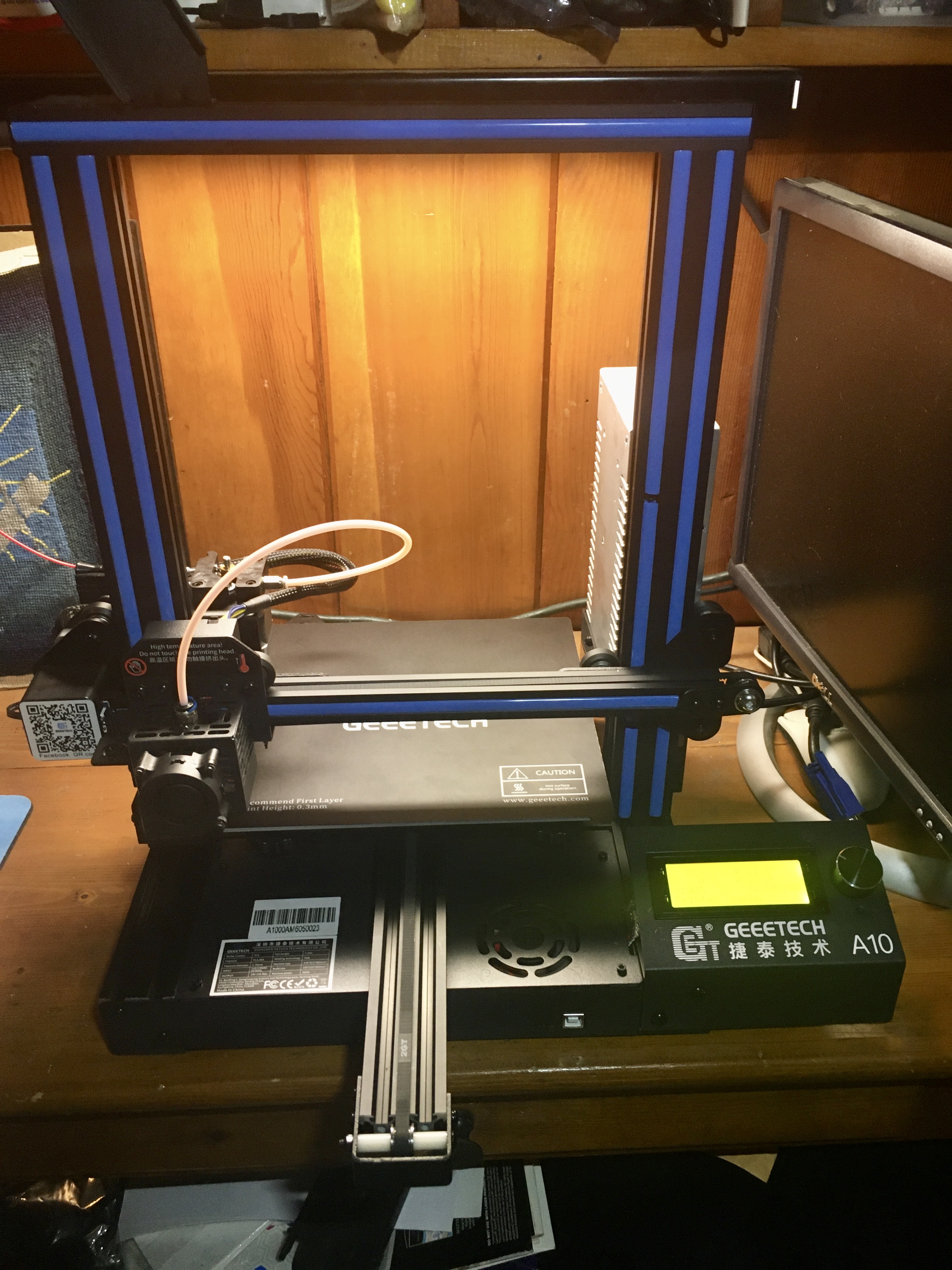

The printer comes partly assembled so setup was fairly easy. I checked make sure the bed rails were perpendicular with a machinist’s square and only had to adjust them a tiny bit.
Checked the wheels and found them a bit too tight and loosened them just a small amount to get a smooth travel with no looseness to the bed.

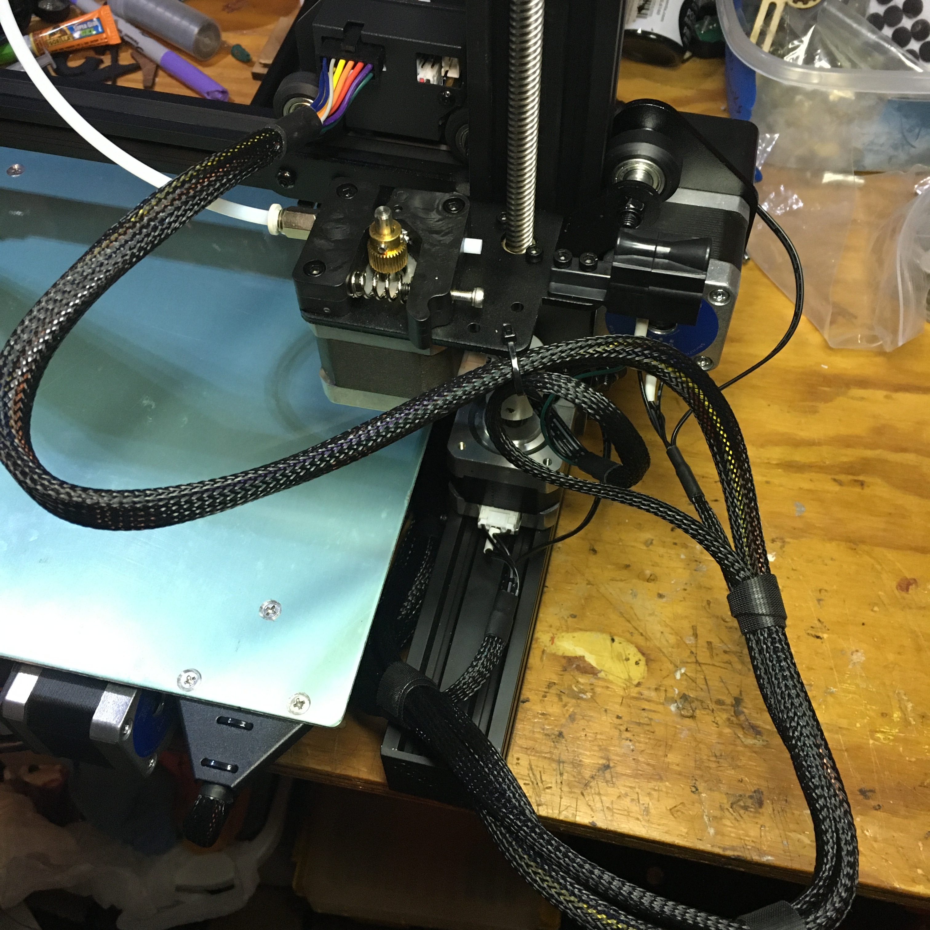

Getting all the wiring arranged so it stayed out of the way was a bit of a challenge but I got it done and used velcro ties instead of the plastic zip ties provided.
All set up :tada:

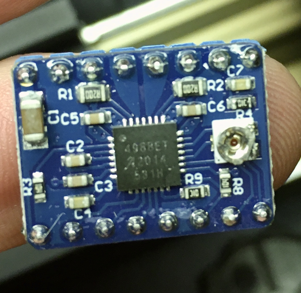

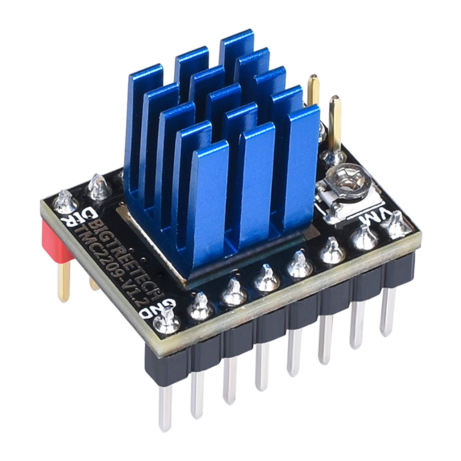

TMC2209 produce less heat than TMC2208 due to lower on-resistance MOSFETs. Especially on step sticks with such limited ability to carry away heat, I’d suggest the 2209s instead. They are only a few $$ more and less likely to cook themselves.
You’ll want to get TMC stepsticks that put the chip on the bottom side of the board and the heat sink on the top, with plenty of vias to carry heat through. You don’t want the heat sink attached to the IC case because that doesn’t conduct heat as well.
Ok, you browbeat, I mean convinced me to get the TMC2209s :wink: They are on the way. Thanks for the advice :slight_smile:
So right after I had the printer setup I really wanted to print something but I hadn’t figured out the whole slicer thing yet. I tried to connect the printer to my computer using Repetier-Host and Repetier Server like Geeetech suggested, but I could not get it to connect. Will play with that later.

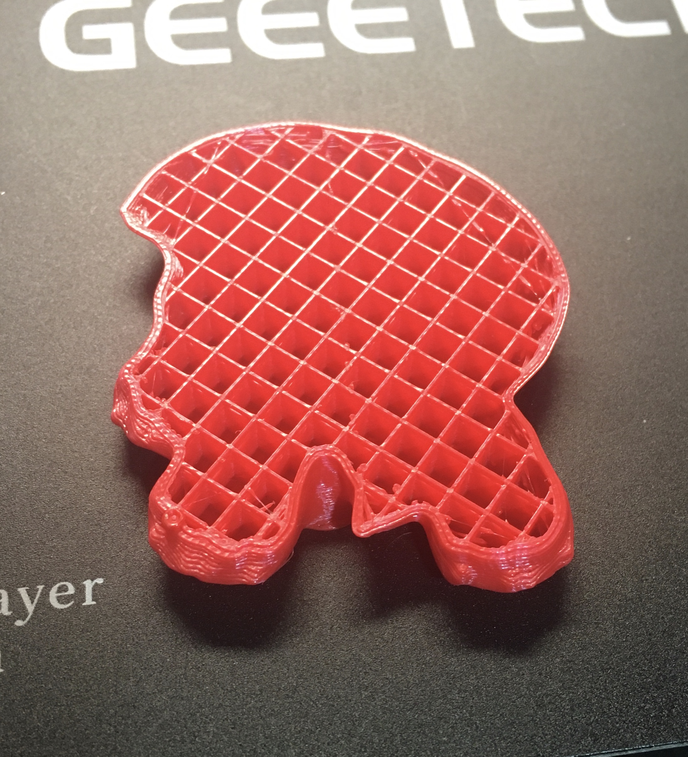

The sd card comes with a print file preloaded which is a dog that Geeetech likes to use as a benchy. So I loaded up the sample filament that came with the printer and started the print from the card. 30 minutes in the print failed :cry: MINTEMP Error.
It was late so I said fuck it and packed it in for the night. Next day I downloaded a calibration cube from thingiverse and generated gcode with PursaSlicer on simple mode with default parameters and loaded to the sdcard (wanted something smaller to test). Started the print and it failed again with the same error at almost exactly the same print level.
Did some digging on the error and it seems that it is because there was a bad thermistor reading. In Marlin, MINTEMP seems to be the hotend thermistor while a MINTEMP BED error would have been the one for the bed.
Couldn’t replicate the error by manually moving the hotend around or wiggling the wires. So I unplugged the cable to the hotend and then replugged it to make sure it was fully seated.
Started the print for the calibration cube again and SUCCESS! :tada: Will have to see if this really fixed the problem or if it’s a bad wire that might show up again later.
Seems to be a pretty reasonable print for just using default values. Definitely some parameter tuning and other adjustments to do. Will probably wait until I get the TMC2209s installed, and load up the filament spool I will be using, before doing any more testing.

Before I switched to hotends with cartridge thermistors, I also had MINTEMP errors when the thermistor was loose in the block. That’s tricky because it needs to be tight enough to be firmly seated, but not so tight that it breaks… It looks like geetech uses bare thermistors. The good news about MINTEMP as an error is that a failing thermistor alone won’t be as likely to start a fire; they didn’t disable the most basic fire protections.
Do consider thermistors, like heater cartridges, to be wear parts. I keep spares around.

So the TMC2209s will arrive tomorrow and I’ve been doing some reading. So the main thing I understand is that I will need to reverse the motor directions either at the board (swapping wires) or through the firmware.
The question I have is about Vref. I understand Vref limits the current the motors can draw. Should I go with the default values on the chips and see if the motors miss steps or should I target something else initially?
@HalfNormal what did you do with your 2208s?
Post the part numbers printed on the stepper motors and we can look up how much current they are rated for. In general you want to run them at or not too much below rated current in order to have accurate microstepping.
Which 2209 stepsticks did you order?
I got these Bigtreetech ones. Will get the stepper part numbers.

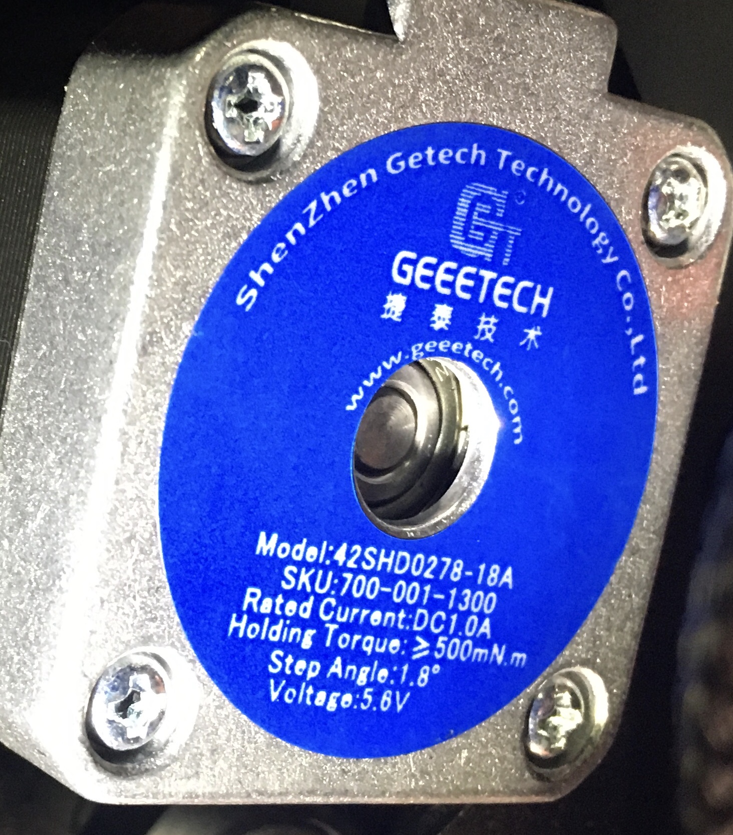

The X and Y motors are 42SHD0278-18A, could not see the one for the Z. Extruder is 42SHD0278-24B1
They say they are rated for 1.0A
There seems to quite a bit of contradictory advice online on how to calc Vref for TMC2209 drivers. I’m not even sure if the 1.0A printed on the steppers is peak or RMS. I can’t find specs for the motors based on the numbers. I guess RMS would be more typical?
@NedMan I’m not at home at the moment but the firmware I flashed lets you pick the type of driver you’re using so that it is calculated in the firmware.
RMS is for AC measurements not DC measurements. The ratings on the motor is one amp DC.
