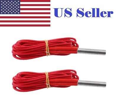

Found this on eBay which indicates US seller.
Oooh, didn’t try searching for “6*30” thank you!
