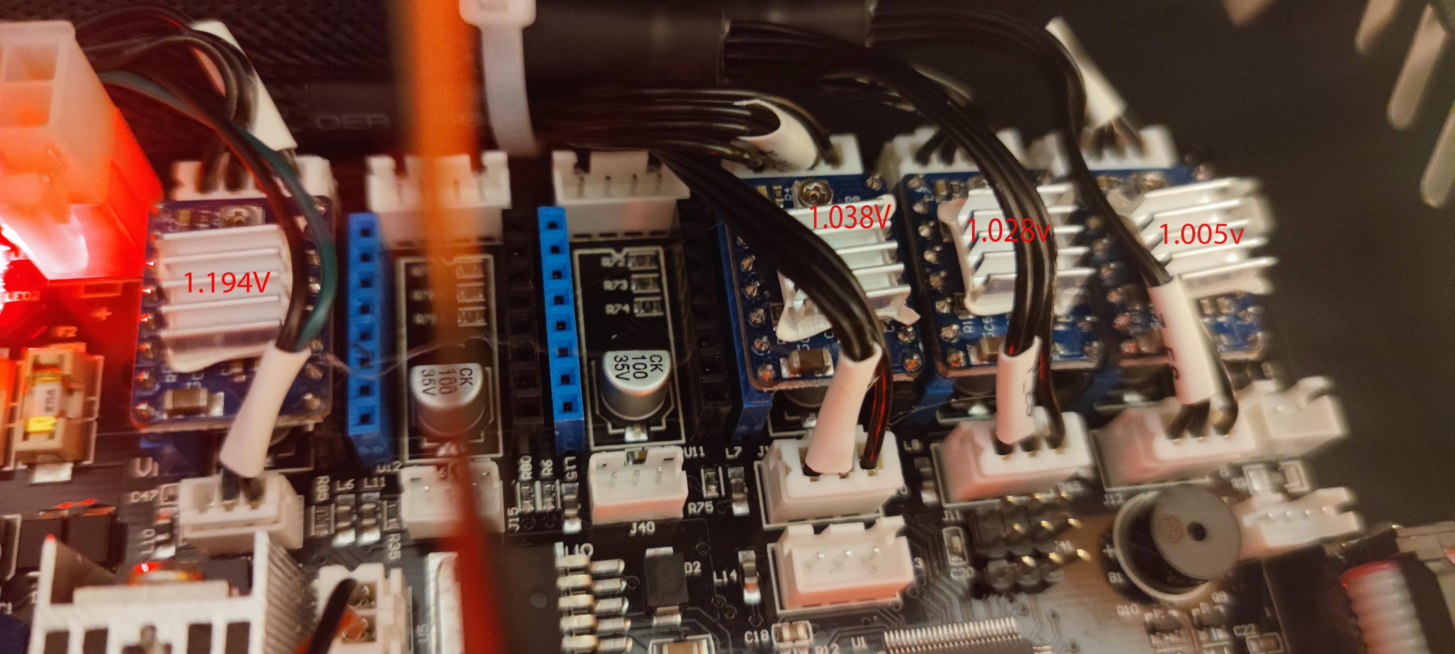

I was told to check the tension on my belts (looks fine to me) and the voltage on the drivers, to make sure they are not overheating and missing steps (from what I understood). I’ve measured this voltages:
So, i have no idea of those are what they should be. Also, if I bought correct tmc2208, don’t really know what voltage I should set on them.

I don’t know how to interpret the first picture, I assume the second picture is a layer shift on X or Y. Did your new driver “step sticks” come with documentation? The voltage you are setting controls current, but that depends on what resistor is being used to sense current… So they should tell you what voltage to set for 1A of current. You can also check to make sure that your stepper motors are (like @NedMan’s) rated at 1A.

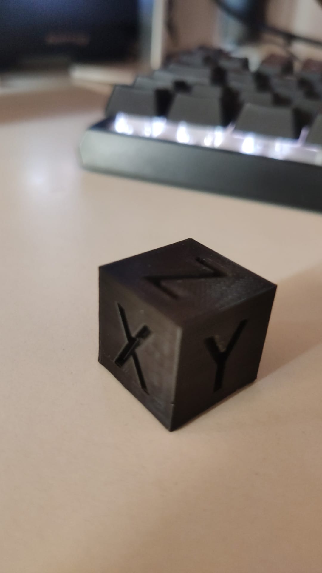

I printed this cube and looks ok to me.
Got me thinking it was just in curves…

An easy check is if the stepper motors are cold to the touch they don’t have enough current, but if they are too hot to touch they may be ruined. Those voltages don’t look like they were set to exact values — given the same motors on each axis I’d expect the voltages to be the same.

If the shifts are a multiple of 2mm then belt tension probably is actually a problem and it probably actually skipped one or more teeth. If they are not, then it skipped steps instead, but 1V reference is unlikely to be such insufficient current that you are skipping steps in normal use without something else really causing it like overextrusion, or excessive acceleration.

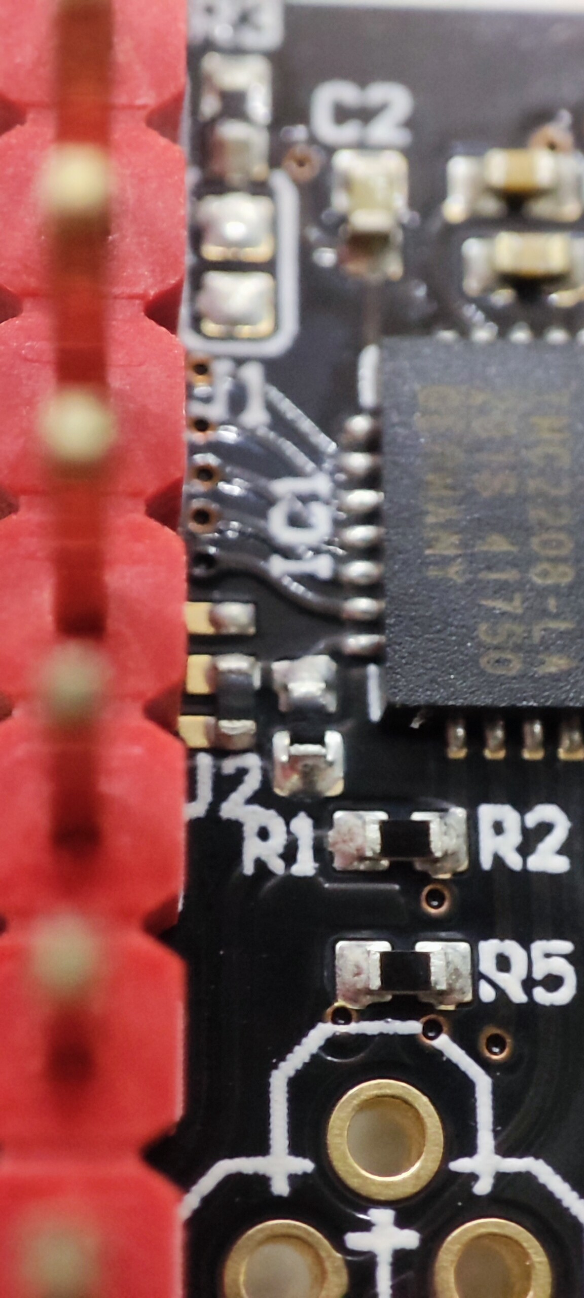

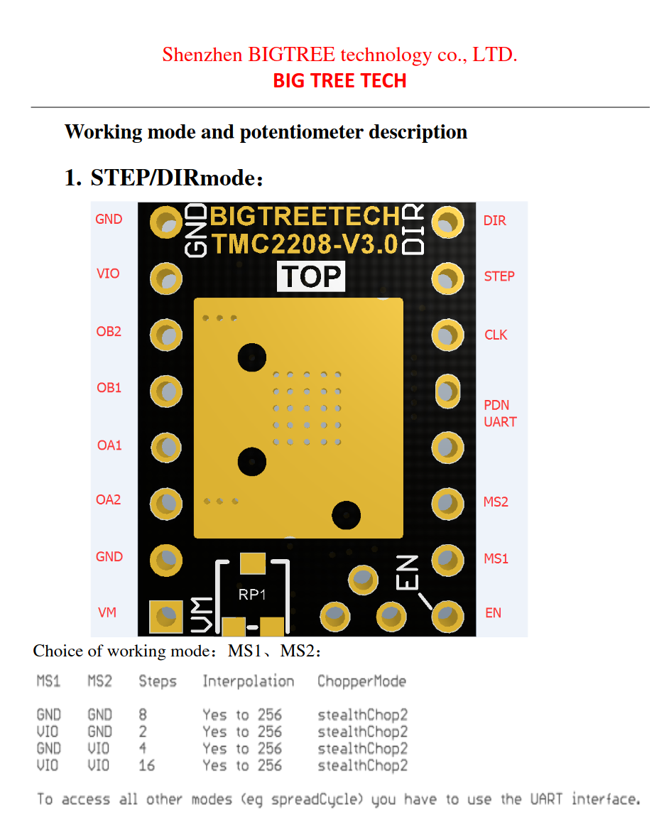

I was just checking the tmc2208 that I bought and I think it was a bad buy. Looks like they are just for using with UART and I think my board does not support it .
But I’m a little lost
Looks like you can still use STEP/DIR/EN if that’s what you have:
That’s my doubt. I see that these have those two pins connected specifically for UART
What could happen if I install them for STEP?
My ideia was just replace them, plug and play. Lol

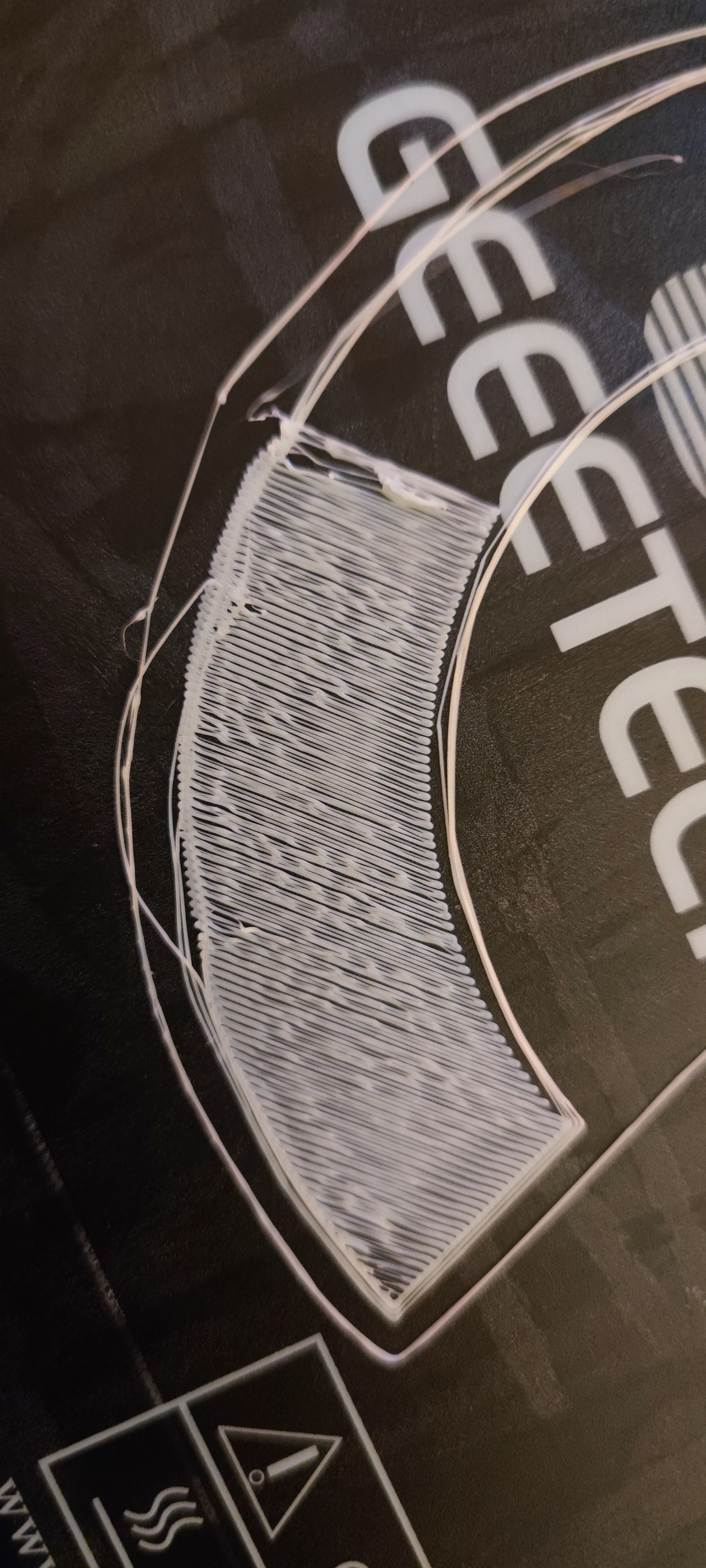

That first picture shows poor bed level/high adjustment and next to no first layer adhesion. I would never continue a print with the first layer looking like that.
About that you’re probably right. I remember I calibrated, but lowered the bed a little more than usual because my prints where getting to much stuck. That’s a trick CHEP talked about in his channel. Also my first layer was not sticking so i had some glue tube around and used it. It sticked but not perfect .
That’s also something I’m learning to tune also. I think my bed if somewhat uneven at the center.
Have to check that. A lot to learn.
yes, besides calibrating the extruder, getting familiar and practice with getting the bed level and calibrated to the hot end. I use a piece of standard white paper and my hotend heated to 185C then calibrate to just dragging on the paper at 4 point and then check the center for standard Cartesian 3D printers.
Yes, they should support both types of signalling, but the things that go beyond what DIR/STEP/EN can do obviously can’t be done over DIR/STEP/EN and so require using the UART. For just drop-in they should still work with DIR/STEP/EN.

So,now i need to make sure are the vrefs that came with the A4988 are correct. That’s where I need help now, so please bear with me.
A reminder of what I measured:
My motors seem to be all the same, the D42HS3420-24B22,
Except for the X (I think that’s the X :frowning: ), a 42shd0278:

I also check the drivers and the say R200:
From my googling the formula should be VREF ​= I​ x 8 x Rsense. And in “I” some say i shoud use less 10%, some 20%, some 30%.
If i go 30% i should get Vref = 0.780.2 = 1.12V. With less 10% i should get 1.44V , which looks too high from what I’ve read.
So, with all this, I need suggestions to set these. Should they all be with the same V?
There’s a fairly wide range of functional values, as is evident from the lack of consistency of advice. They are in a reasonable range right now; so I really don’t think that this is your problem.
