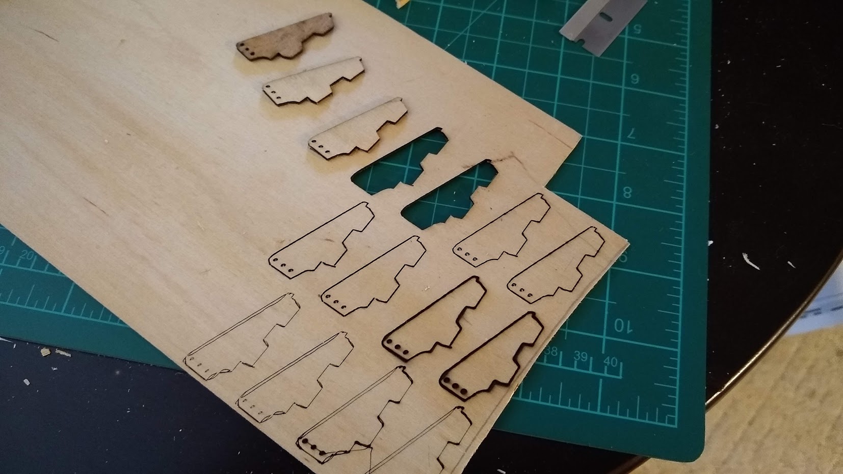

I got it all put together last week and was able to run it yesterday. I figured a few things out (like $32=1 to tell the controller board it’s dragging a laser around so turn it off during moves.) I get really good repeatability when resending the same job twice. But if I try to cut the same diagonals from different directions, that’s not so great. I am seeing way less cutting power than the youtube videos, but the tip I heard was to raise your material as high and as close to the laser as possible, and carefully focus it before each job. I was able to raise the material up a bit and got slightly better (but still not great) cutting power. I was able to get through 1/16" lite ply after about 10 passes … almost. I finished the cut with an xacto knife, but at least now I have the part I need. So next thing is I need to find a better base so I can get my material even closer to the laser. Still have hopes that this will be useful for smallish model airplane making jobs.

Here is a picture of my first cut tests. You can see something worked. I got two parts actually cut out finally. The 3rd slightly darker piece is an original from a kit I purchased (that is what I was trying to duplicate myself.) So let’s say I paid $350 for this laser cutter, it tool a month to be delivered, a week for me to get it together, 2 days to cut my first part. I see that I can order a baggie of 20 of these same parts for $5 and have them shipped the next day. But this is way more fun (I say to myself to justify my own craziness.) :slight_smile:
