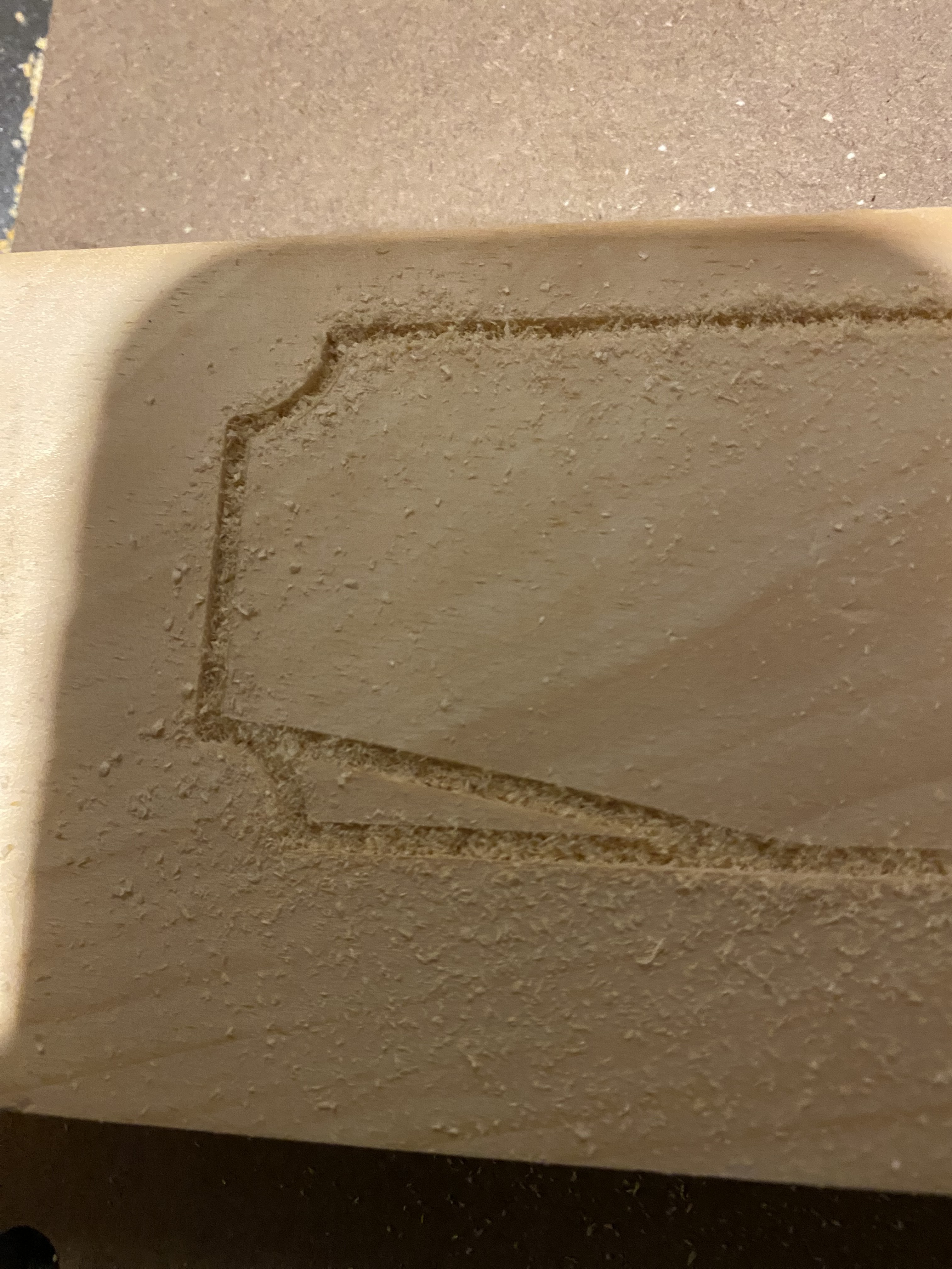

I successfully set up my new 4030 and have made a couple cuts but am now experiencing both hesitation in the spindle as well as stopping and moving in a totally different direction. I have my cnc plugged in to an outlet on a new line that runs directly from my electrical box so as to filter out any potential noise. Any help would be apprecitated.

Ok, gotcha. I did swap out the cable (non ferrite bead) and re-started the cut. At one point early on the spindle stopped in position & hitting the ‘pause’ button released it. It then tracked off course while making a corner
Ok, so I didn’t notice the cable actually does* have the ferrite core. The spindle just stopped a moment ago in one position, kept spinning but this time hitting the pause button in Candle wouldn’t release it, had to stop the job.
