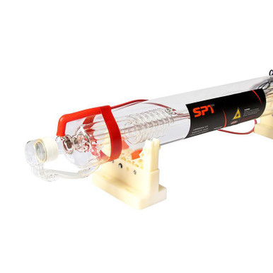

Lightobject lists a more generous 18~24’C for their SPT 40W tube and their 35W K40 replacement tubes:
https://www.lightobject.com/Laser-Tubes/SPT-35W-CO2-Sealed-Laser-Tube-for-Small-K40-Laser-Engraving-Machine
