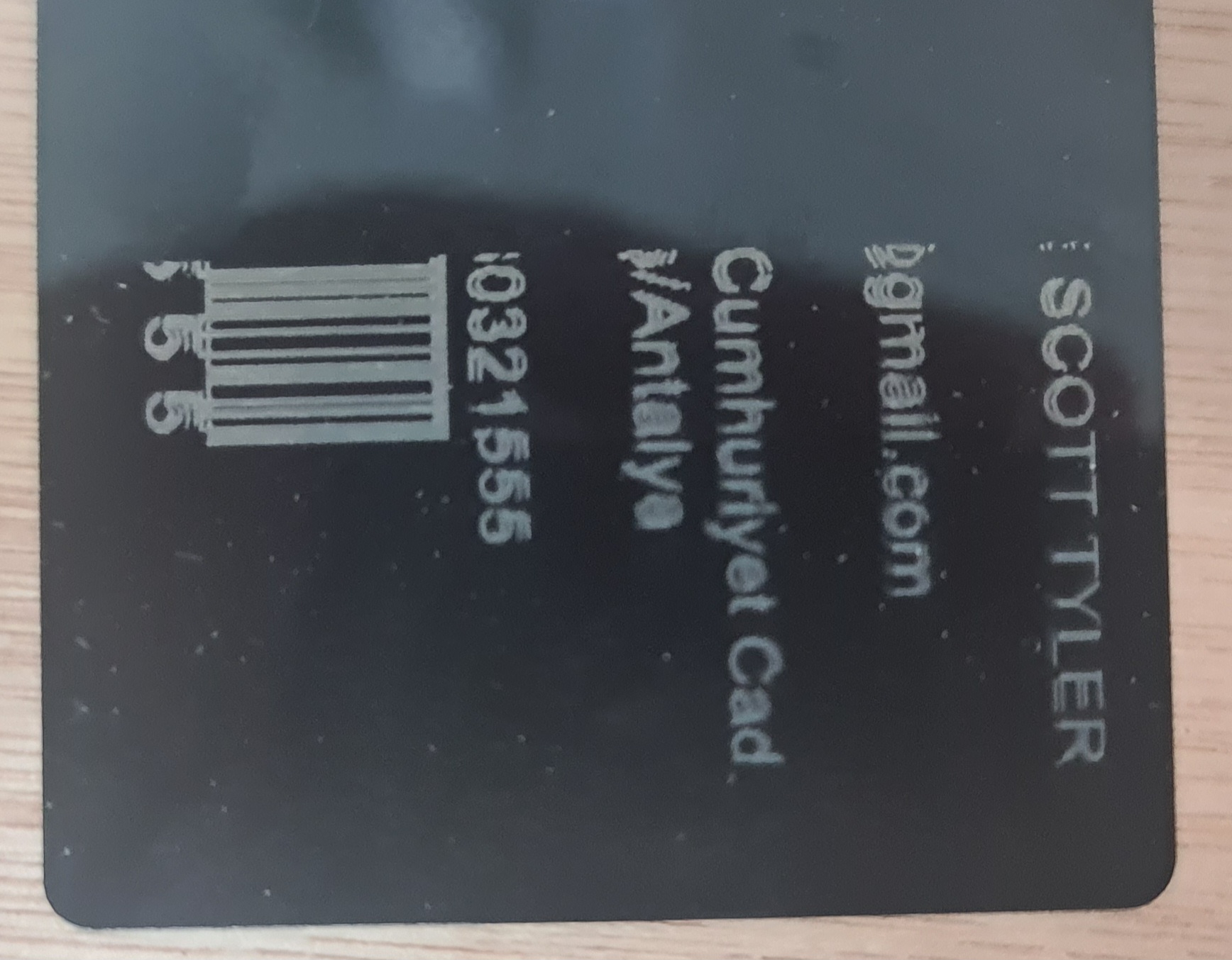

Hi, I am using a Sculpfun S10 to engrave plastic coated aluminium business cards with LaserWeb4. When using the raster feature I get strange ghosting (attached image) in the direction that the scan travels (horizontal in this image).
I ran a testcard (also attached) and picked the settings from that (ignore the bottom right… I scratched it with my nail to see if the residue came off easily). It did strike me as odd that high power/slow was less effective than low power/mid speed, but I went with it anyway as I know the test card is good (running the same gcode on other materials results as expected).

This has been typical of a mechanical problem. If the head can wobble at all, this can happen. And I think others have sometimes thought that they didn’t have that problem, but then discovered that they really did. :grin: So I’d suggest looking carefully for any looseness.

I concur with @mcdanlj ; This looks like slop in the axis.
  • If it were a Gcode issue you would see it in the LW preview.
  • It’s not due to missed steps since the error does not ‘accumulate’ over the course of the raster.
The thing I would check first is the gear that drives the Belt for the affected axis:
  • Check that the Grub Screws holding it to the Motor shaft are secure.
  • This looks very like the effect you get if the grub screw is not properly gripping the flat on the stepper motor shaft!
Also check belt tension, and check the carriage wheels are correctly engaging the rails and cannot ‘rock’ as the direction changes.

Hi all,
Thanks for the advice everyone. @mcdanlj helped me focus on looking into mechanical problems and it turns out it was a (hidden) loose screw on the X axis. It was a screw that secured the belt to the carriage. A tiny amount of slop in it was manifesting as backlash in the engraving. Taking the Laser module off, tightening the screw and replacing the module sorted it!
