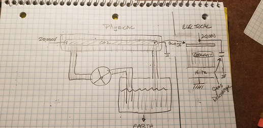

Putting repurposed pieces together for a glycol coolant system using the antifreeze from old rear projection tv optics. Considering a cold water therapy system pump as it matches up with hoses I have acquired from my daughters recent hospital stays and the leg compression devices they throw out.
Anyone see any issues with this schema?
It is best not to use any additives in your coolant. Most additives will lower the conductivity of the coolant and that creates long term problems with the HV systems in the K40.
I do not know the conductivity characteristics of the glycol from your TV optics, you could of course measure it.

So why does the conductivity of a coolant material have anything to do with the HIgh Voltage system? I thought that cooling the system was all about thermal conductivity not electrical. Or did I get something wrong here?
And if glycol is considered a “better” coolant material then I assume that means it has a better aabilify to absorb heat and dispel heat?
Here is some background.
Our belief is that there is leakage through the capacitance of coolant if it is to conductive and that robs the supply of power and stresses it.
At 20,000v and a supply designed to run at max of 30ma its not a far stretch to see the possibilities.

My working theory:
On the other hand you have 20,000 volts across surface of glass (laser tube) on the other side of which is an area of coolant whose other surface is connected to air (another capacitor)
The tubes surface is large and the coolant itself has substantial surface that is connected to air. I would expect the flow of current to be higher if that water was more of a conductor than a dielectric. i.e. a more leaky capacitor.
The area represented by the surface of the water jacket is substantial, the voltage is substantial so its not hard to imagine a small change in the dielectric could increase the current beyond the supply’s design capacity which is in the range of 32ma.
Also consider that the voltage applied to the tube of water is a large spike of 20,000 volts with low current until the gas ionizes at which time there is massive current and a huge drop in voltage. So there is a period of time, albeit short, that this capacitor has large voltage across it.
All theory so far, as there is no real empirical proof this is the circuit mechanism.
