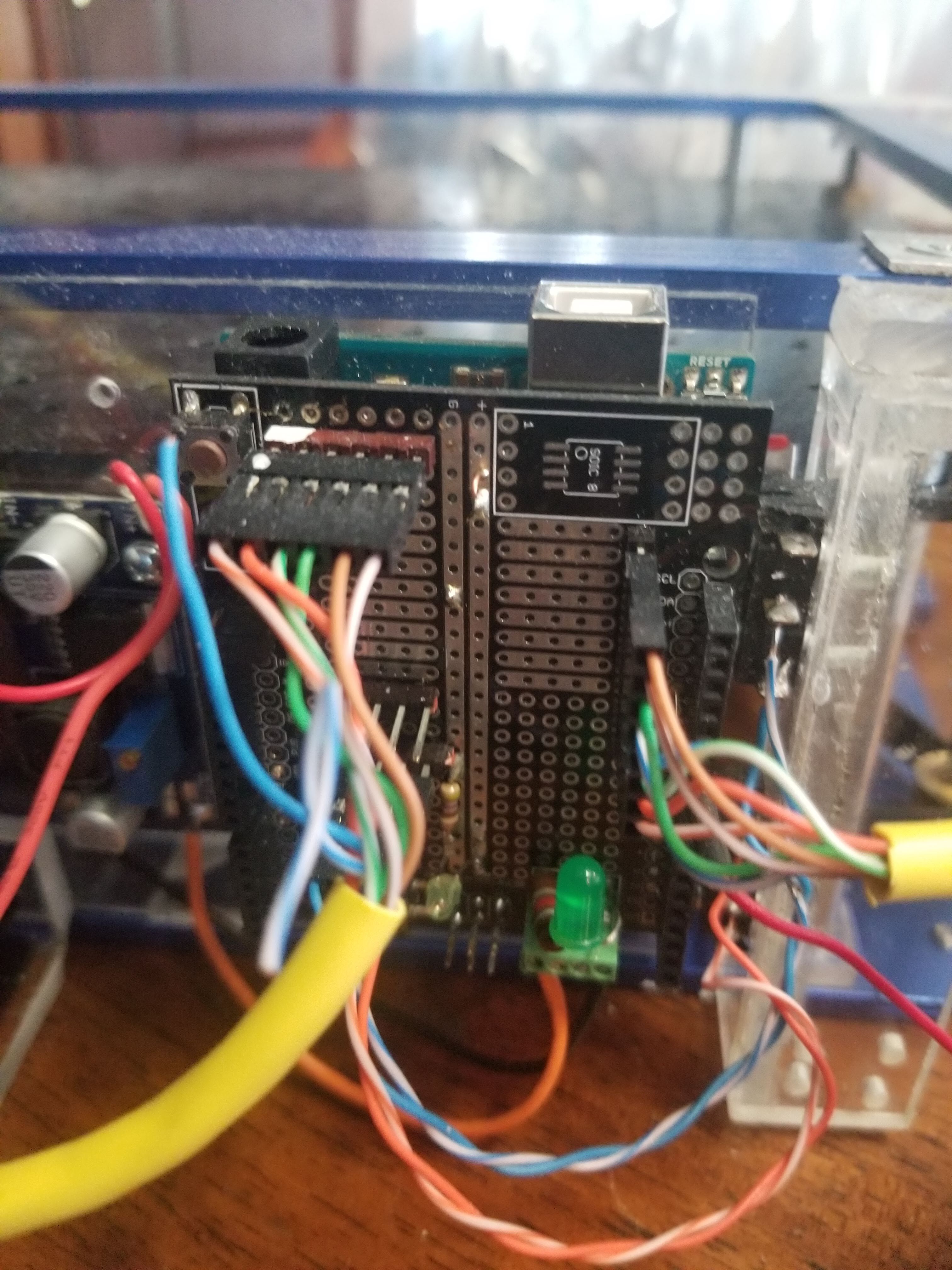

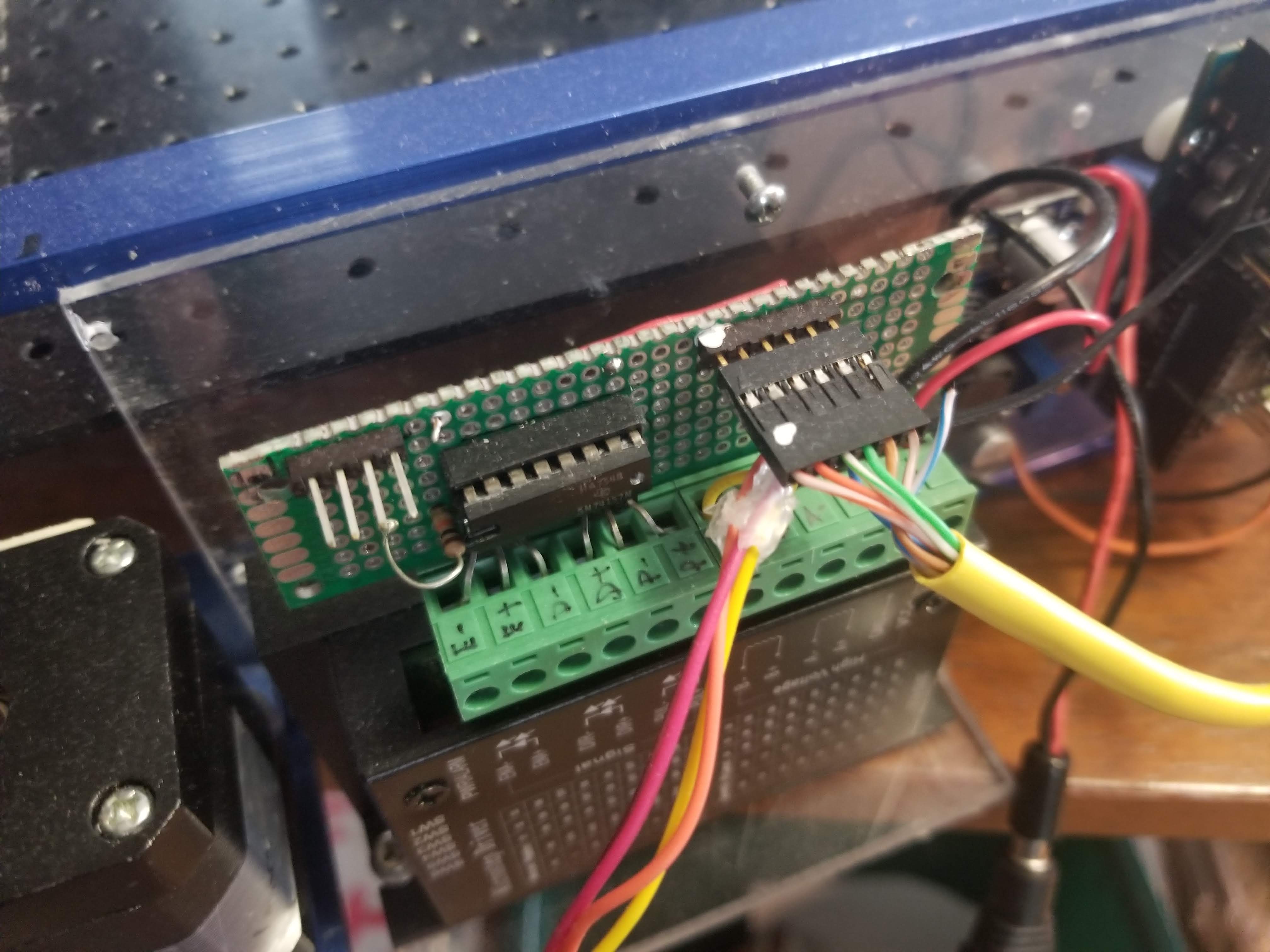

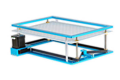

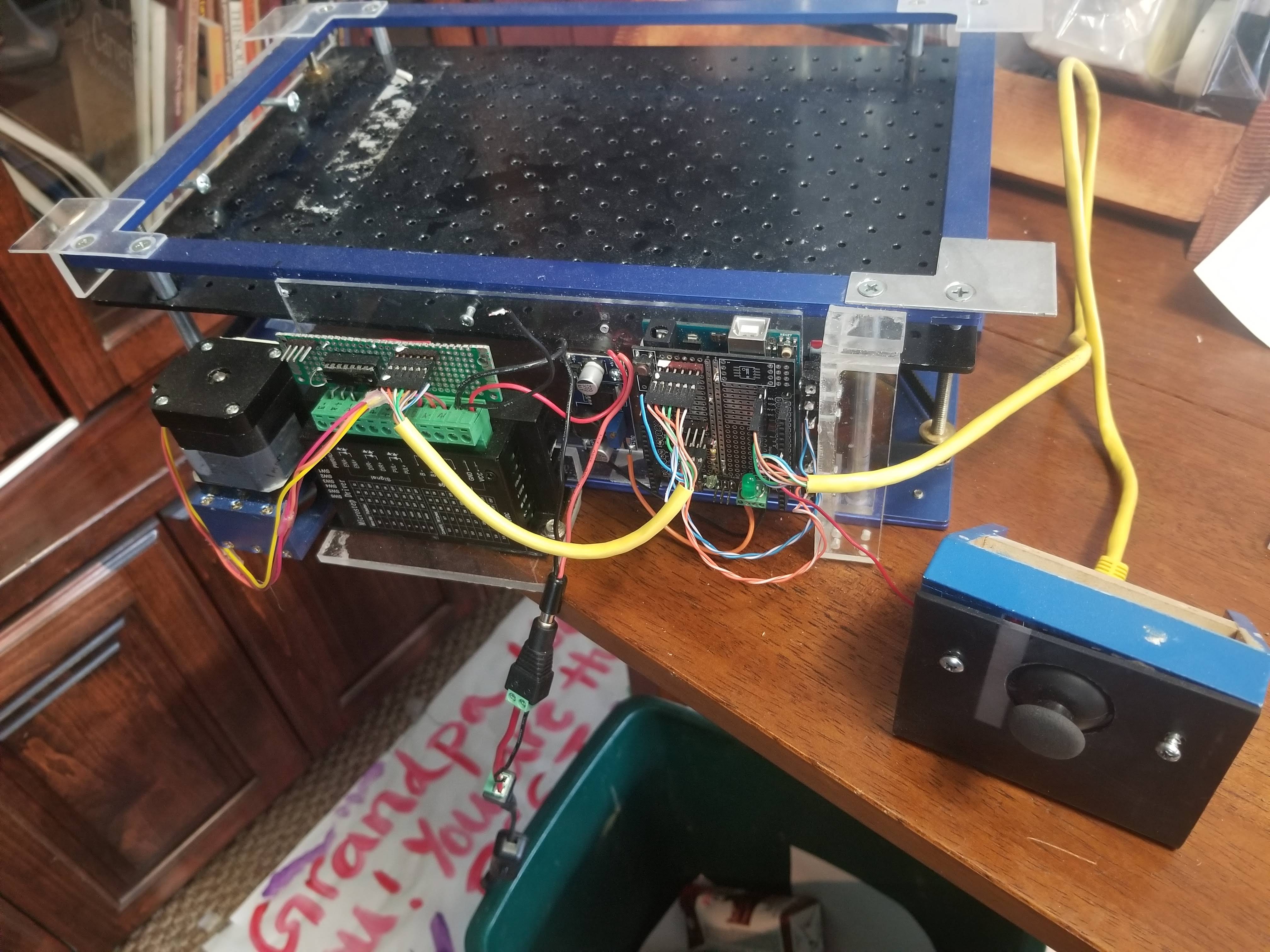

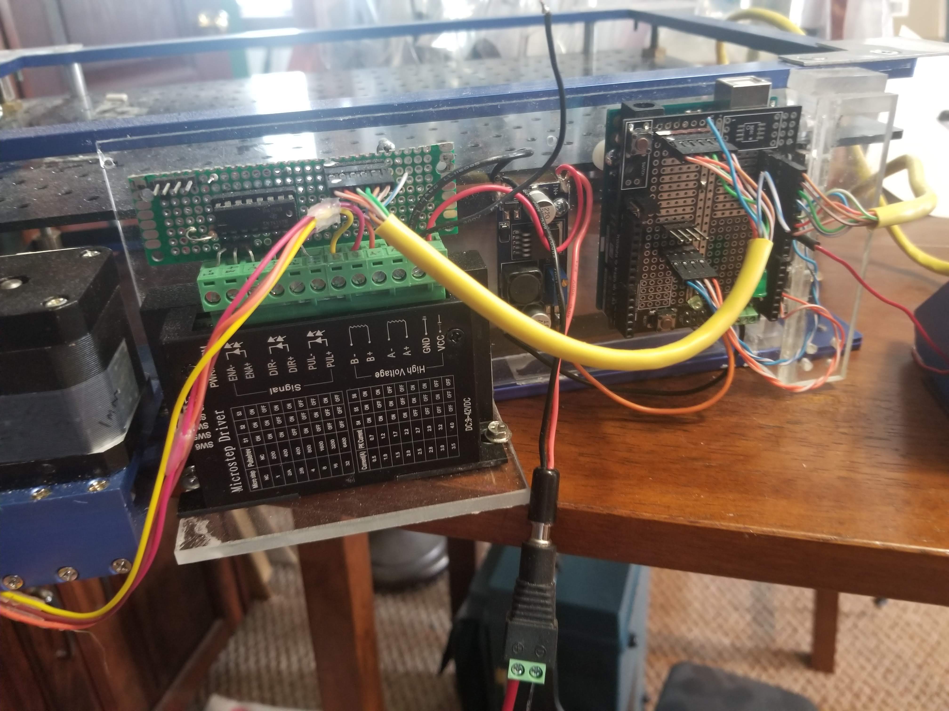

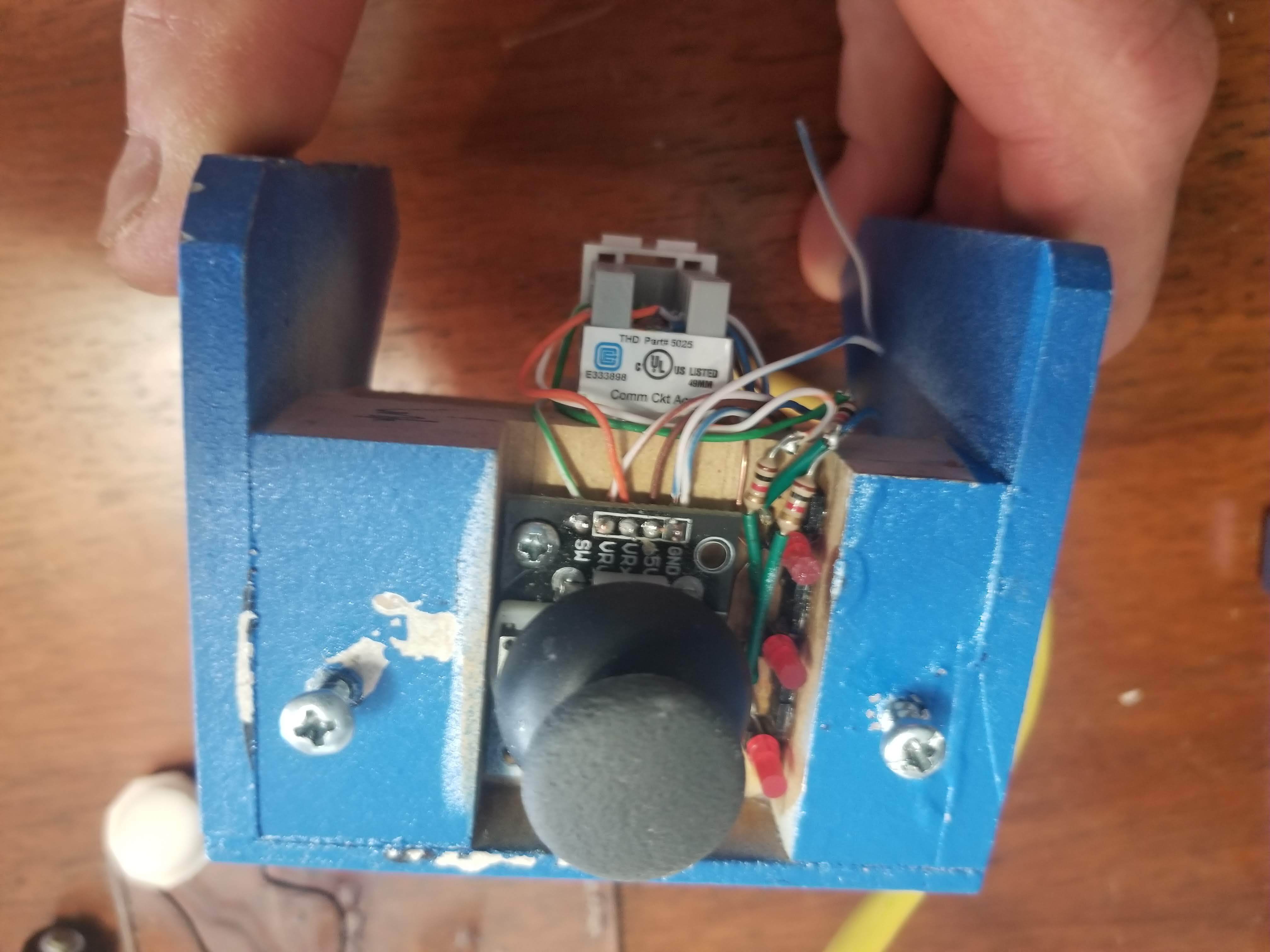

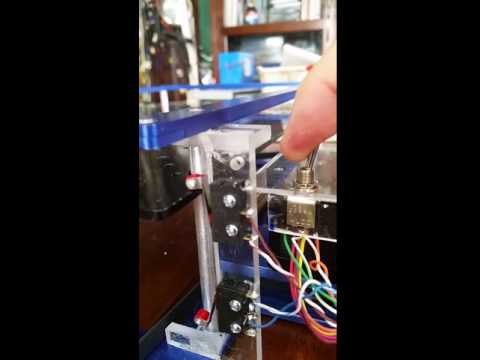

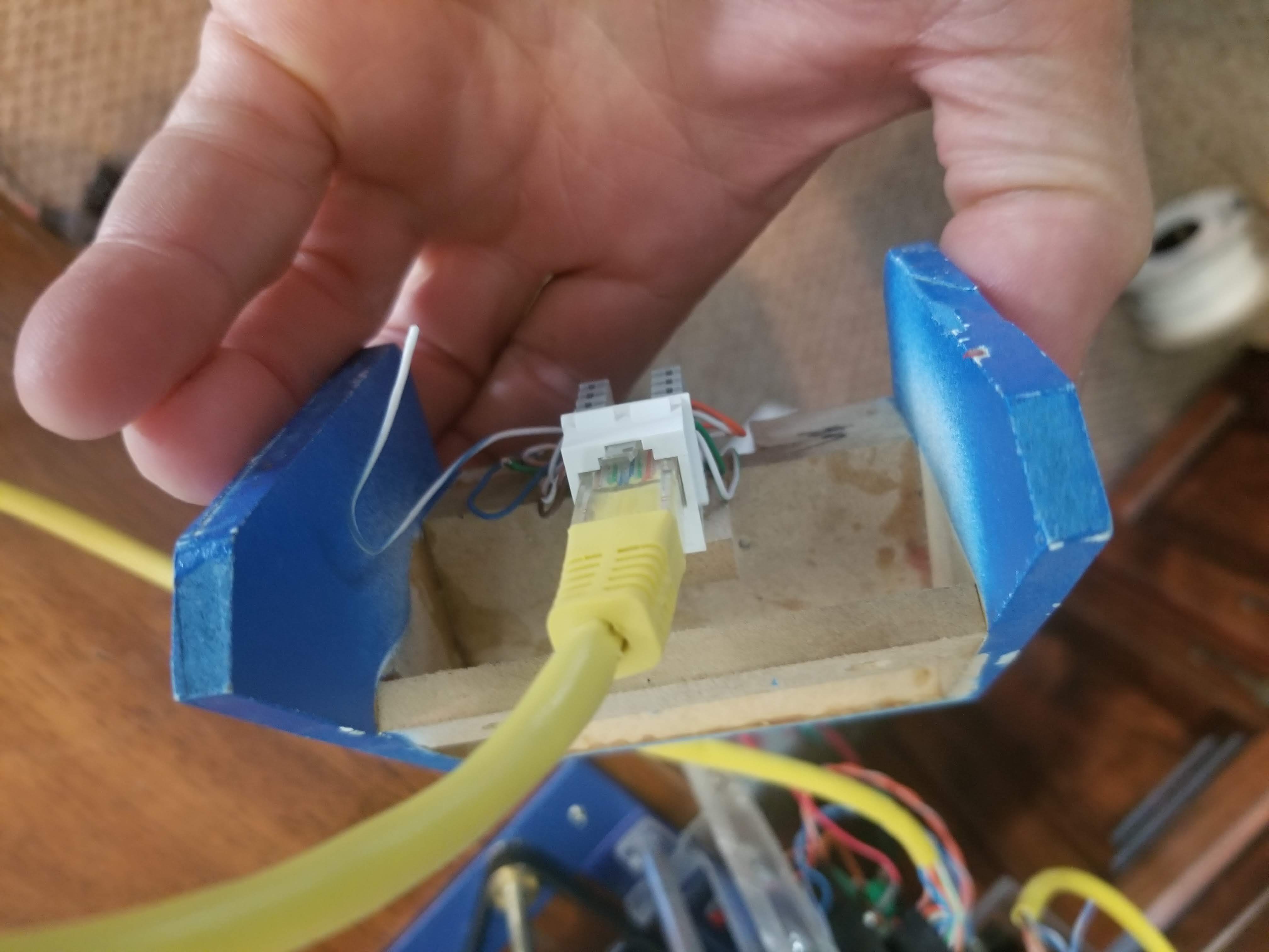

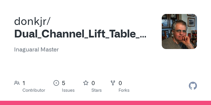

I have not tried it yet but this functionality motivated me to build a new controller for the Lightobjects lift table.
The previous controller (ECN) uses a controller from Lightobjects and up-down buttons which I never liked anyway.
I am running a smoothie 5 with Smoothieware driven by Lightburn so this combination should work out great for me.
THIS IS STILL A PROTOTYPE
I have been working on this intermittently and not published my work to date so here is some proto information. Warning! Testing is not complete especially on the Lightburn side of the mux.
The goals:

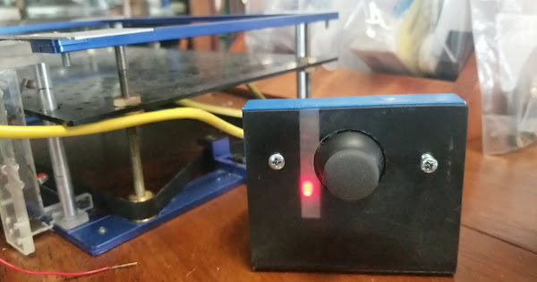

  • I did not want to convert my lift table to purely software control so I designed a schema that would allow manual control with a Joystick, auto control with Lightburn
  • I also wanted to be able to select multiple speeds during manual control
Design approach:
  • An Arduino and its firmware:
    **Displays status on panel leds
    **Controls a standard stepper driver
    **Processes input from a joystick for up-down and seek end-stop functions
    **Controls the state of the input multiplexor
    **A joystick function to automatically seek top or bottom [left/right]
    **Run diagnostics
  • A joystick as the manual input
  • Center switch on joystick changes speed [low/med/high]

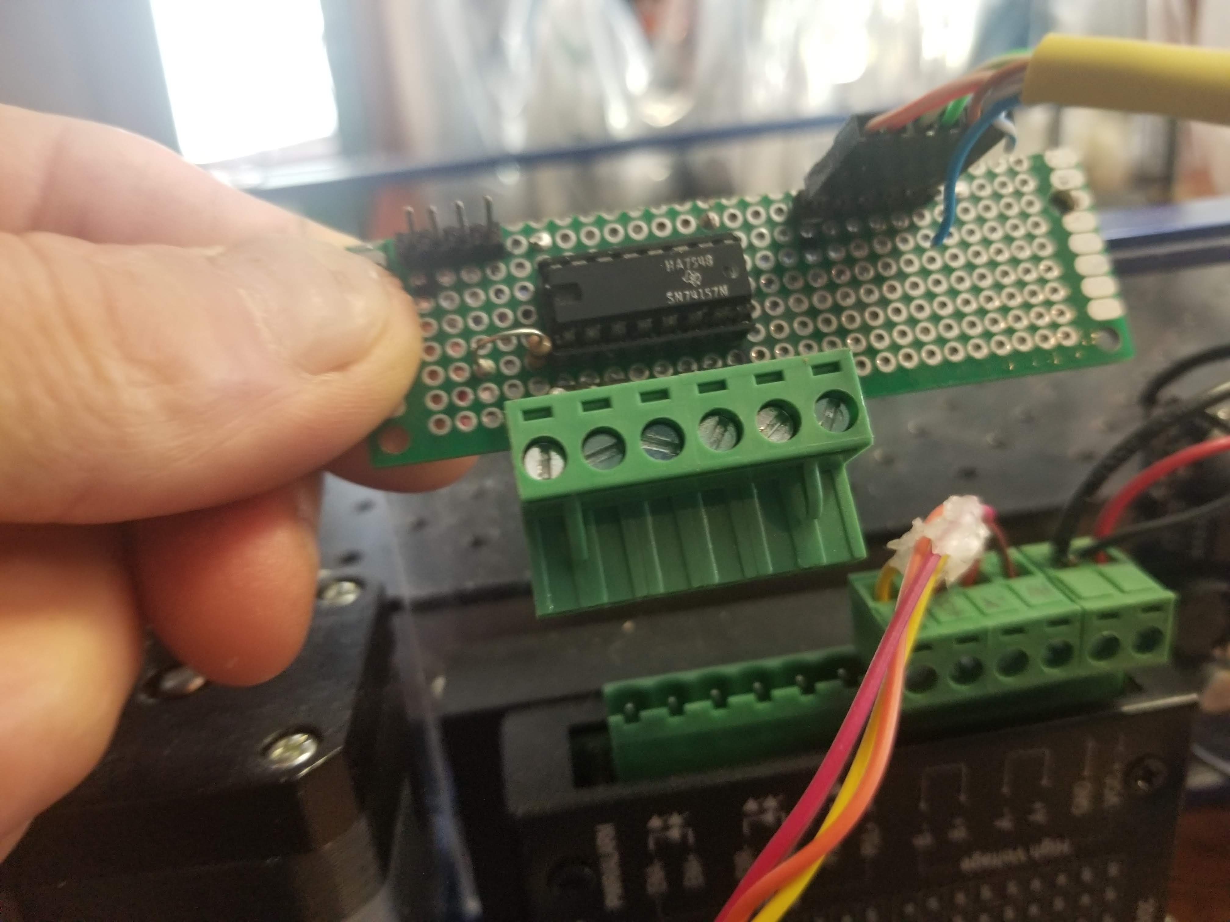

  • A multiplexor selects (programmatically) Z stepper control from the smoothie or the joystick.
  • Lightburn control comes from z axis on smoothie
  • 24vdc power input
  • Modular packaging.
    ** All electronics are mounted on the lift unit
    ** Lift unit and its control can run standalone outside of the machine using the joystick
    ** Modular Joystick mounting on the front of the machine
Status of testing:
  • Code tested in all manual modes
  • Diagnostics tested
  • Multiplexor
  • Connection to smoothie and Lightburn
Unimplemented improvements [especially if others want one]:
  • PCB for multiplexor board
  • Use of smaller Arduino processor and board (nano + nano screw shield)
  • 3D printed joystick enclosure
Design resources:
Schematic:
note: this schematic contains both the new and old (ECN), controller
Firmware:
The entire proto out of machine:
The Joystick fab:
The controller and drive:
The Arduino & sheild:
The driver interface with multiplexor board
