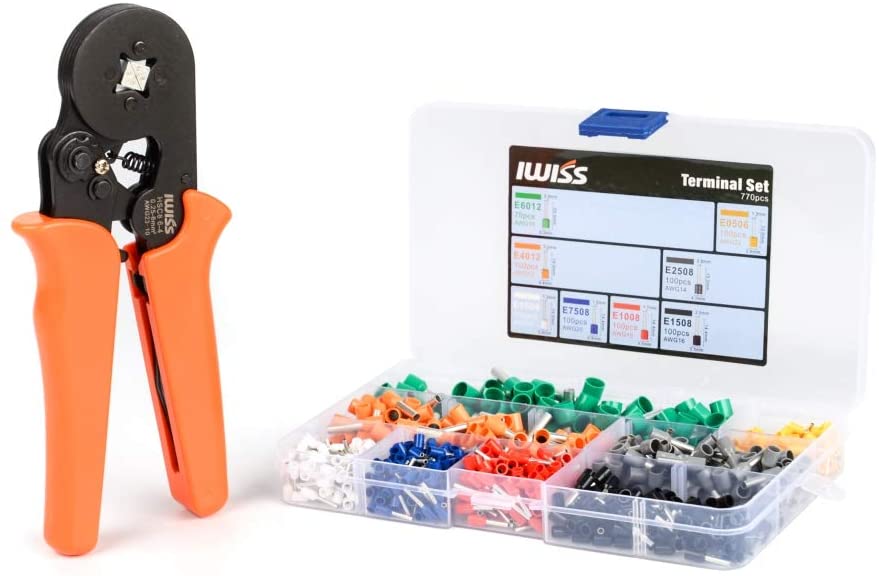

It doesn’t have to include soldering. Usually you don’t want to solder cables to pin header connectors anyway; crimping is better. Additionally, if you are using external drivers, many of them have screw connectors and you can daisy-chain them. If you are using screw connectors, you want to protect the wires with “bootlace ferrules” to protect the delicate wire strands from being cut by the screws. I bought this:
