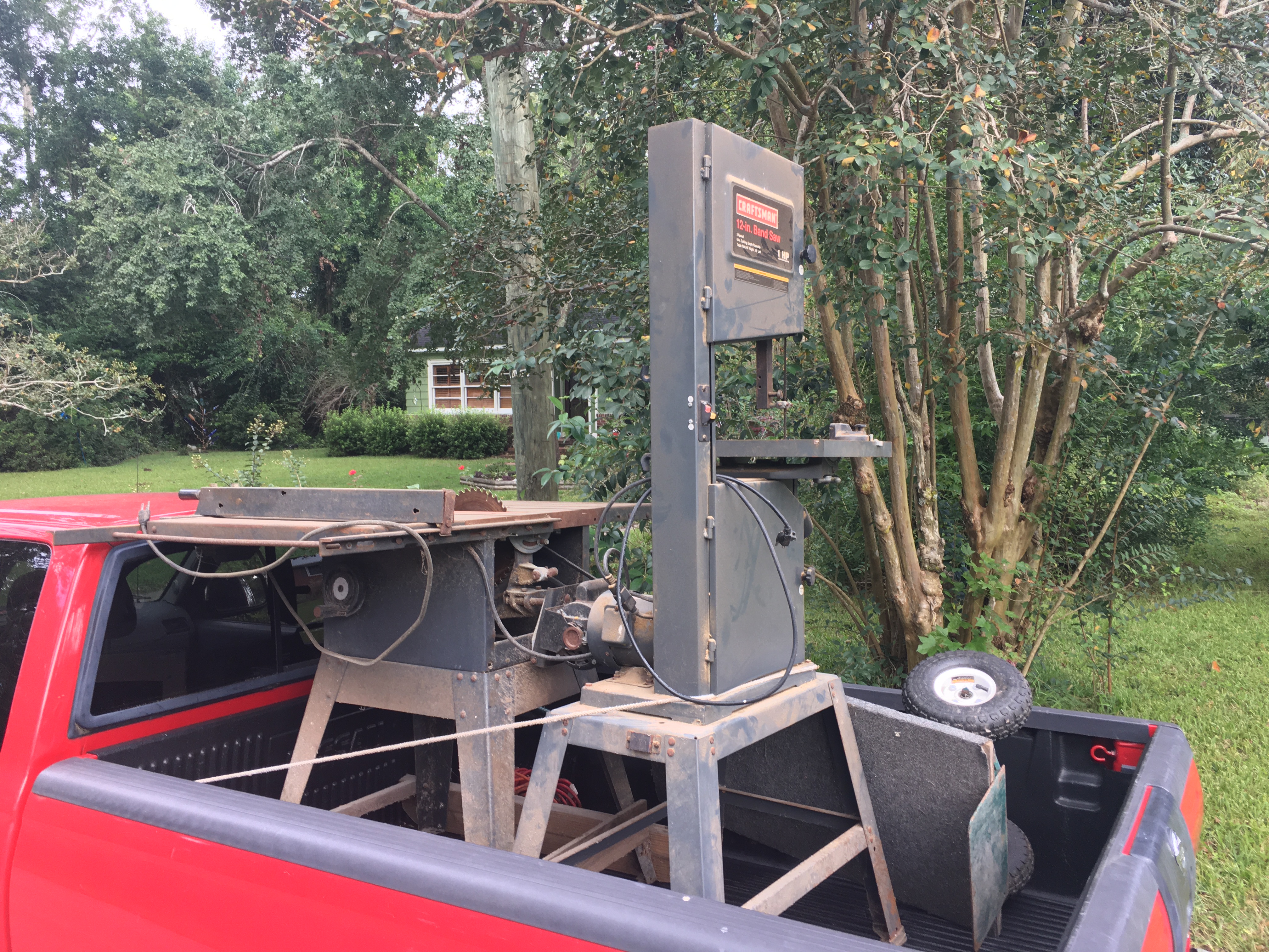

Went to the grocery store for something and got a notification from craigslist on my phone that someone had a table saw they wanted to give away. I was first to respond, but I had to come get it right away. Fortunately I was in my truck and it was like a mile away. Got there and it was a vintage (80s) 10" craftsman table saw that runs.
After we loaded it up the gentleman asked if I would be interested in his 12" craftsman bandsaw. After looking at it, and made sure if worked fine, I reluctantly asked him how much he wanted for it. I’ve been wanting a bigger band saw but I’m also thinking, “where and hell would I put this”. Half hoping it was going to be too expensive, he said $50… Damn, I was getting the bandsaw :upside_down_face: . Only had $40 in cash in my wallet but he said that’s fine. :astonished:

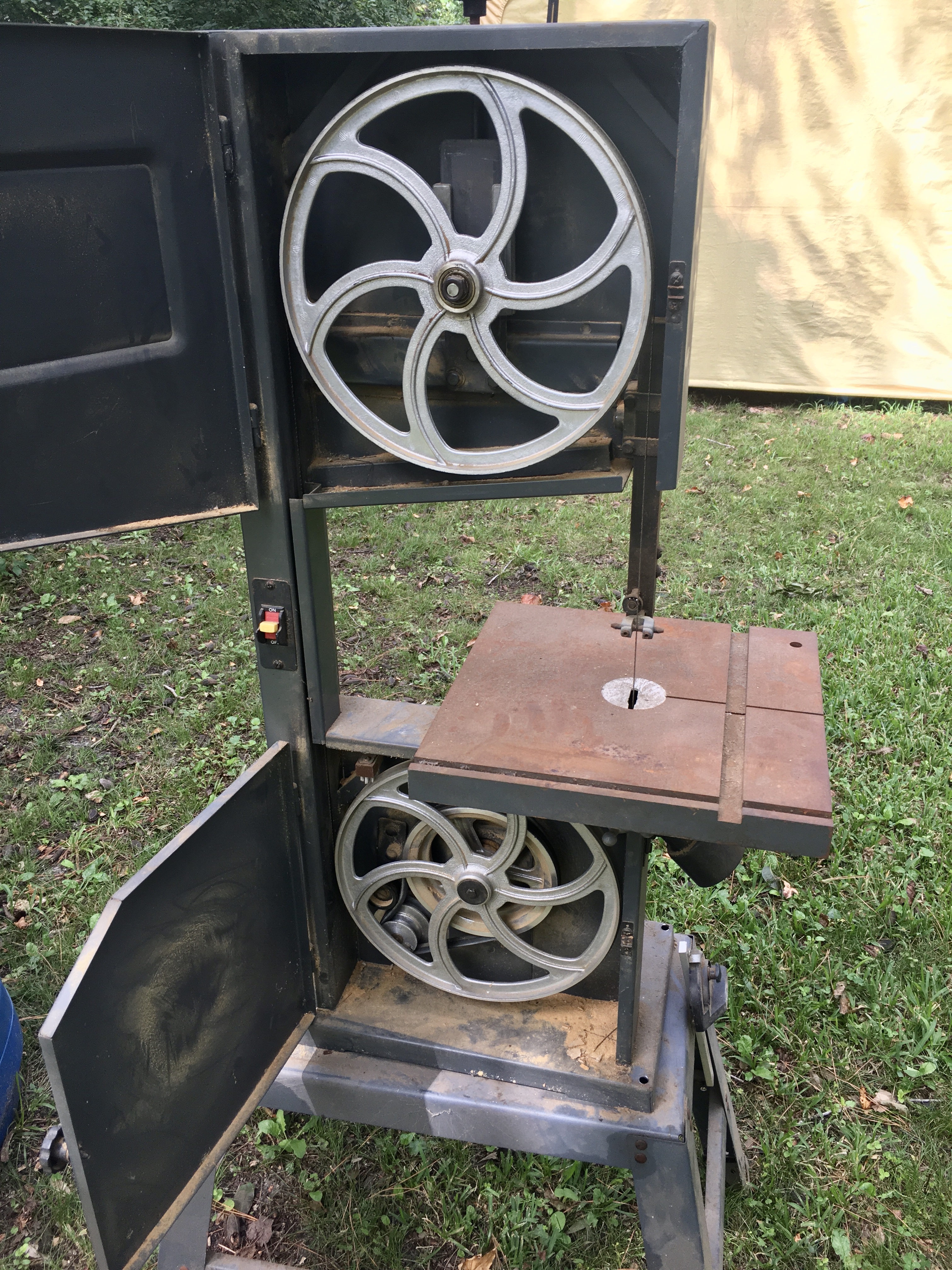

Didn’t have much time today to spend on doing anything with these, but I couldn’t resist cleaning up the table on the bandsaw. A wire cup brush on the angle grinder made short work of the rust. Applied a coating of paste wax to seal the surface.
The bandsaw did have a squeal when it was started up in the guy’s shop, but then ran fine. He said he hadn’t used it in years. On closer inspection at home it appears I’m probably going to have to replace one or both of the bottom bearings. Not a huge deal considering what I paid for it.

Well I pulled the lower wheel and shaft on the bandsaw. After feeling each bearing individually they seemed fine. After cleaning everything up and putting it back together the initial roughness I was feeling turning the wheel was gone. :man_shrugging:

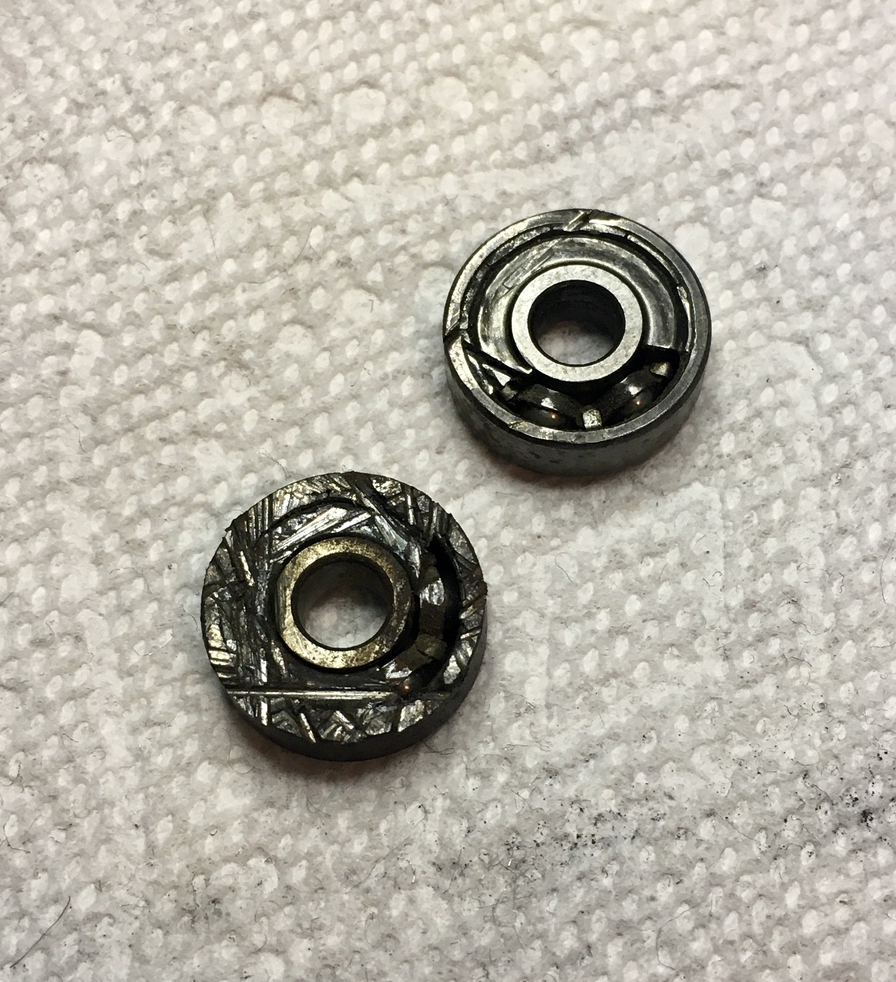

Did need to replace the blade thrust bearings though because DAMN. :grimacing:
