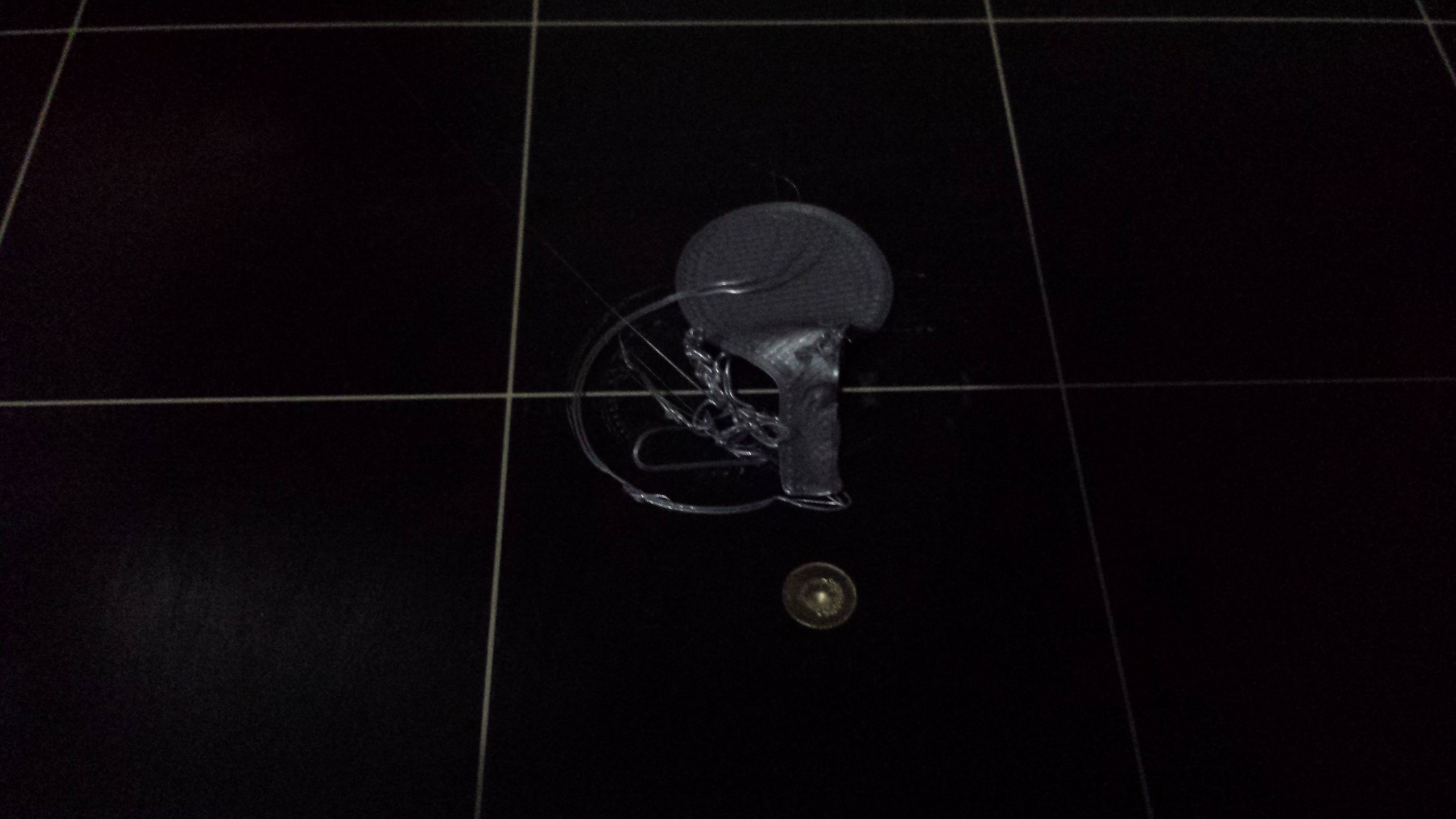

Guys my print bed issues are getting worse. Salt water didnt help any.
Guys my print bed issues are getting worse. Salt water didnt help any. When it first draws the outline it doesnt stick it just drags along with it then lays it on the actual print and then it rips off the print after the 3rd layer

First layer of a spinner
It looks a little squishy to me
I think it looks like your first layer is a bit too high. But I dunno, hard to tell from the pictures and I’m still a newbie, too… too high first layer does cause prints not too stick well, though, so maybe lower it a little?
