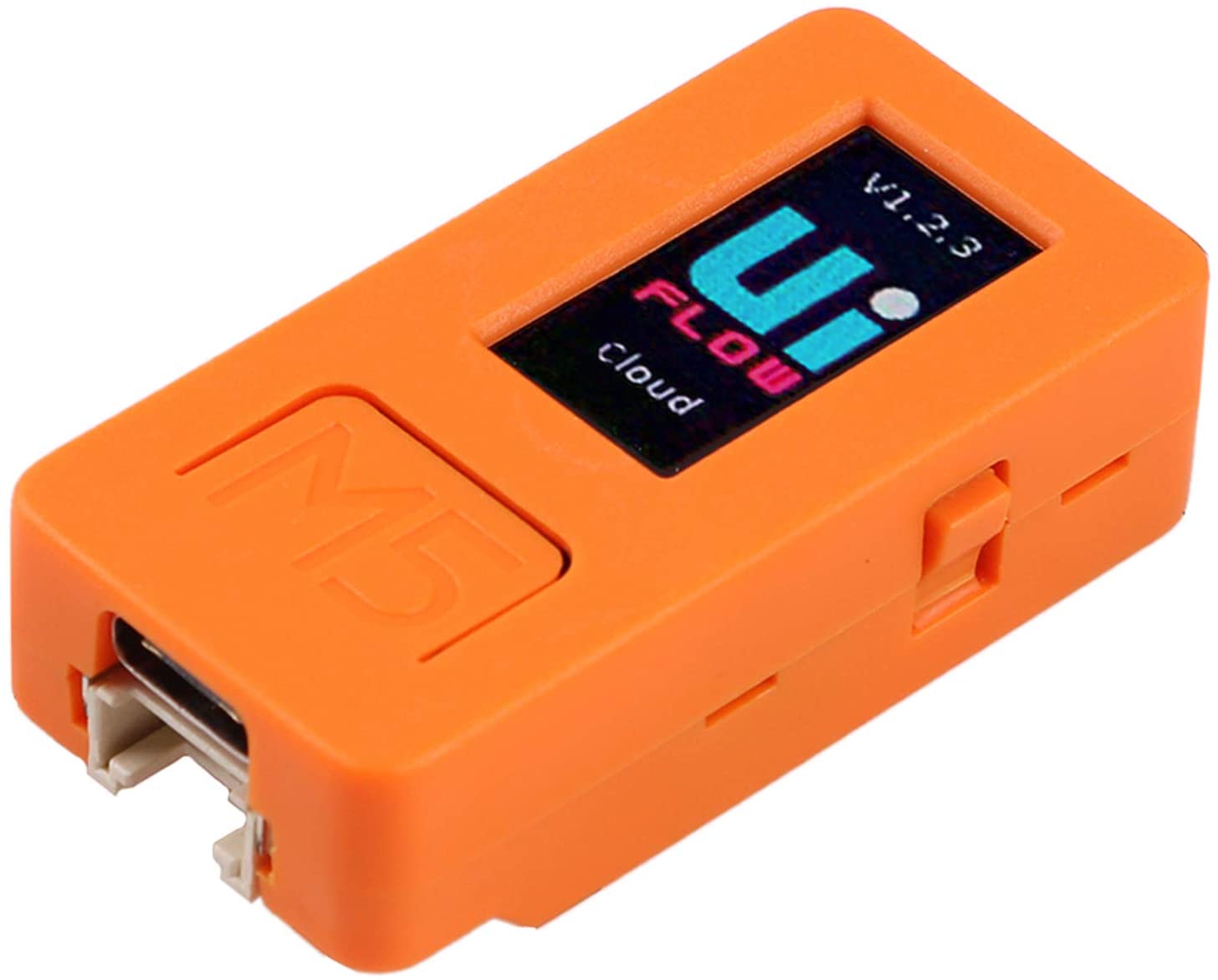

I supposed that is probably still too large? It’s the smallest integrated package I know of with rechargeable battery and accelerometer in one package. It has bluetooth and wifi and could send message to your phone.
The MPU I used in Time Turner: Time Tracking Tool in a dodecahedron - #4 by mcdanlj they haven’t released information on how to use the interrupt function, which would be exactly what you would want in this application.
Now I have to get one to play with! I know Don needs one too!
I DO NOT NEED THESE!, I DO NOT NEED THESE!,I DO NOT NEED THESE!,I DO NOT NEED THESE!..
https://docs.m5stack.com/#/
https://docs.m5stack.com/#/en/uiflow/uiflow_home_page
