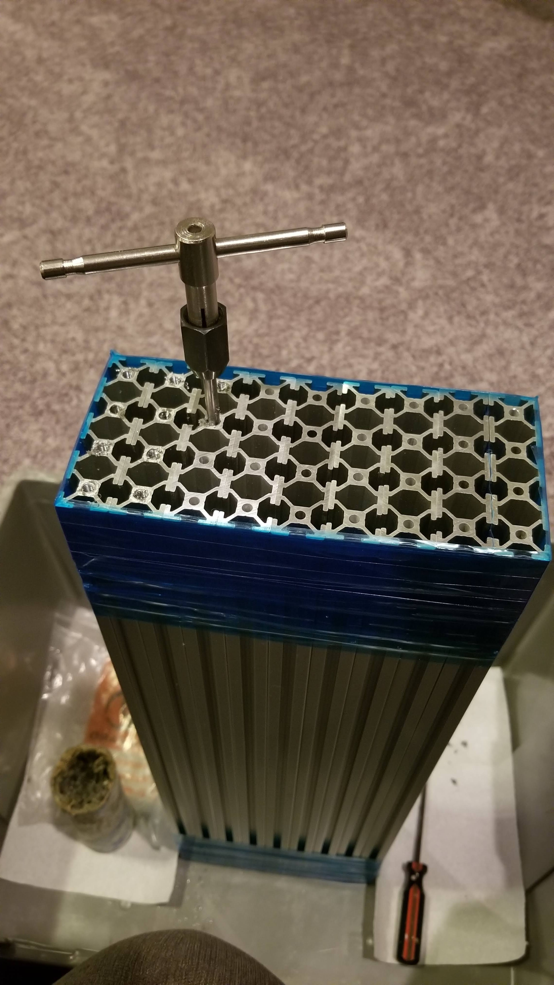

Hand tapping while watching football. After spending my recent hobby budget on trying to fix my existing printer, I’m back to working on the Herculien.
I recently discovered spiral point taps which can be used with a drill without having to back them out every half turn. Can tap a whole bunch of extrusions really quick. Totally worth the investment!
I’ve been sorely tempted to use a drill, but I’ve gotta admit I’m more than a little chicken. I have some SAE spiral taps, but I’ve only used them on thinner material with a hand drill. Even then, if you breathe wrong, they’re likely to get a few choice words out of you. Again, I’m jus too chicken😕
You’re right to be wary because taps are easy to break. You could use the spiral point tap but in a tapping handle. You keep the hand feel but save a lot of time by avoiding the reverse quarter turn for every turn / half turn.
Really, I feel like I’m far more likely to get a good thread by hand taping with a spiral point machine tap than hand tapping with a “hand” tap. Machine taps seem easier to start.
When I am tapping plastic (usually, threads in 3d printed objects) I exclusively use spiral taps. They throw a nice spiral chip out the flutes. I have broken an M3 spiral tap in 6061 aluminum, but only when it was at nearly full depth.
