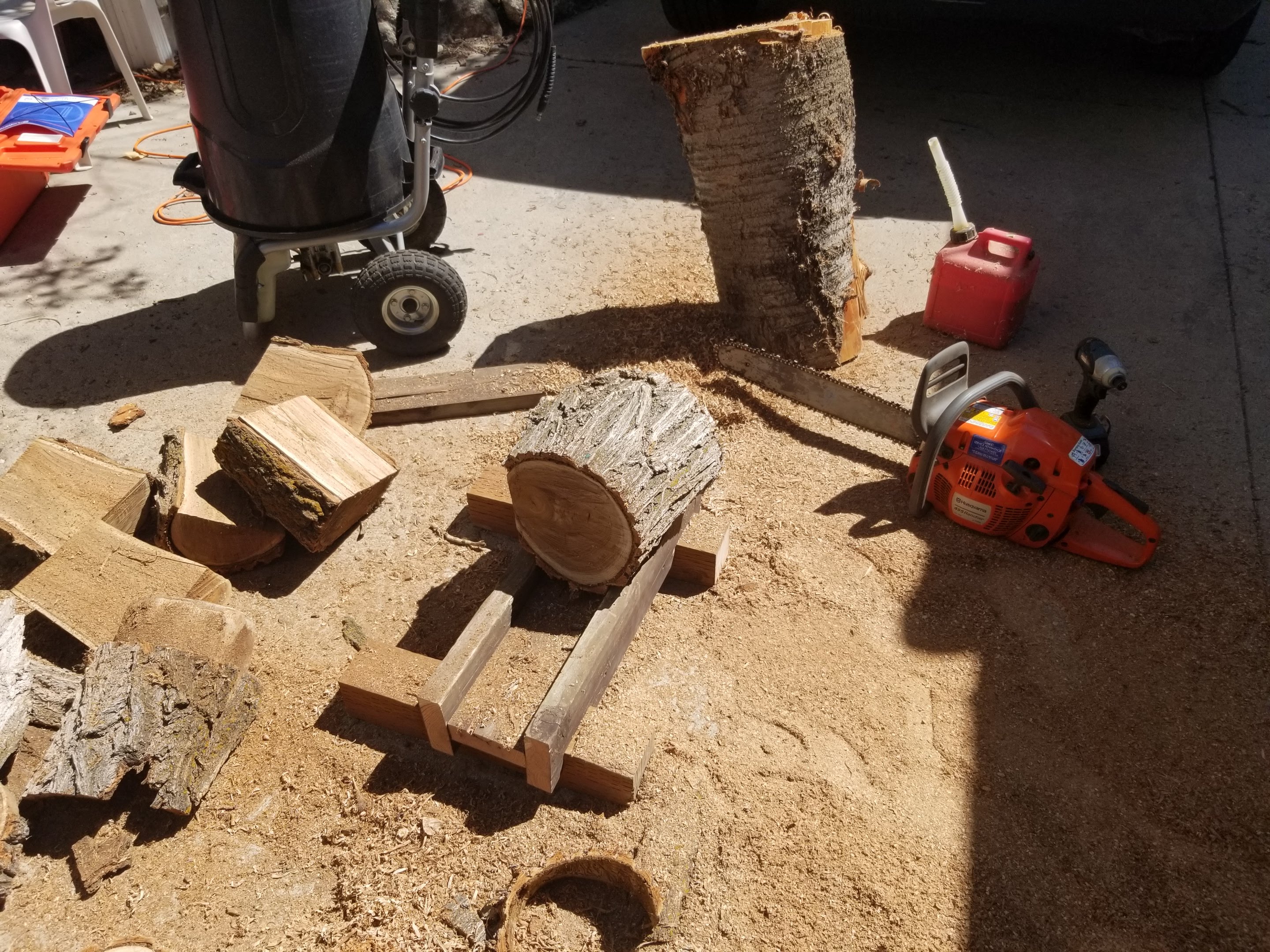

Cutting the log into blanks:
Cut lengthwise 2/3 longer than the diameter.
Cut that peice in 1/2 lengthwise
