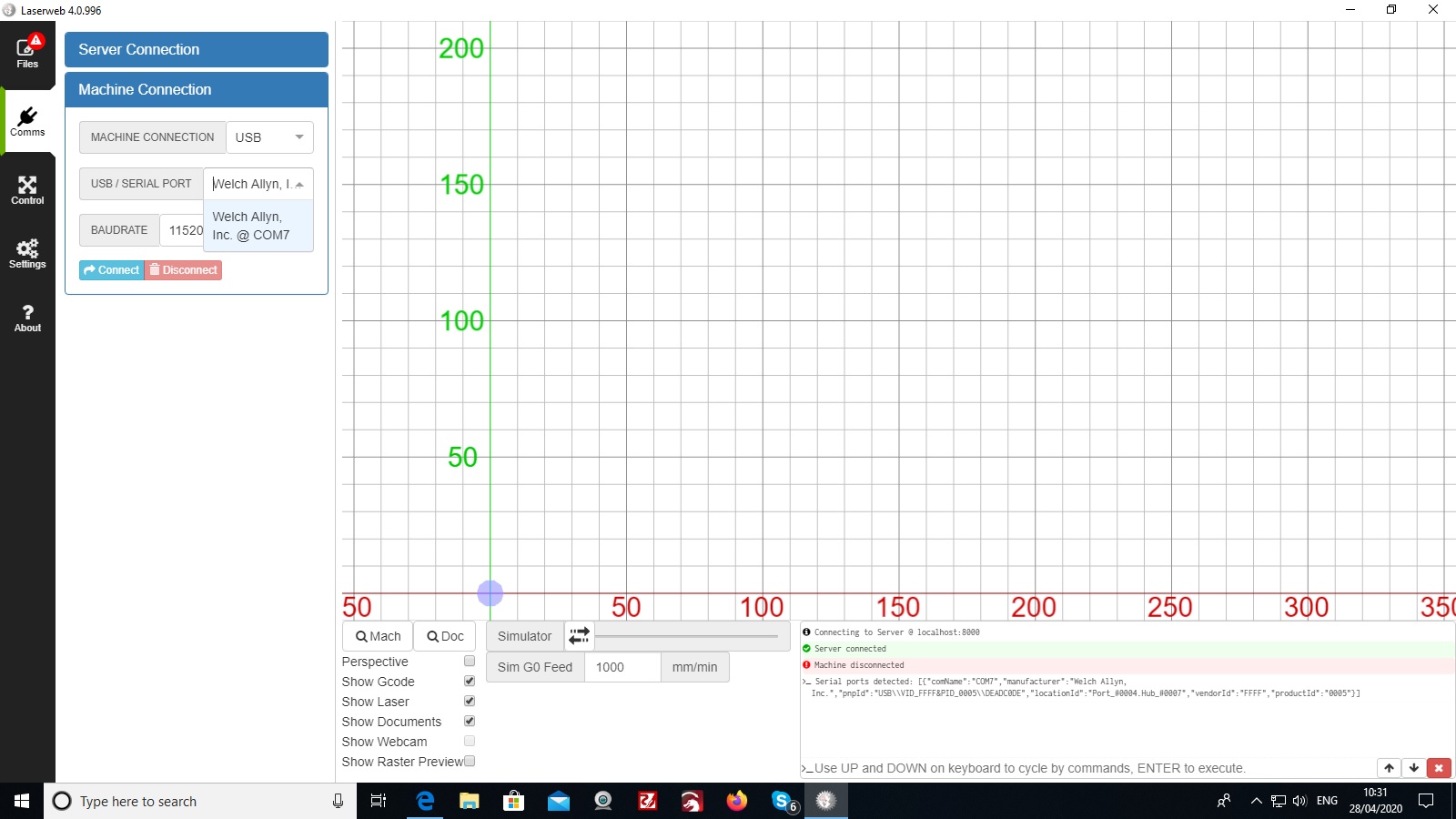

I can put it on the sd card but nothing happens ive seen a photo some where and they said it was flashed proper laserweb picks it up but in don’t say grbl lpc it says smoothieware just don’t know what to do as theres very little help out there for noobs

Can you please test it with a terminal program (like the serial monitor of the Arduino IDE).
The board should respond with a “Grbl v1.1f” welcome string after connecting. With the terminal program, send a $$ command and see if it responds. If it doesn’t respond with a whole list of $x=y lines, then the firmware is not correctly working.

on a side note: it will say machine disconnected when the server first connects. you have to click connect again under machine connection for the machine to connect. At least that’s how it worked for me back when I used LaserWeb. Also try unplugging the USB and then reconnect it. I had an instance where it wouldn’t connect until I did that.
