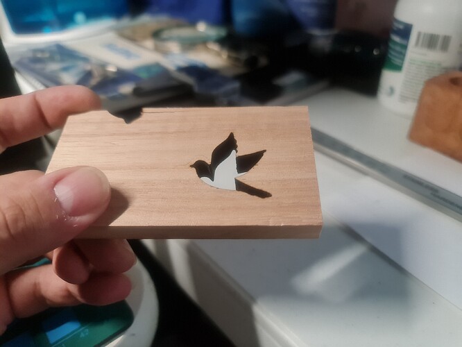

I saw a YouTube video and this guy was cutting 1/4" walnut with this laser. The price is ridiculous and you have a huge cutting surface. I don’t understand a lot of things about this rig…what is “compressed spot technology” and how do you keep it cool? Check this thing out…

It’s basically a ‘normal’ 5.5W blue light (sometimes called near UV) laser LED relying on good internal optics to create a very finely focused cutting point. It can be quite effective as a wood and plastic cutter.
