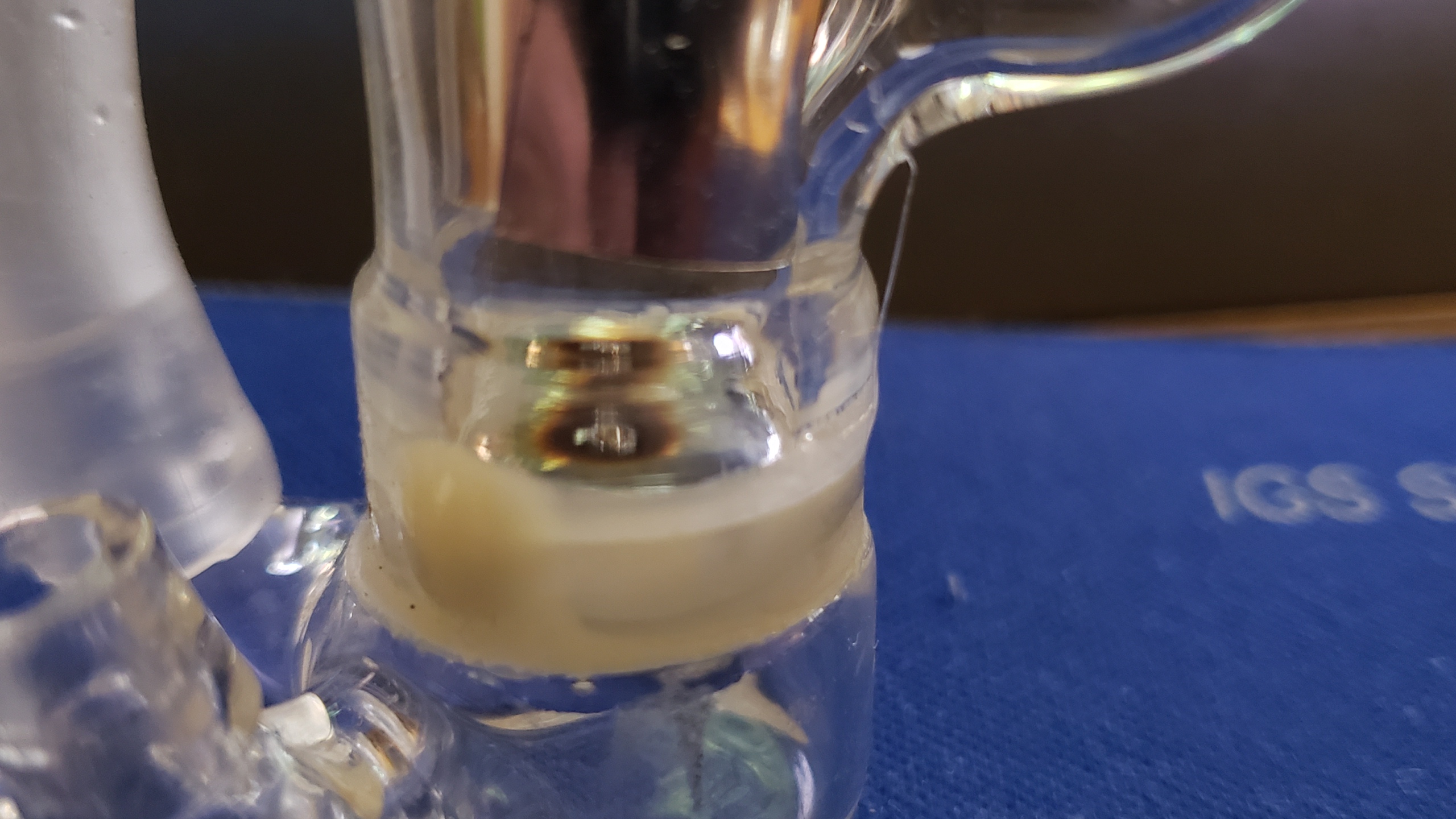

Upon examining the tube I found that the back mirror (Hot end) appeared to be burnt.

I think it’s interesting that the problem can be spotted at the hot mirror. That thing is under a lot of stress, as it works at a beam intensity of ~ twice the power exiting the tube. A little dirt, a poor polishing job, not enough water flow on the mirror, all of these things could overheat it quickly.
Still, all of my comments still reduce down to “bum tube”.
