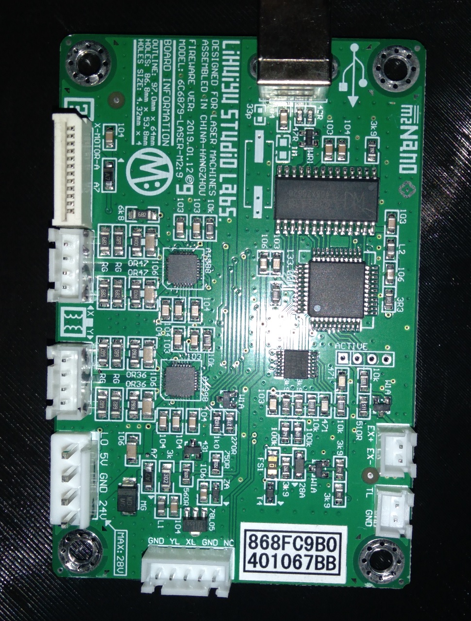

I want to save some money and use lightburn in my k40 laser I am uploading a pic of the current board that is in my machine.
The stock board,
I love very much that I have gotten to know very well, I enjoyed our time together and will be selling it on ebay as a used good board for cheap to hopefully live again!

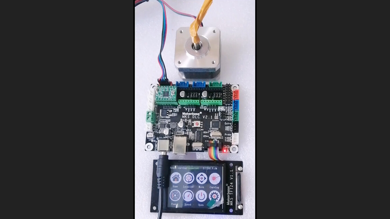

I have purchased this controller and this touch screen lc
/////// options for retrofit. I can’t believe you doodz had this kind of drop in support back in oh seventeen. I find myself with much time on my hands lately and dove deep into inkscape and k40 whiperer but
Do I still need an additional circut to fire the laser at a certain power will it stay on I saw a few videos where some guys said a usb stick caught fire, that was on a smoothieboard something or other.This forum is a bit difficult to navigate any forum is at first especially when you are as dumb as I am.
I’m surprised china hasn’t copied and faked the cohesion 360 board
My question about the motor controllers do i just buy 3 drv8825s or tmc2209 or should i stick with it comes with?
I plan to use a rotary table hence needing 3 whatever i am talkingabouteez.
I bought ESP-12S wifi controller separetley. I uploaded pic with bundle but I bought my wifi midule frome ebay and the tft24 and the mks dlc 2.1 with 3 last place controllers
This is the annoy board was this the better choice?
this one was more expensive but i went for the 2.1 since there are a ton of ppl the made the mod. Sort of.

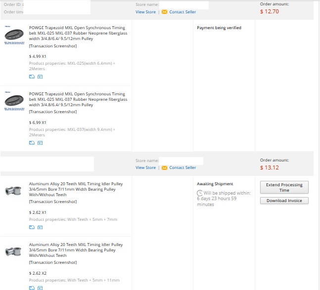

If you are trying to use the original steppers and pulleys that’s the wrong belt. See our replacement parts page:
The belts are NOT the common 2mm GT2 toothed belts so common on 3D printers and in hobby CNC. They are instead standard imperial MXL 0.08 inch belts (in metric, 2.032mm) in order to support motion in exactly 1/1000 inch increments. X is 3/16" wide, Y is 3/8" wide (both nominal).
Whats the best course of action buy extra 3 idlers and a length of belt and use whats there? both sizes of belt 10 and 6.5 or something else?
I can’t say your best course of action. That page has links to sources for the different-width X and Y belts though if you want to stick with the imperial belts.
Holy smokes that mxl stuff is expensive.
Any comment on the card I chose vs the annoy card?
Still not clear on additional circuts needed for firing laser. Is there a resource I can dive into without asking too many durm questions? Other than read all the questions on this forum in the k 40 section ever as the answer. .
What controller board did you decide on?
Don, thanks for the question!! This one!
$31 with new user discount came with the screen and the board
is the one I went with it apparently already has laser software flashed on the screen and firmware.
