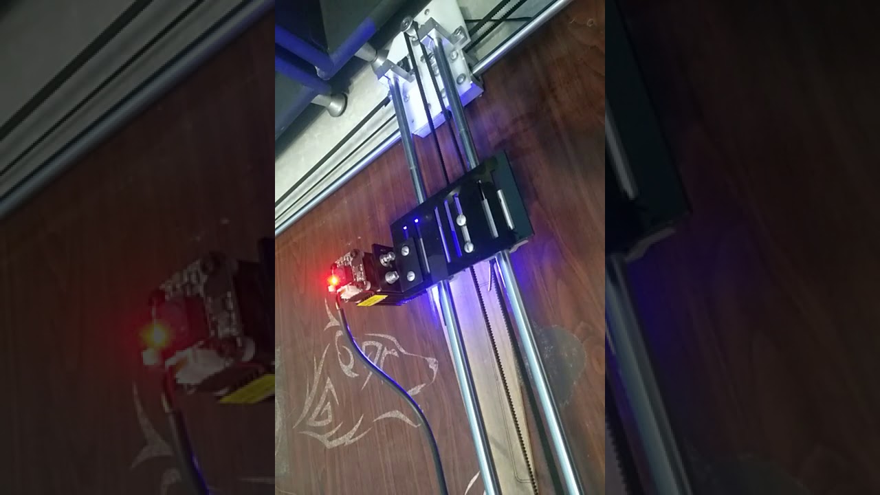

My result is not good in this video i will show u all setting and movement of machine even i set cut rate over 2000 … the machine is soo slowly and its burning all wood and nothing appears of my photo i dont know this problem why happend
can u help me thnx
hey @Ariel_Yahni_UniKpty what about the dynamic laser mode for grbl, doesnt that need to be on?(32 i think) still a grbl noob lol
@P_Mido the video is very bad, cannot help you like this. Did you change the speed and I said above?
Also as Joe says if you are in GRBL 1.1 $32=1
If all is turning black there could be 2 reason: laser is not pwm, or to slow o laser mode off
i already change value of $110 and $111 = 6000
and yes im grbl 1.1 so i will change $32=1
and My laser is PWM !! TTL
