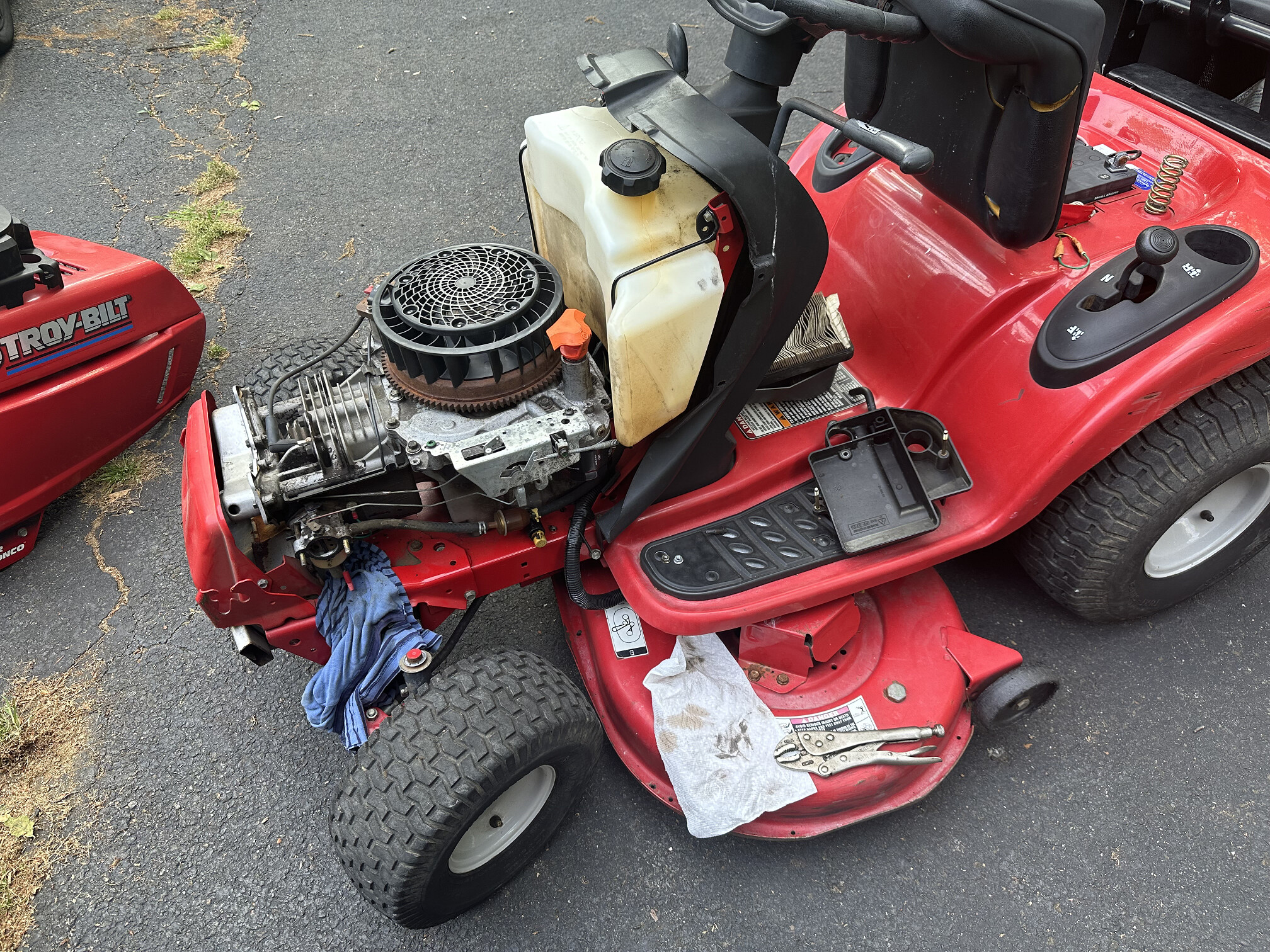

In my later steps of debugging, with some of the items taken off as you will see in this pic, I did get the engine to sound like it was running for a few hits during cranking, and some white smoke came out of the exhaust, but the unit still did not run. I later learned that running the unit with the carb opened up and no air filter on may not have been the smartest move, and that I will likely have to put a new gasket behind the carb now that I have taken things apart there.
Anyways here is the pic of the most disassembled that I got the unit:

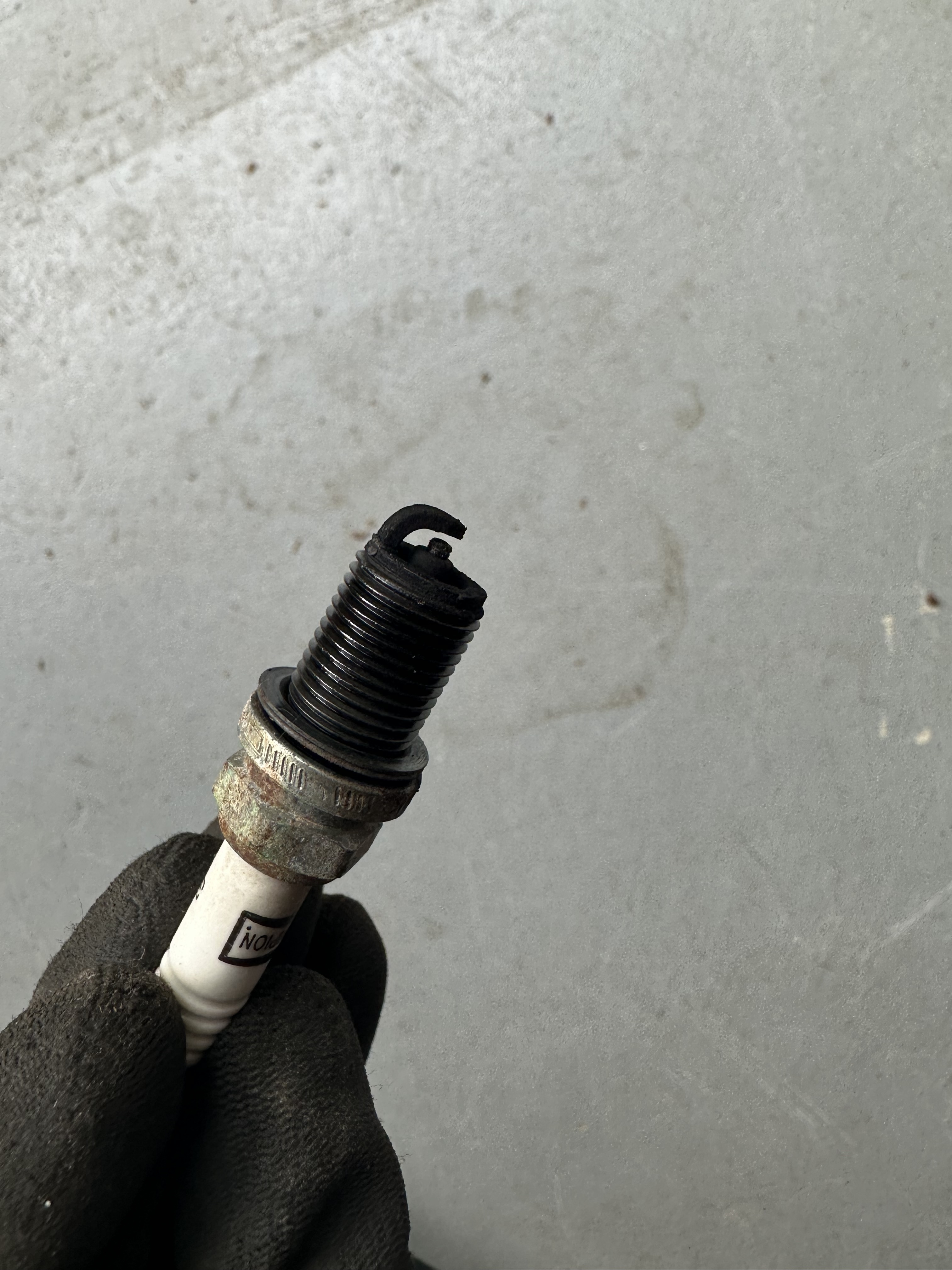

Have you checked for good spark? Pull the plug, hold the outside of the plug to the engine to complete the circuit, look for strong and consistent spark.
Also check for junk on the plug. In my experience, every time I’ve thought I need to clean and gap the plug, I really just needed a new plug.

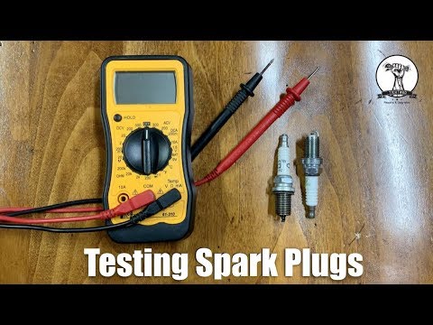

Now that it’s morning and I’m possibly awake… :grin: Measure the resistance of the plug with your multimeter. If it’s not between 500 and 5000 ohms, replace it.
What I was taught was if the resistance is too low, the spark doesn’t last long enough to reliably ignite the fuel; if it’s too high, the spark might not be strong enough or not form at all. I don’t know whether that was truth; what I understand is that the spark plug is the resistor in an LR series circuit, and the magneto as a pulse generator is basically the voltage source and inductor.
Would that be measured from the connection point on the outside of the plug to the center pin? Or is there connection between the conductor and the chassis ground of the plug?

In those few minutes I pulled the spark plug and sure enough it is all black and gunked up and the resistance is at least 12k ohms, if not in the megaohms (getting the multimeter probes onto the gunked tip area is difficult)
Amazon order for a Champion 3071 (equivalent) plug is submitted. More next week when it arrives. Lots of rain this week anyways so couldn’t do much even if I wanted to.

This is the video I used, fast forwarded to the good parts :slight_smile:

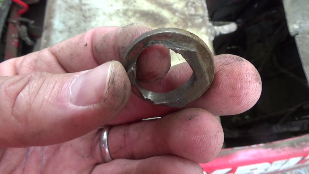

I have to figure out the fix for the steering wheel slipping when trying to turn while standing still. I believe this has to do with a retention bushing/ nut/ fastener kind of thing that secures the bottom of the steering rod to the frame and prevents it from flexing and slipping. I’ll get in there to check it out in detail at a later time.

The unit steers ok when moving though, so based on videos I saw I wonder if it is the flange holding the system into place. This is what I was trying to describe above, and your Amazon link conveniently showed me the related part, so now I have the vocabulary to articulate it:

FYI this is the steering symptom and fix that I’m referring to:
So that bearing flange isn’t a bearing at all but instead is a bushing and it doesn’t look like it’s oil enpregnated brass so why not put a bit of lithium grease or bearing grease on that for a chance of a longer life.
Oh yeah I forgot about that bushing. It’s been a while.
A bushing is one type of bearing. Its not a ball bearing, or a needle bearing, etc. But the shaft bears on it; it’s a bearing.
Because they would pick up and hold abrasive dirt, and mowing the lawn creates a perfect environment to get dirt in there. It should be dry.
It should be bronze not brass for longer lifetime, but nothing about this tractor screamed “engineered for the ages” when I pulled mine to bits and put it back together as a frankentractor.
