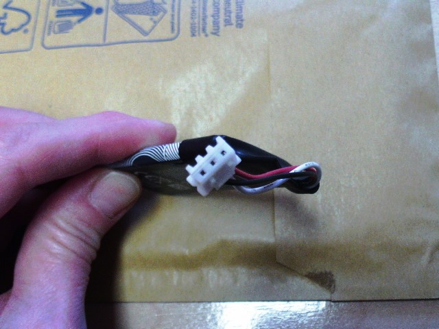

When I google the BL-5c it seem to me to be the trusty and ubiquitious “Nokia” battery present in phones of a generation ago but still used today e.g. in the classic Nokia 6100. However all the BL-5c batteries I can find on line are have flat contacts and no wires! I for sure could get a standard BL-5C and some how wire it to the connectors. They have supplied some photos of their battery they can supply, but unfortunatly not to my location in the EU as they are based in Great Britian! This is super frustrating. I attach the photos. So the issue now seems to be (1) can I source a BL-5C with wires and the appropriate connector and (2) what is the exat spec of the connector. The ones on batteries I have that look similiar, but, are much smaller. I have also now opened iup the phone and the dimention of the socket on the outside is amost exactly 10mm. I have asked them what the spec if but they have not given an answer. I am pursuing this, but, I am deaing with customer services and I suspect the members of this forum will be more expertise here and so will appreciate further help. At least this clears up what the middle connector does!
Photos from the company of their battery

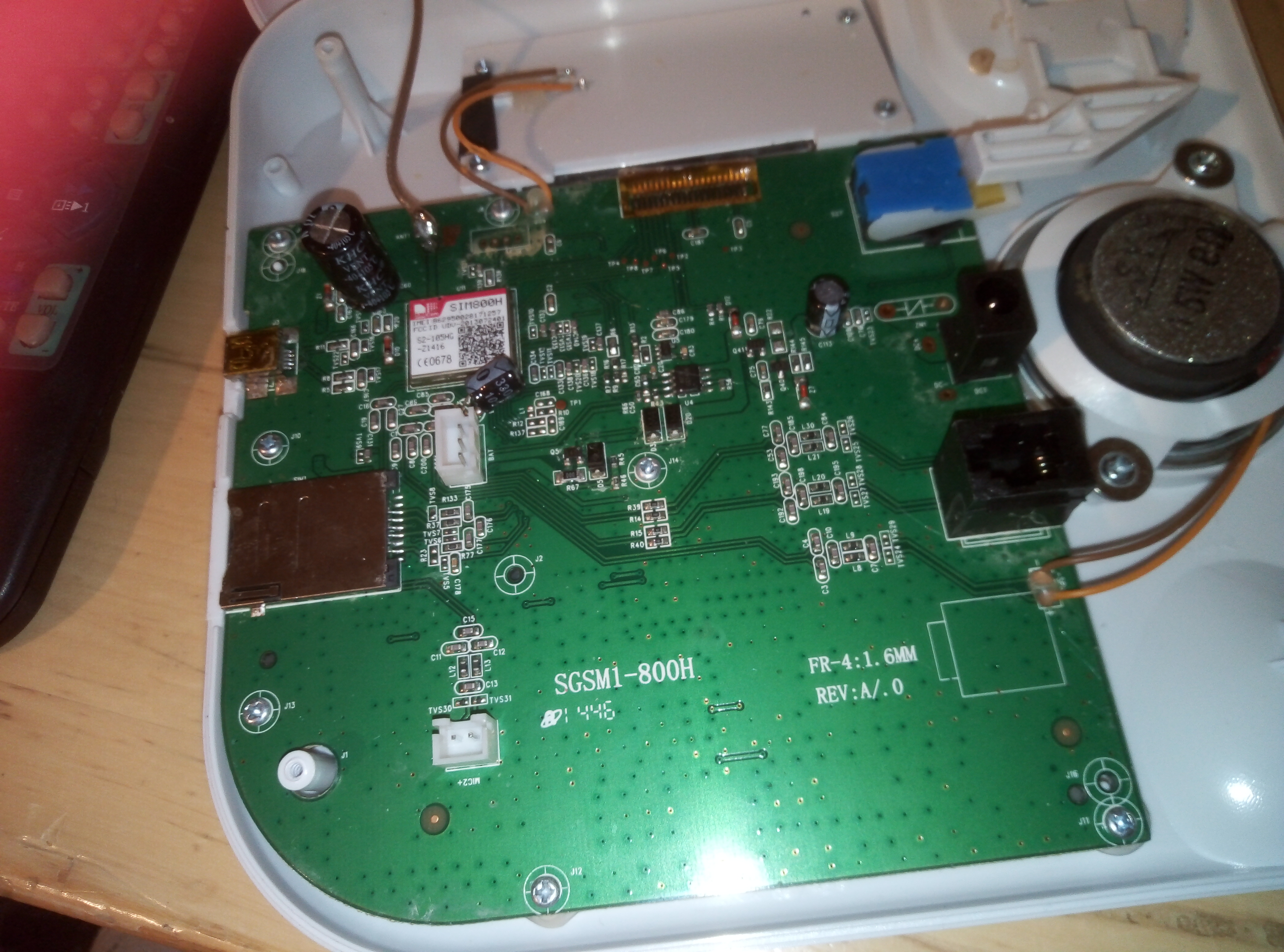

Photos from the inside of the device. I was quite supprised to find tha tit was not simply a feature phone in a bigger case and has a bespoke board although it does seem to be based around a standard chip set.
I will post some more photos in a follow up as the system is limiting me to 5 photos.
Many thanks for any help.
More photos
So I think I hvae finally identified the connector as a JSP XHP 3. No amount of googeling finds a BL-5C with such a connector. Does anyone have any tips of soldering wires to the flat contacts of a standard BL-5c?
