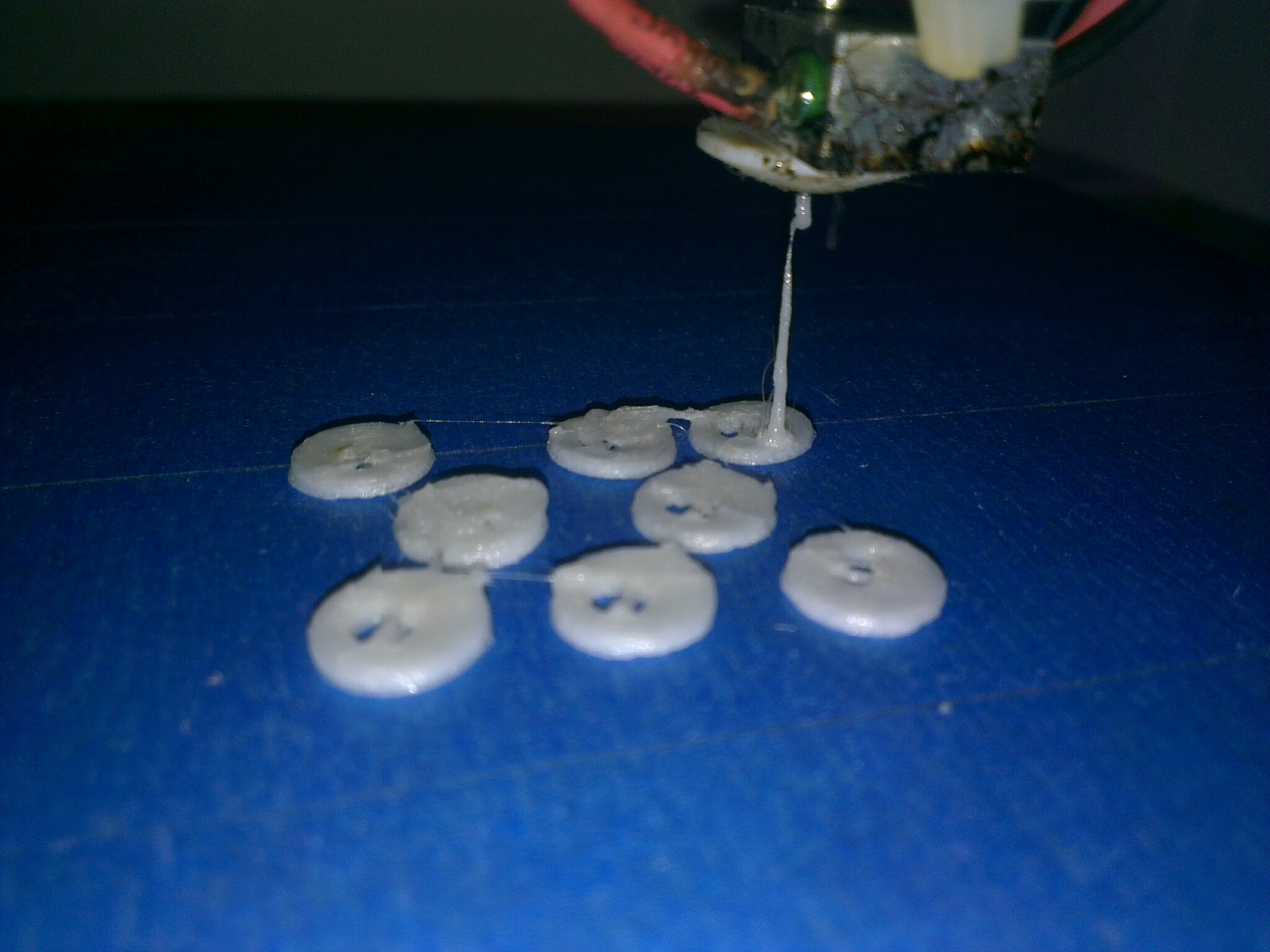

I’m making these tiny cams for a customer, 10mm diameter… We tried abs but its too weak and crushes so, I’m trying nylon ones…
Printing 225-235 deg on a blue-tape bed - slow first layer, then faster to avoid drooping… Tried with and without fan… Cool bed, 60 deg bed…
It just won’t stick down, or rather, it starts to warp heavily and becomes unstuck… Lots of contact with the bed (squished) - I’m out of ideas except trying “poplar wood” (translation anyone? Is this MDF?)
I suspect my filament is a LITTLE moist… Dried a bit but I’m not convinced… But the problem isn’t adherance as much as it is warping, anyone have any ideas? Thinner/thicker layers? What are ideal conditions for nylon NOT curling? Heated bed or not? Fan or not? Fast or slow? Thick or thin? I’d like to start at the ideal end of the spectrum, get it to stick and not warp, and then tweak toward quality and speed…

I add a 3mm single layer brim (an option in Slic3r and most other slicers) that I cut off and print on cold glass covered in a single layer of gluestick (uhu brand from amazon, I’ve heard the elmers ones work too) and it’s worked just great for me even on parts 10mm wide by 200mm long. The gluesticks I use are: http://www.amazon.com/gp/product/B001PMJYAO/ref=as_li_ss_tl?ie=UTF8&camp=1789&creative=390957&creativeASIN=B001PMJYAO&linkCode=as2&tag=rpgtab-20

Buy some garolite dude. Also keep that nylon dry as you can. I’m printing fingers with 618 on lightly sanded garolite right now, sticks very well.
Garolite - I read that somewhere too actually - I’ll look into it - Cheers @Tim_Rastall
Yes nylon requires garolite - its expensive but you can get a thin sheet and epoxy it to mdf . it also helps to have a heated or at least enclosed chamber - keep the whole thing warm not just the bottom with heated bed. Larger parts ate going to shrink if you can get it to all shrink at the same rate you’ll get nice large parts.

Without garolite brim is pretty much essential. I do extra loops to start and space them so they overlap the brim. Also print as slow as you can. Poplar is not MDF. It is a fine grained deciduous wood but soft. Similar to Birch.

You also need to really really really dry out your nylon before use. At least a hour in the oven at 120 degrees C. Probably longer would be better.
