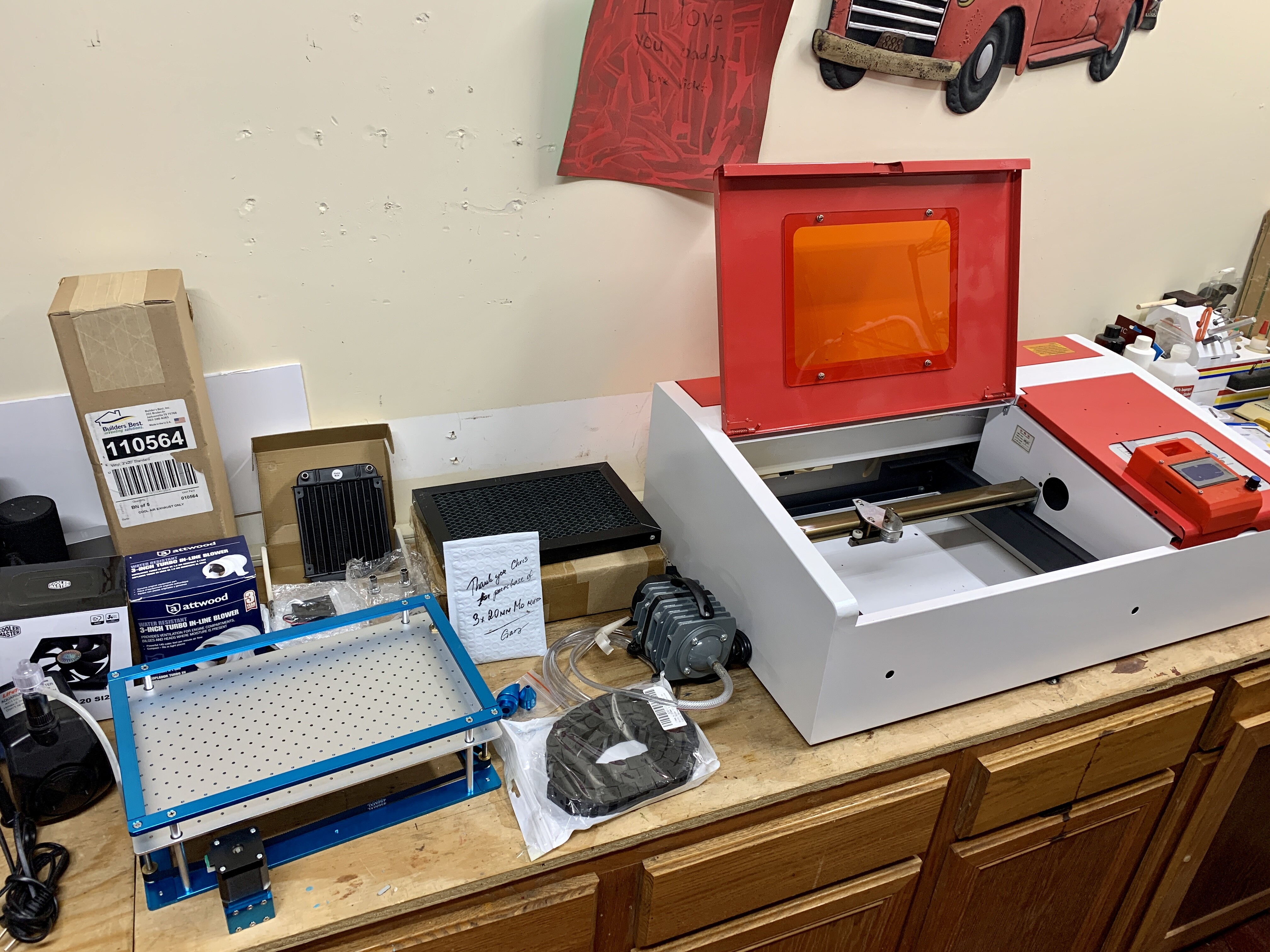

I just bought this K40 locally including all that you see here. Most of the upgrades have not been installed yet. The previous owner installed the Cohesion board and display.
My questions:
  1. Replace the existing outlets with either a GFCI outlet or attach a power strip/surg protector?
  2. Get a bucket and use the existing pump or buy a CW3000 or CW5000 chiller?
    3.What was the plan for the mini radiator, 120mm fans, little clear tank?
  3. Should I go ahead and install the new blue head along with the 3 new 20mm mirrors?
  4. Use the aquarium pump for air assist or install a blower/fan?
I also notice this K40 didn’t include the “big red button” should I get one of those?
I got a pretty good deal on everything so I don’t mind adding some more money if it will make laser cutting easier for me.
Before this I had a 2watt Eleksmaker and have already been using Light Burn
Any help would be greatly appreciated!!!

So far I’ve removed the stocked bed/fixtures. Remove the stock rear duct. 3D printing a replacement duct. Working on a shopping list.
  1. Analog mA meter
  2. rolling cart to hold the laser and either a chiller or a bucket and pump
If you just don’t use them and run everything off a switched outlet strip it might meet your needs?
Bucket or CW5000 or lightobject Q600; CW3000 will run the water temperature eventually a little above ambient. The mini-radiator won’t do you any good. It was probably one of those “seemed like a good idea at the time” things to the seller. Cooling the K40 laser tube - Getting Started with CO2 Lasers - Maker Forums has more advice and details.
Aquarium pump for air assist. Fan / blower only for exhaust, not for air assist. Fluid dynamics will not be your friend if you use a fan for air assist.
Some way to turn off all the power easily that is immediately at hand is good. e-stop buttons are a cheap way to do that; a power strip that is easily accessible (not behind the K40) could also work. Keep in mind that when you want to hit it the unit might be on fire and you are trying to kill power before hitting it with a CO2 fire extinguisher.
Up to you but if I were in your shoes I’d do changes in small increments and replace the head and mirrors at the end of the process, on the “change one thing at a time to know when something goes wrong” theory.

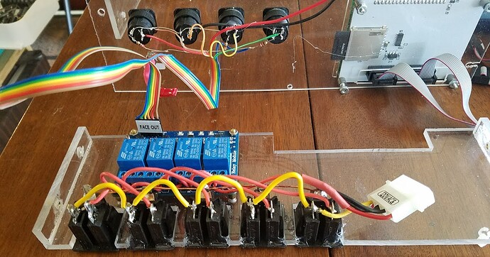

I have found the power switch that came with the unit to be sufficient to control the units main power.
I added grounded sockets for AC distribution that are controlled by a relay board with associated switches. All these sockets are wired to the mains.

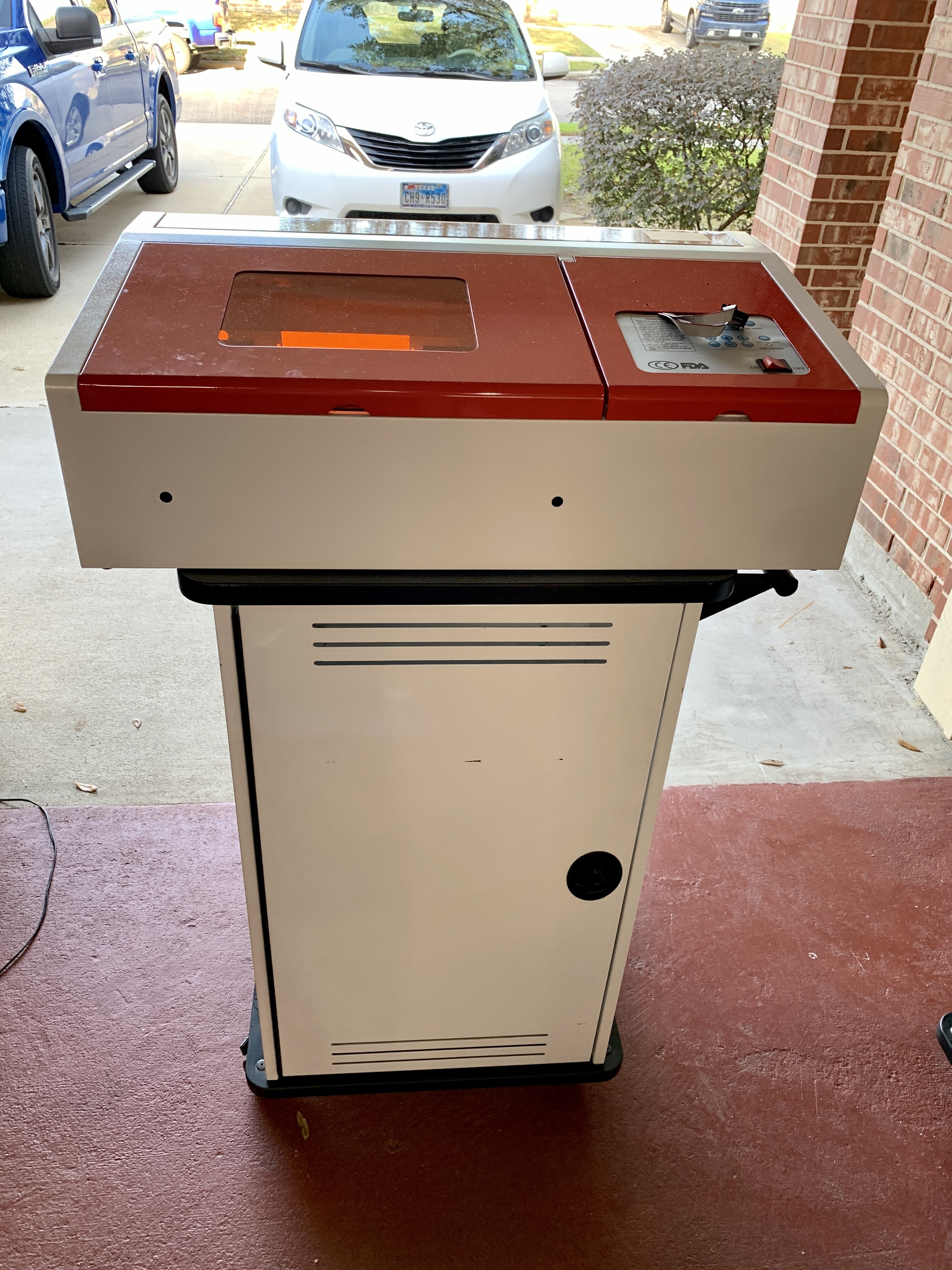

This is great!! Thank you guys for all the great tips and opinions. For right now I think I’ll go the power strip route. Eventually I’ll make a new control panel. I did find a awesome cart for the laser today now I can roll it around my shop. I’m planning to put the chiller and aquarium pump inside the cart and mount an exhaust fan on the rear of the laser.

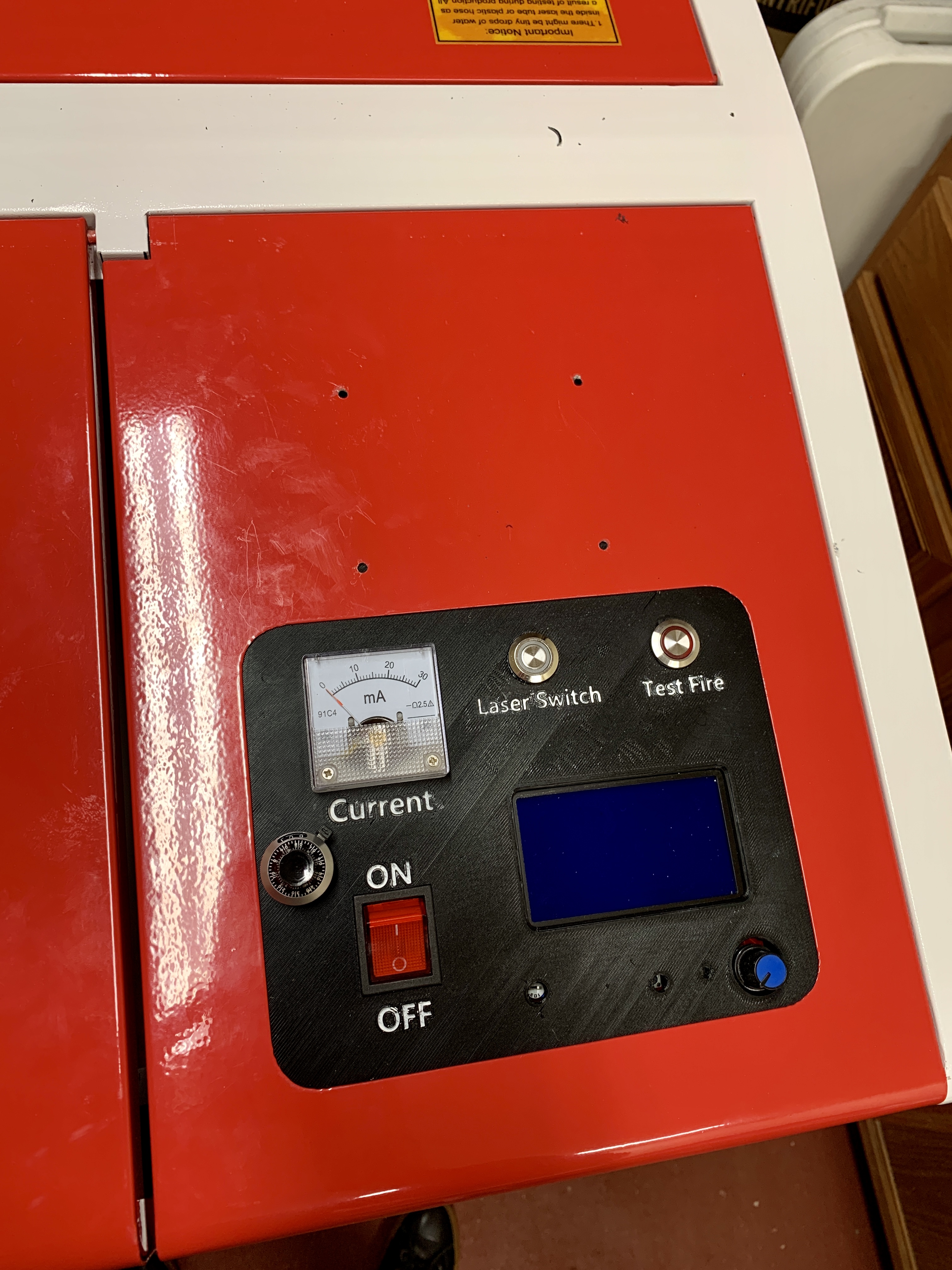

Here’s an update.
So far I have…
  1. 3D printed a new control panel
  2. 3D printed a new air assist nozzle and red laser cross hairs adapter
  3. wired in the mA meter
  4. Added the drag chain (I think it’s the wrong size, too big)
Next I’m
  1. wiring the test fire button
  2. Wiring the laser on button
  3. Wiring the potentiometer
Then I think I’ll be ready to power it up. Once I see that it’s working I start on the next phase.
  1. make a new control panel to accommodate more buttons and the laser water temp display that connects to the water flow sight glass.
  2. Mount the water flow sight glass
  3. Wiring the “big red button”
I’m still a bit foggy on what I control with the Cohesion3D GLCD. From what I gather I dial the laser max output with the potentiometer by reading the mA meter. I still need to look up what the max output should be dialed to? Then lock the potentiometer. After that Lightburn creates the gcode. I can either send that file over USB or save the gcode to an SD card which I insert into the GLCD. Oh… then scroll through the GLCD find the file then burn that file.
