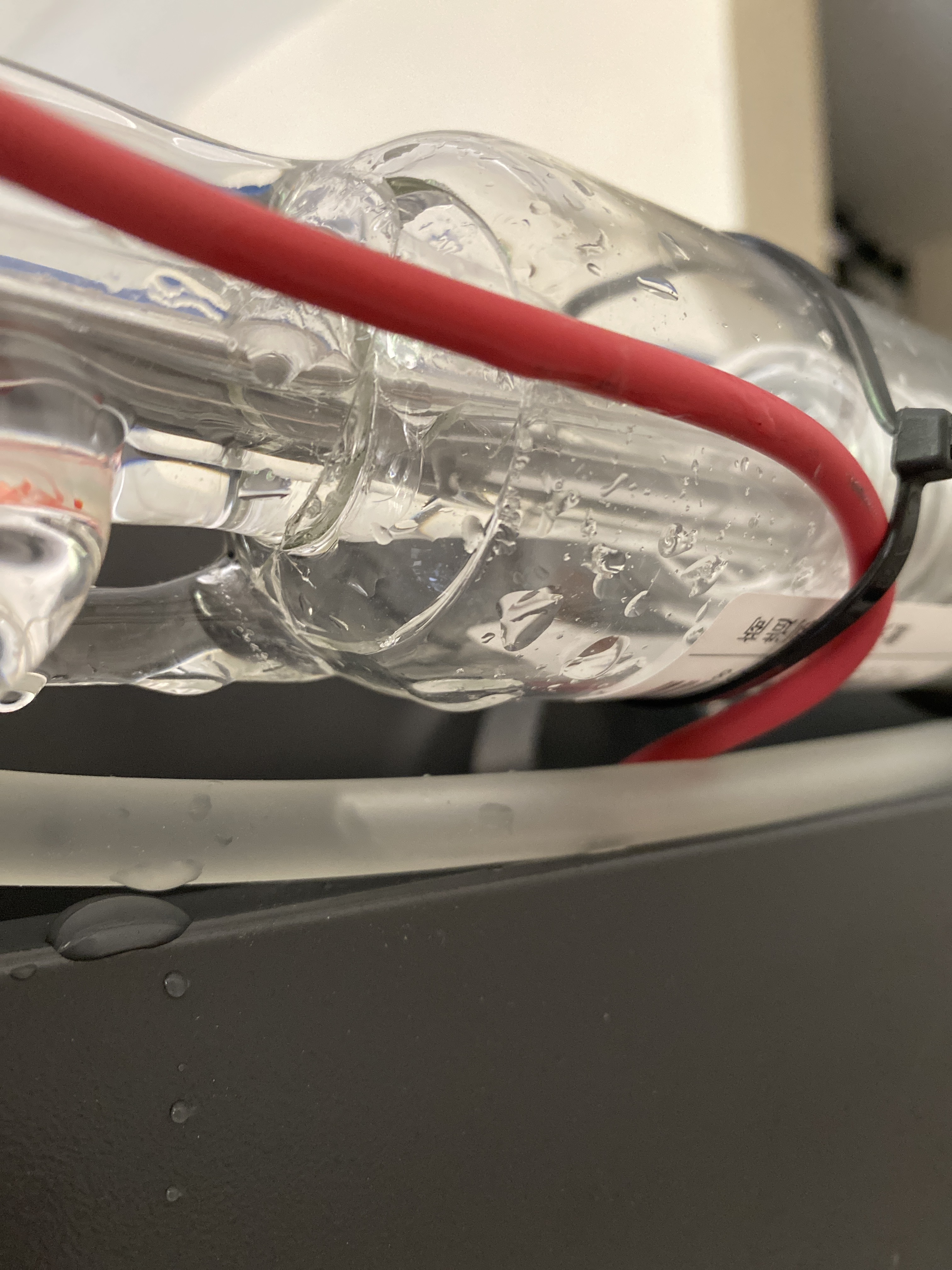

Its coming from laser tube a loud hiss and a purple flash in the corner of laser tube mate. No mate no tools to check as no electrical experience tbh im a chippy lol appreciate your time
Can you post a video?
Also please post a picture of your control panel.
Without a picture of where the sound is coming from its hard to help.

- If its arching around the tube then it may be a bad tube. Look for cracks water leaks etc. in the tube
- If its arching inside the cabinet under the control panel in or around the blue power supply then you may have a bad laser power supply.
If this is a brand new machine I would contact the seller and tell them you have a bad tube or LPS.
