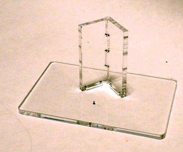

It’s also possible to locate the cut point with a physical pointer matched to the head, and might be easier than a “red dot” or crossed line lasers.
@Ariel_Yahni_UniKpty posted this link long ago, and it’s still a really simple idea:
