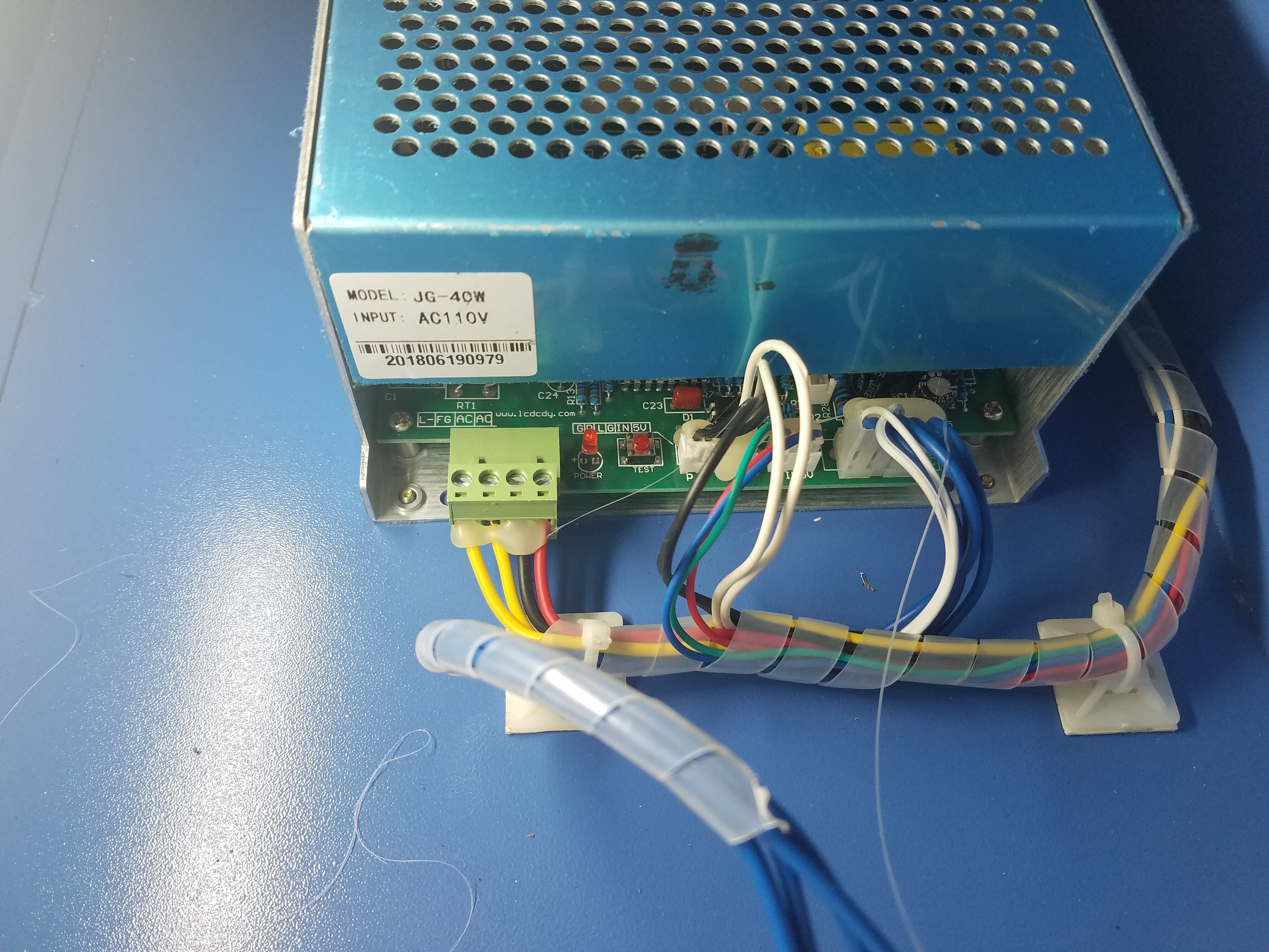

To get started take photos of all areas of the machine and post them here.
-Control panel front and back
-Electronics bay:
–LPS wiring
–Controller and wiring
-In the Laser Tube Bay
–Tube showing anode and cathode connections
-Under the cover
–Mirrors
–Bed
–Head

Let me know if any other pictures will be helpful.
A picture of the front and back of the control panel would complete the set.

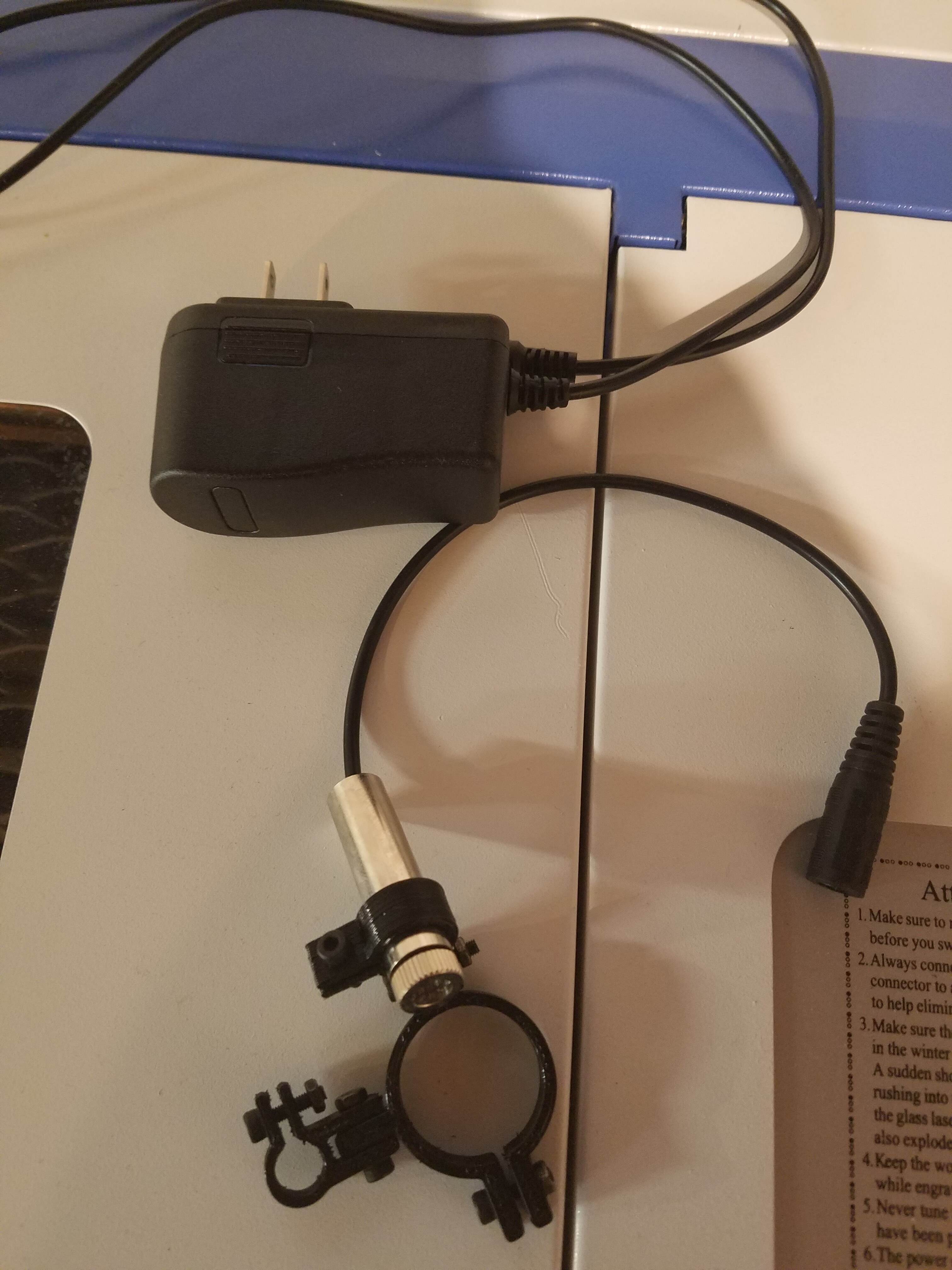

Not sure if it would help to know what upgrades I would like to make to the machine or not. I would like to use the Lightobject Z-table and a rotary machine eventually. I have also considered upgrading the controller to be able to use LightBurn instead of K40 whisperer. I would also like to add a laser pointer to the laser head so I can test cuts/identify the starting point without having the laser on. I may also want to add some additional LED lights inside the cutting area.
