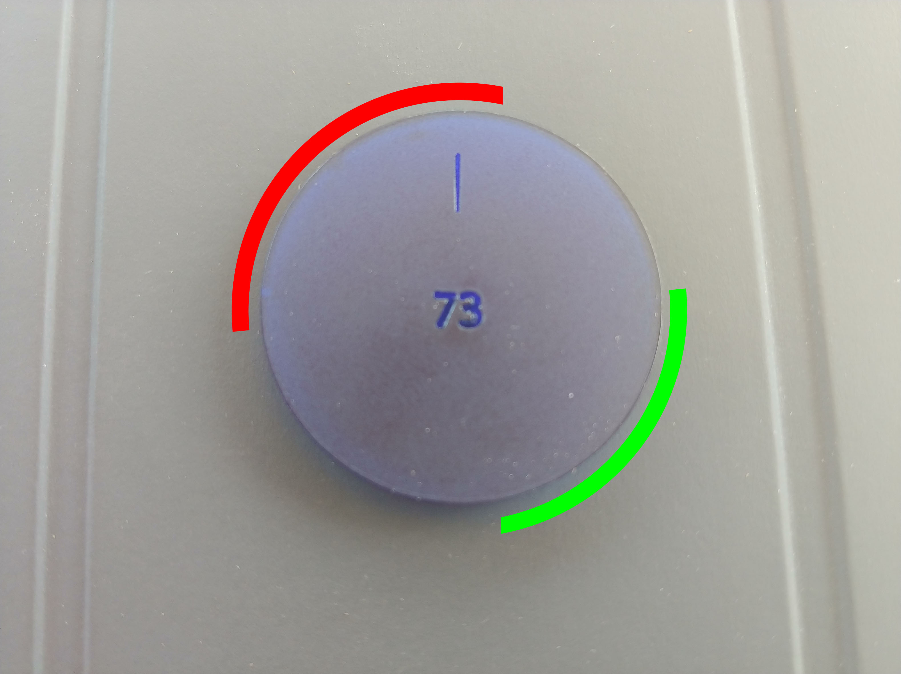

Hello again. Again I’m in need of help with the setup of my K40. I’m amazed at how much I’ve been able to improve its quality. Unfortunately now I’m stuck.
The problem is the following. The path is almost perfect, sufficient in any case, but when cutting 3 mm methacrylate, the oblique cut on the piece is unequal. This is seen when I cut a circle. In the red area of the photo the cut is oblique to the outside. In the green zone it is obliquely interior (not as exaggerated as in the red zone) and in the other zones the cut is almost perpendicular.
The machine is leveled with a maximum error of 0.4º. The x-axis, the table, everything is leveled in the same way. The x-axis belt has the proper tension, I think. I have also been testing different focal points, with a difference of 7 mm in height. I don’t know what else to check.

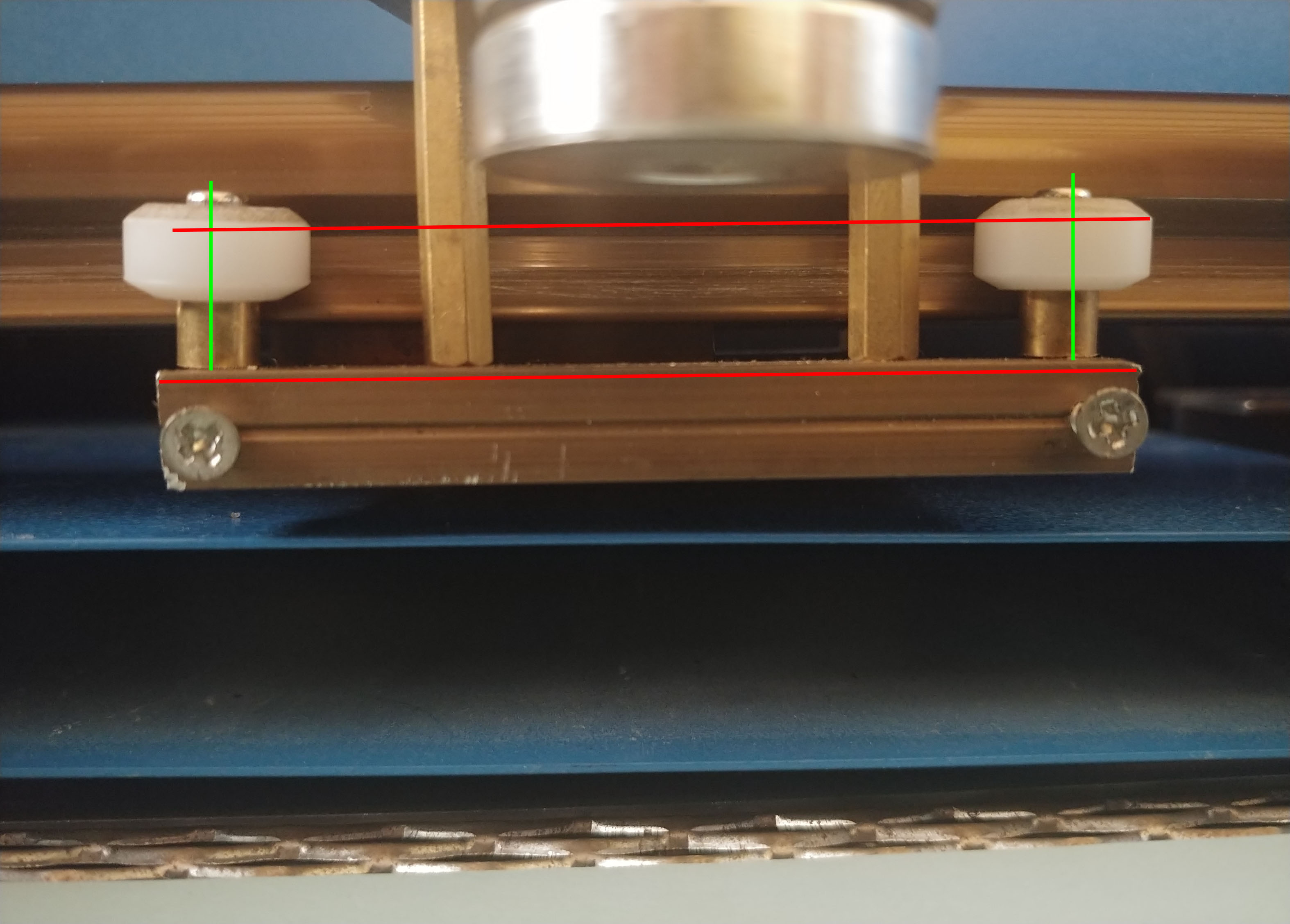

There is an item that looks suspicious. The lower left bearing of the x axis. It appears that the hole in the aluminum part is slightly larger than it should be and this causes the part supporting the bearing to be slightly tilted. Very little but inclined. I don’t know how to fix it to check if this is the problem. I guess I buy a new part.
Do you think it is worth the investment?
Yes, unless it’s the camera angle, the heads left bearing looks like it is not properly up in the track and the shaft holding the roller is not at 90 deg to the gantry.
The standoff holding the lower bar also looks canted. Looking at it I wonder if the entire head assy is in the track properly?

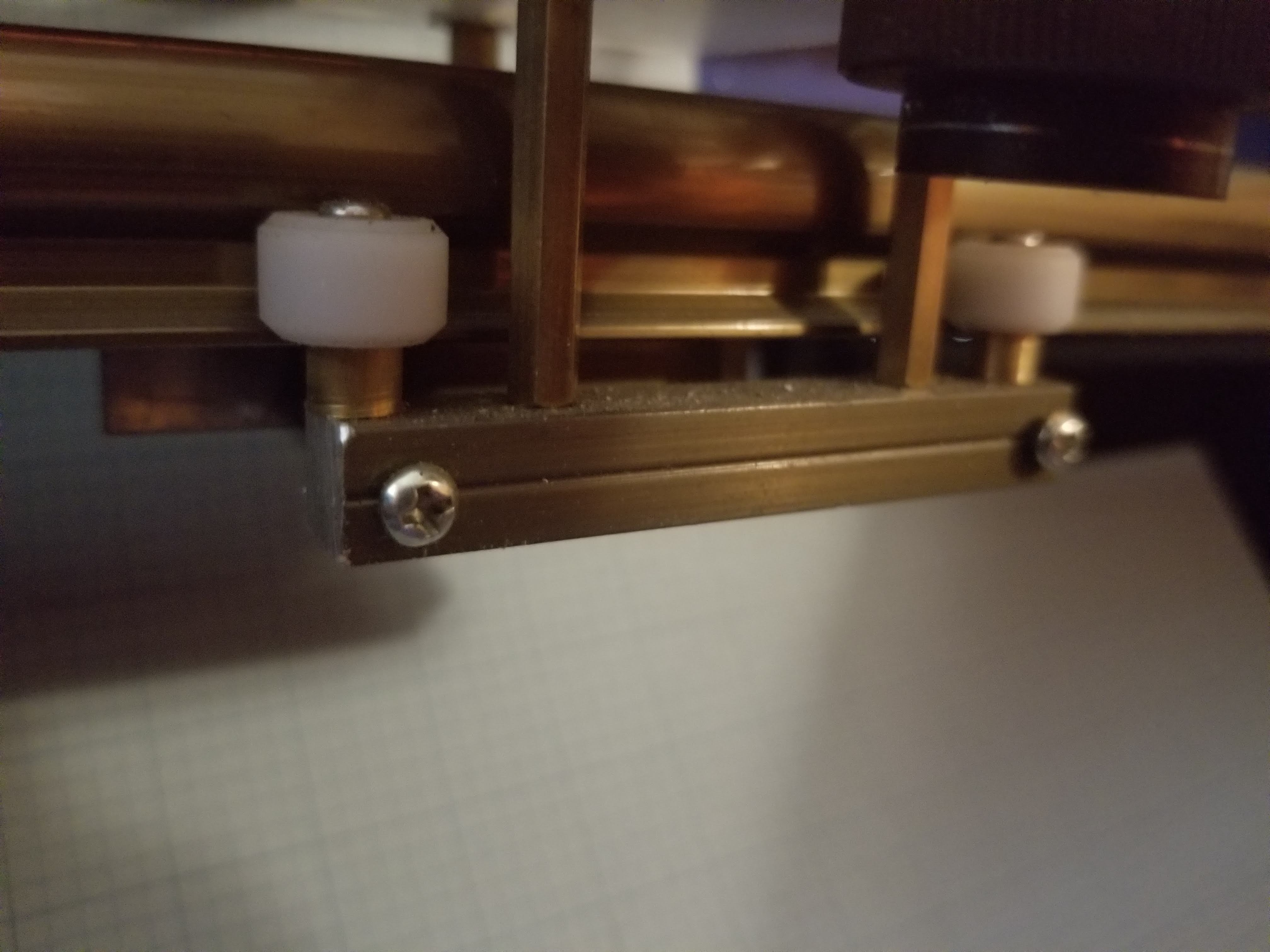

Attached are pictures of my head assy. Unless we are being fooled by the camera angle this assy looks straighter and seated in the track better than yours…
Strange: If the your head is canted why does the test not show it???
Ignoring why the test does not show the error:
Is it possible that the two large mounting spacers to the right of the left bearing and to the left of the right bearing (not the bearing spacers), are two different lengths? This would cant the assy as they are pulled tight?
Note: on mine there is some small upward play on the head assy. How about yours?

Excuse me I have spent a few hours trying to solve the perpendicularity of the bearing but I could not.
The perpendicularity test does not fail because what changes between the two shots is the height of the bed. If the x axis doesn’t move, the shot is exact, so I think everything points to movement.
The hole in that bearing has much more slack than the others. If I squeeze the part with the bearing upside down it looks solid enough but the fact is that when all four bearings force together the lower left bearing stays in an oblique position. No matter the bearing you use, it is always in the same corner.

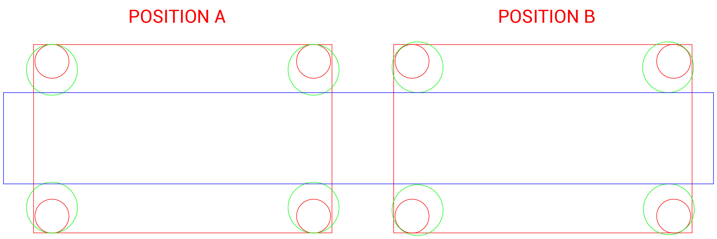

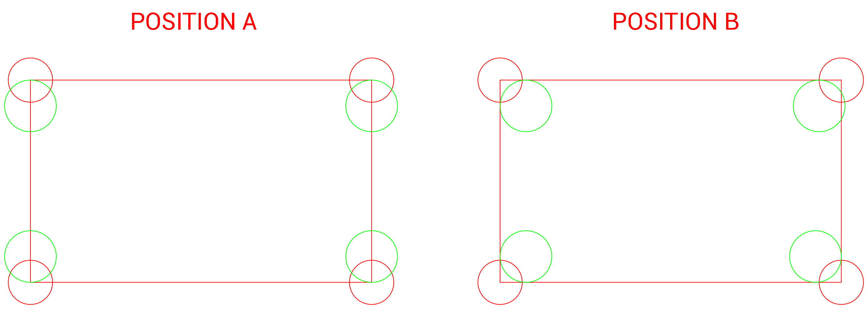

I have a question, which of these two bearing positions is the best?
not sure I comprehend the question?
Excuse me, I think that with this new representation it will be better explained.
The red circles represent the pillars that are inserted in the aluminum piece. The green circles are the bearings. I think the optimal position is A but I’m not entirely sure.
