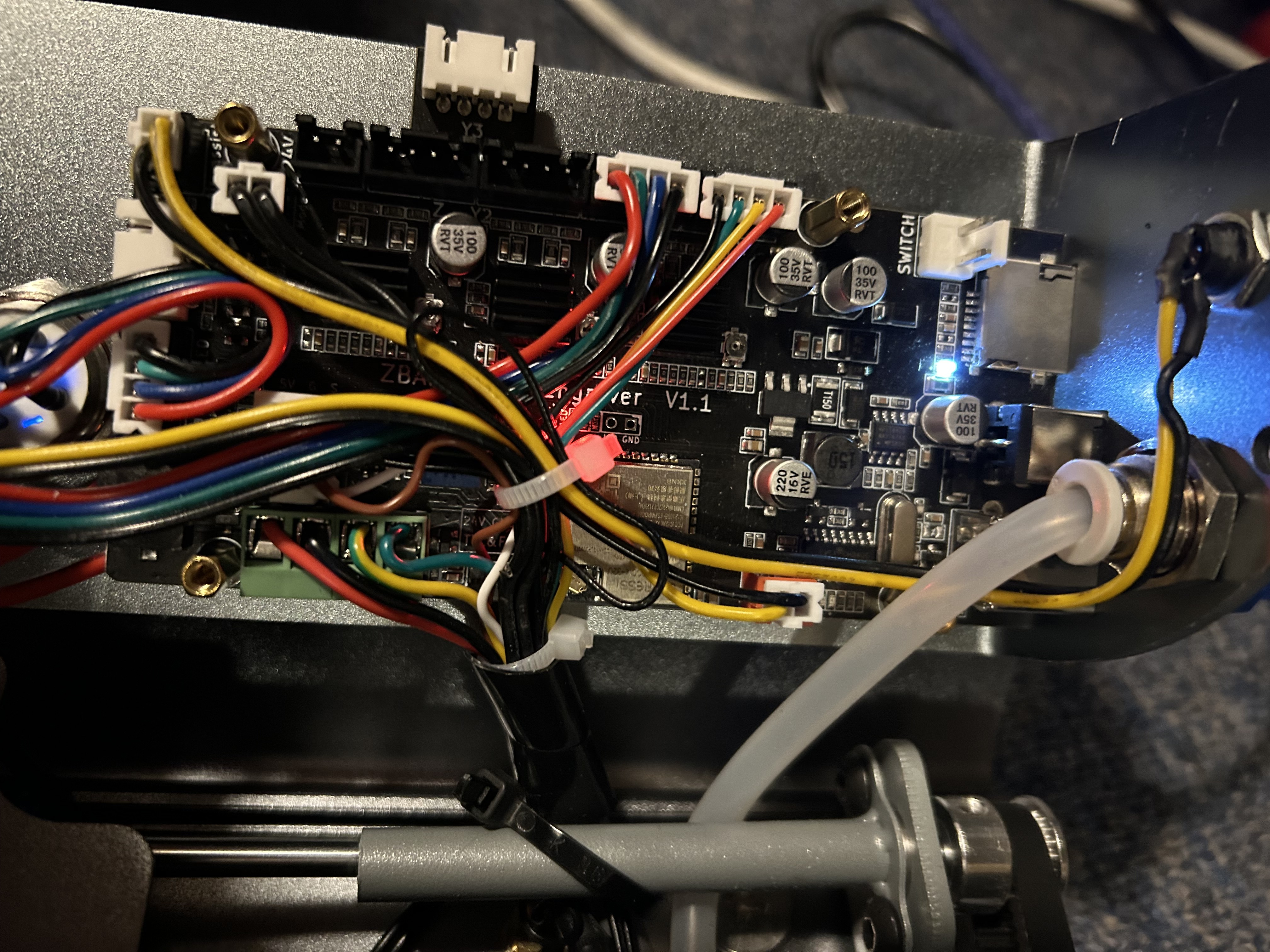

I don’t know what board is this, but is shows as a MKS DLC32 :

yeah I had long conversations with them, they told me the board is a MKS232 but that brings me nowhere… it doesn’t seem to exist
Oh, but they weren’t willing to help, or send a new board if they weren’t able to come up with a fix?
There’s an MKS DLC32. I can’t tell from your picture whether it’s the same board. The first product listing I saw for it explicitly called out supporting both Lightburn and LaserGRBL.
