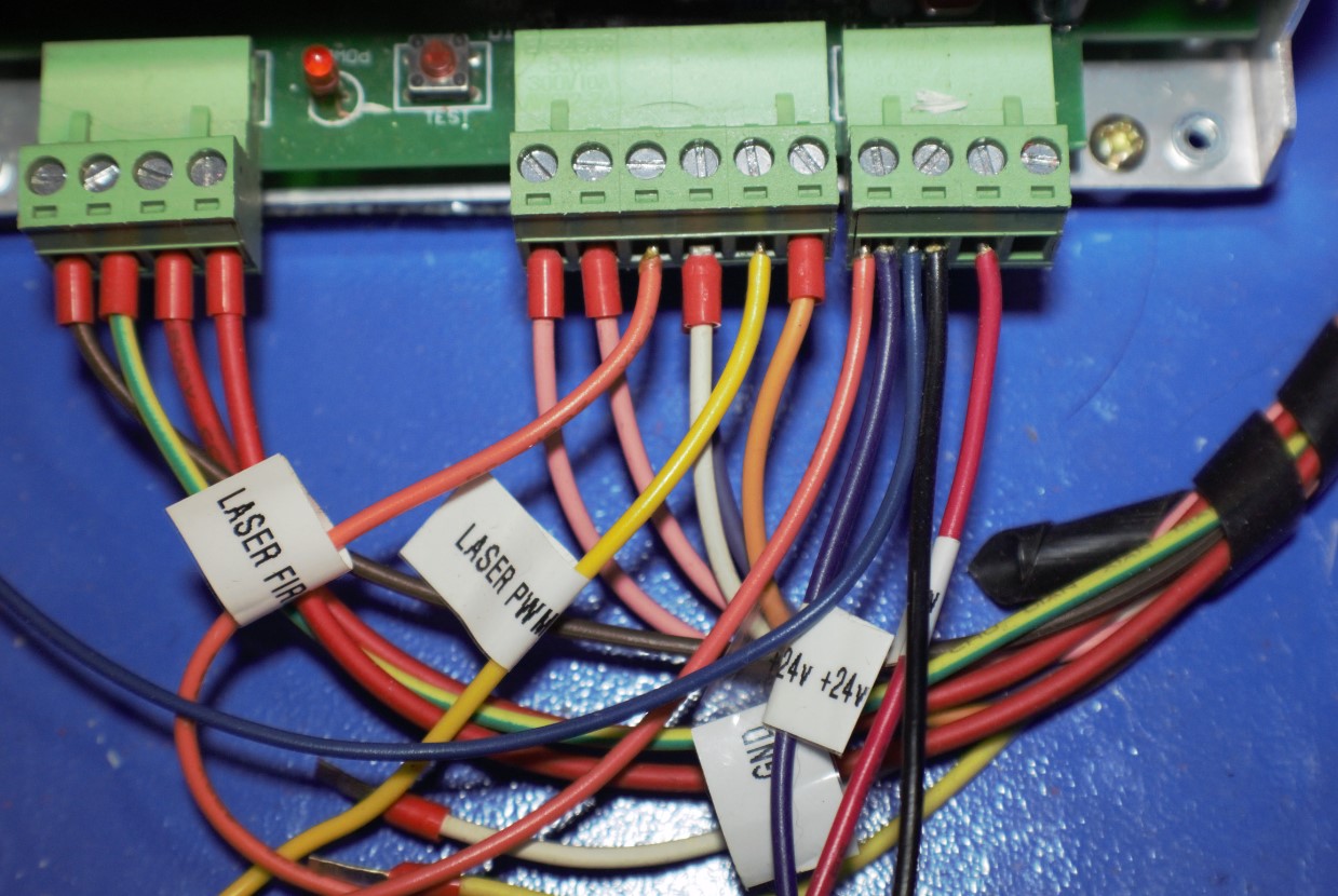

1.1 By the PWM pin do you mean the IN pin?
1.2 What is that pin labeled on your LPS.
1.3 What LPS do you have?
1.4 Please provide a picture of the input connectors on the LPS.

Details on the PS would have helped, sorry for leaving that out. It’s an older PSU, I guess we’d call it type 1, with three green detachable power plugs. Panel is all digital, I put it in myself, took the potentiometer out of the chain so that the Smoothieboard is the only control for the power. I did leave the analog ammeter connected as a manual safety check. PWM is going to the IN port on the PS, the other out is going to the L / laser fire port. Pretty straightforward.

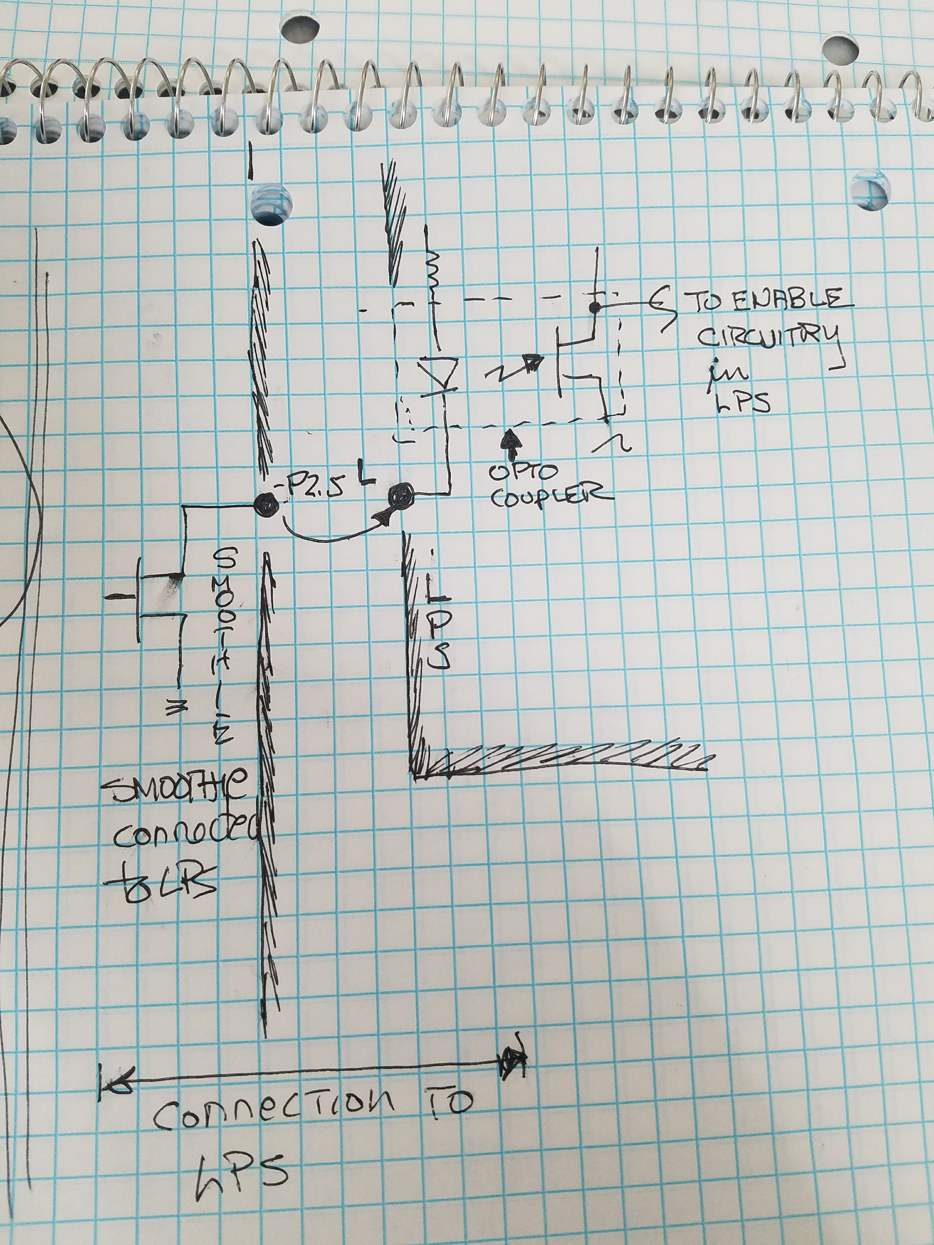

When the smoothie 2.5 pin is connected to the LPS-L pin it is configured as PWM. Therefore the signal on LPS-L is now the PWM and on/off laser control from the controller. The POT voltage is the coarse control of the LPS on the LPS-IN pin.
The OPEN DRAIN configuration provides a ground to the cathode of the LPS-L input optocouplers LED which turns the LED on, turning the laser on. When the LPS-L signal is not asserted (no PWM) the LPS-L = high resistance, the diode, and therefore the laser is off.
Here is a sketch of the circuit.

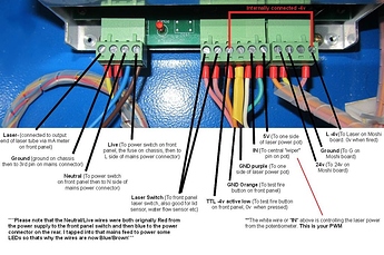

I suddenly realize looking back at your photo that you call what is normally IN = “PWM”.
The IN [your PWM] will set the max power with the pot and the L pin [not connected in your photo] will provide the PWM. The Fire pin is used for interlocks and the Laser Test switch and not used for PWM.*
  • The L pin is the rightmost connection on the rightmost connector.
This is the typical nomenclature for that supply.
