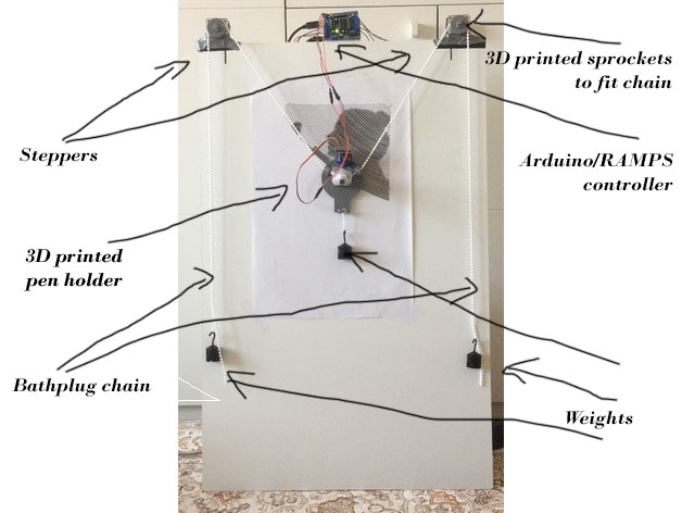

Anyhoo…The computer room which is my teaching area is bland and boring. I’ve done the usual sticking up kids work and tech posters, but there is still something missing. I came across an interesting project called PolarPlot which is essentially a vertical drawing machine, using 2 stepper motors, driven through an Arduino RAMPS setup to make a basic plotter (diagram below). Since I now have a little experience with 3D printers I thought that this was something I could tackle and, better yet, build it on a bare wall in my room. When the kids get bored of me prattling on, they will be able to watch the plotter drawing on the wall :slight_smile:
So, I’ve built the basic machine, using bathplug chain, a couple of Nemo 17s and a few odds and sods, and it is now time to put the controller in place. I had a spare Arduino 2560, so I ordered a RAMPS 1.4 shield, a few A4988 stepper drivers and a cheap LCD display screen. I uploaded the code to the Arduino/Ramps with no issues BUT now comes the problem. When I hook the LCD screen up to the RAMPS board the screen lights up but nothing is displayed. I thought that it might be the code, so I uploaded a copy of Marlin customised for this exact LCD screen (a 12864 clone), but the result was the same.

Diagram of the PolarPlot device
Plotter
