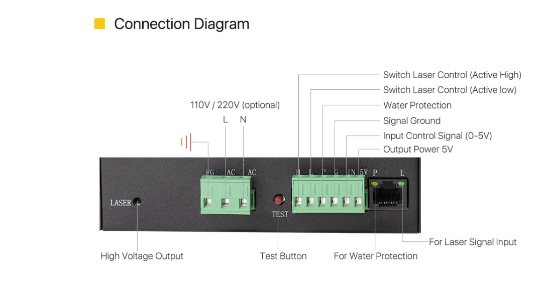

Last issue is connecting the 60W Cloudray Laser Power Supply:
I am using pin 2.4 and ground for PWM control connected per the Smoothieboard laser instructions.
  1. I put a jumper from Power supply “5V” to Power Supply “IN” per the diagram
  2. Power supply “G” is connected to Smoothieboard GND on the same row of pins as pin 2.4
  3. Power supply “G” is also connected to DOOR SWITCH (NO), Estop button (NC), Flow Switch (NO)
  4. Other terminal of the Flow switch is connected to Power Supply “P” (So the door switch, Estop button, Flow Switch are all in series, door must be closed, Estop switch in normal position, and flow switch closed to enable the laser Power Supply)
  5. Power supply “L” is connected to pin 2.4
  6. I have a Laser Fire Test button (NO) Across Laser Power Supply “G” and Laser Power Supply “L”
What happens is, simply when I close the door, the laser fires full power with no command from Lightburn. That tells me that pin 2.4 is LOW and firing the laser. So, I took the wire off the laser power supply “L” that goes to Smoothieboard 2.4. Closed the door, laser did not fire. I pressed the laser fire test button and the laser fired. Which I would expect. I measure the voltage from Laser Power Supply “G” to the wire going to Smoothieboard 2.4 and I measure 3.3VDC, so techincally it is “high” but wondering if not high enough for the laser power supply?

Anyone help out or explain how smoothieboard controls this type of power supply? It appears to me that the IN of the power supply should be modulated using the 5V provided by the power supply. The L could be connected via G on the power supply via a TTL output on Smoothieboard to turn the power supply on or off and I could parallel across L and G with my normally open Test Fire switch.

The L pin of your laser power supply acrivates the laser at a low (GND) signal. So you must use the mosfet output (minus pin) on the smoothieboard (green connector). The mosfets plus pin can stay unconnected, just GND of the LPS must be connected to GND of the Power IN of smoothieboard.The mosfet works like a switch between minus pin on green connector and GND of power in.
Optionally you can use the H pin (activate on high) on the power supply. This could be switched with positive logic level.

You do not need a mosfet. Any pin on Smoothie can be used to control these PSUs. If you want to control them with 5V instead of 3.3V ( which you don’t need to, they work fine at 3.3V ), you can use the pins in open-drain mode ( see the documentation on external drivers ).
Just control IN via one of the PWM pins on Smoothieboard, L or H with one of the non-pwm pins, and tie PSU ground and smoothie ground together, and you are good to go, it’s as simple as that.

What I was trying to explain is, that the L pin wants a inverted signal. 0V means laser on, 5V means laser of. You can invert the signal of pin 2.4 via the ! in the config file (like Arthur wrote), or you can just use the mosfet output, as this does invert the signal too (and works for PWM). The third option is to connect the logic level pin 2.4 to the H connector of the LPS (instead of L).
No way could I get it to work with just the one PWM Pin from Smoothie.
I did get it to work as Art suggested
Cloudray Laser PSU Connections:
IN - Smoothie Pin 2.4 (laser_module_pwm_pin)
G - Smoothie GND. Flow Switch, Door Switch, Estop N/C, Test Fire Switch (NO)
P - Flow Switch, Door Switch, Estop N/C
L - Test Fire Switch (NO)
H - Smoothie Pin 2.13 (switch.laserfire.output_pin)

What no longer works is my TEST fire button which I had connected from Laser PSU “G” to Laser PSU “L”. The Laser PSU Test Switch does not work either. I’m guessing it has to do with no +5VDC source?

Nice, this is the simplest/most straightforward setup, yes.
I suspect the test button doesn’t work because at rest, the IN input is not receiving anything, resulting in a 0-power output.
You can just send something like G2 I1 F1000 S1 which will dram a small circle and turn the laser on for a very short time as it does so.
