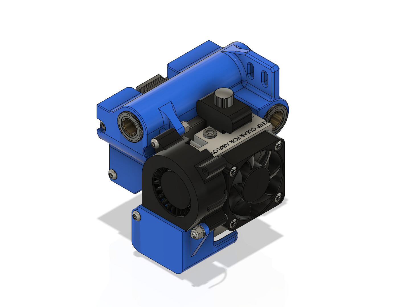

In any case, I’ve been getting a bit sick with the inconsistent bowden extrusion on my printers (When I print 4 perimeters, the inner perimeters under extrude while the outer ones over extrude) so I figured it would be time to start thinking about giving a direct-drive extruder a shot on one of my printers. A brief look through these forums seemed to indicate there wasn’t an available direct drive mod ready-to-go, so I figured I’d have a go at designing my own around the E3D Hemera. @Maxime_Favre seemed to have the beginnings of something similar going, but I don’t think he released anything.
I’ve managed to design a carriage that uses 5 of the 8 mounting points on the Hemera (data sheet says only two are required, though that seems low to me) and fits a 40x40x20 blower. Much of the cooling duct geometry is shamelessly stolen borrowed from the v2.5 carriage.
Some dimensions:
  • Maximum extents in the X direction is 78.5mm
  • Maximum extents in the Y direction is 88mm (excluding the press-fit bearings)
  • The nozzle tip is 55.2 mm below the centerline of the lower cross-rod.
Some pics of the CAD are shown below. This represents about 2 nights of work.
I’d love to get some feedback on possible improvements. I’m sure there are ways to optimize the design, but I think I’ve knocked out all the obvious (to me) stuff.

It looks great! I can’t tell from the images, so please pardon the dumb question: can this be printed without support material?
The main carriage may need a little support to help bridge the gap that I had to make around the motor connector. Otherwise, it should be pretty good. Printability was definitely a requirement of mine when designing.
The cooling duct will definitely require some support. As I mentioned, it’s based on the existing v2.5 design found on Github, so it should be just as easy or difficult to print as that.

The features of the carriage have been dressed up a bit and fasteners added:

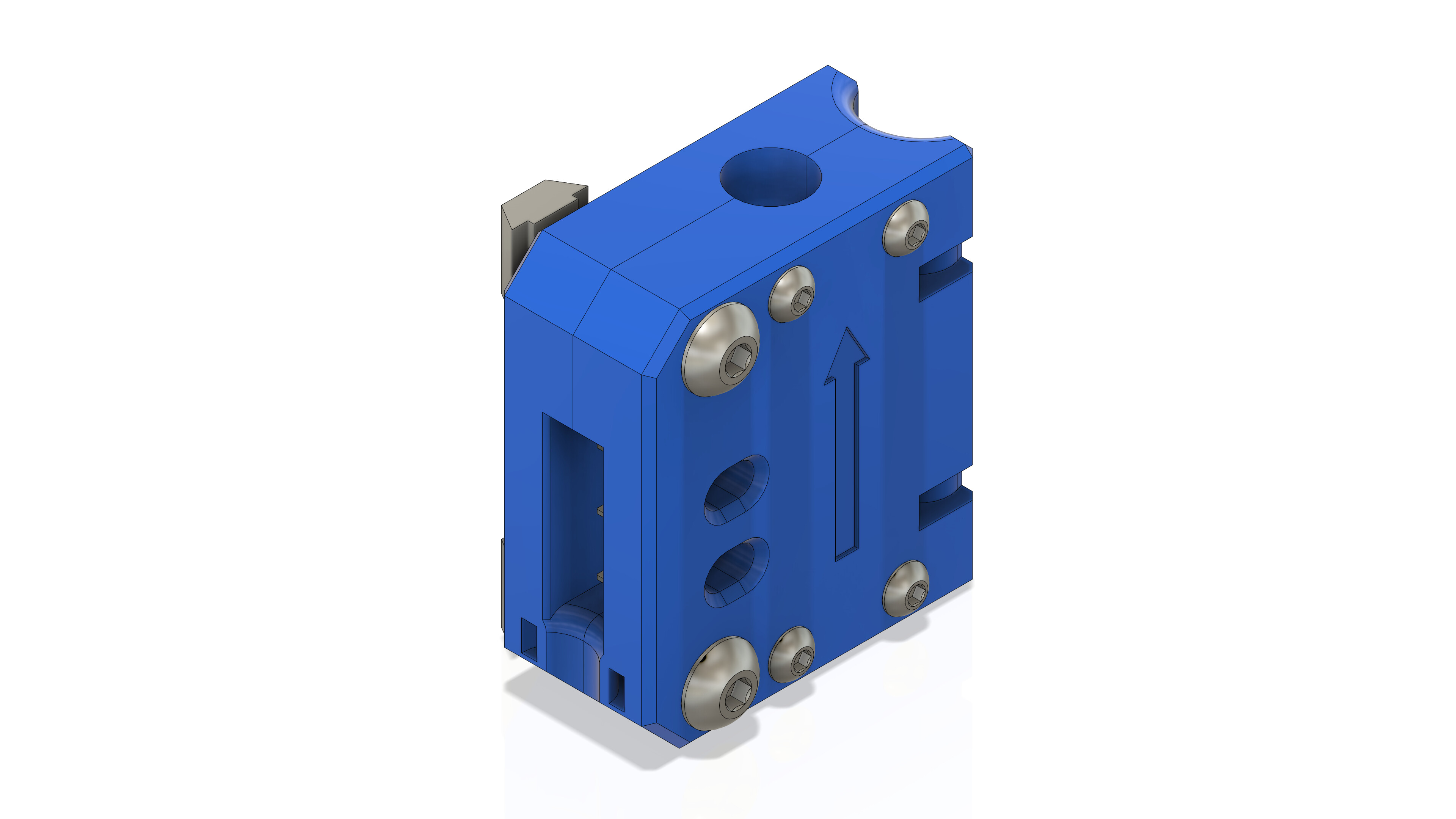

I found some time to figure out the gantry. I wasn’t totally in-love with the existing v2.5 side carriages, so I remodeled them to look a bit more “clean” and, more importantly, to be more easily printed. I did end up sticking with the set-screw design since I couldn’t seem to make a clamping design I liked.
Once I was happy with that, I made offset versions that would attempt the maximize the print area of the new carriage.
The new side carriages do require a much longer screw for belt tightening than the original v2.5 design since I didn’t want to tighten against a heat-set insert. Getting that heat-set insert in that deep pocket would also be quite difficult.
Overall, the gantry looks like this:
I get a theoretical maximum printable area of 289.5mm in X by 279 mm in Y. This may have to be reduced somewhat in X to find room for the end stop switch, and somewhat in Y so I don’t pinch wires going to the extruder on the back of the carriage.
Overall, I’m fairly happy with it. I’m not in a position to build this myself quite yet, but I’m more than happy to release my files in case someone else wants to give it a go. Please let me know if that’s the case.

Since I will still need something on the fixed side to guide the filament, I figured it might be good to make a filament run-out sensor. It’s pretty simple, though maybe a bit over engineered. It is to work with Bowden couplings and of course PTFE tubing, which isn’t pictured. I think it’s pretty obvious where they fit, however.
There are provisions for strain relief for the switch wires, as well as for the wire harness going to the carriage and hot end.
There’s no reason this couldn’t be used in combination with the existing Bowden design, though I think a mirrored version would work better in that case.
