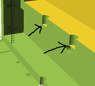

I have confirmed for myself that the hole support works. You start by setting the layer height which will then become the thickness of the support. Where there is to be a hole in a horizontal surface and a void below that makes a bridge necessary (I added this to let me avoid support material), you can use this feature so that the bottom of the hole is a solid layer. Since a picture is worth a thousand words, here is a cut away image. Just ignore the hole in the vertical surface and the hole at the bottom since this hole support option does not effect them. It will also not make sense to use the hole support if you rotate the STL file so that the bottom is no longer the bottom.
hole_support_cut_away
Oh, just not what I’m used to thinking when I see “support” — that’s why I asked. Yes, I see it.
Yeah. “Bridging hole support” is perhaps better wording.
