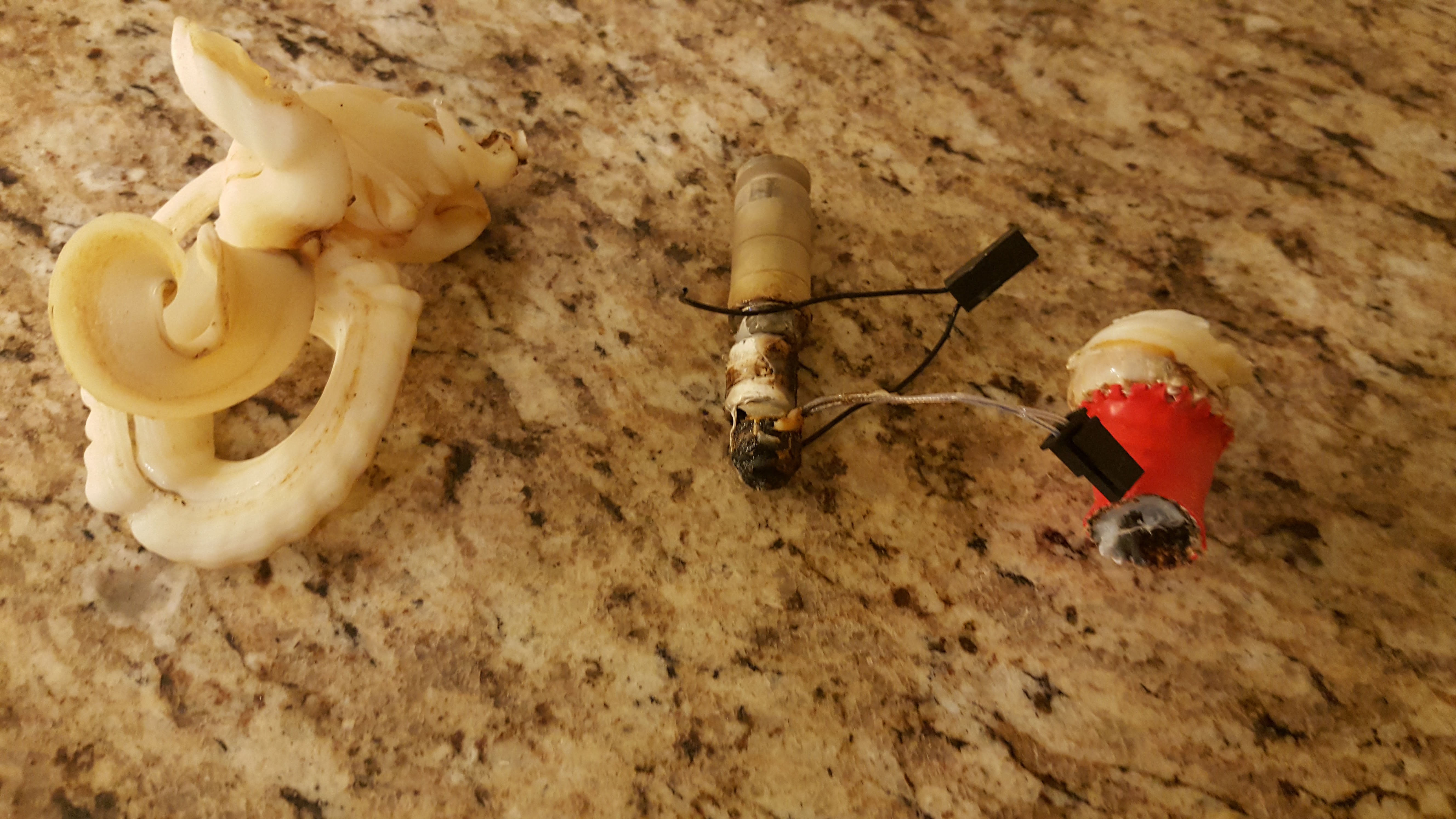

Here's a followup to yesterday's mess.
Here’s a followup to yesterday’s mess. The hot end is probably salvageable but I won’t bother. One thing is for sure, at $75 per hot end I will be looking to use an E3D clone at some point. And calibration is such a pain. I really hate Z probes. Playing with M212 is as much anoain as a Z stop screw but at least I can use a sheet of paper to get Z min right…

(Edited) Printrbot ceramic hotend? What were you printing and at what temp?
Yes, ABS at 225C since at 230C it as making ‘dandruff’ in my prints.
ABS should be printed on a heated bed with glue stick or extra hold hair spray. If you do not have a hetedbed, perhaps ABS juice on a cold bed will work, but I am not sure.
Ouch, blue tape doesn’t work well with ABS. It looks like a hearing aid exploded. I guess glue stick might be worth trying. I would suggest going down to PLA and when you get good at that, look at PETG. ABS just isn’t home-friendly and requires more equipment and practice to do well.
hoped you kept the plastic "its a work of art henry moore would be proud, and gogh ears just striking from randomness…
for $75 you could get every type of clone on the market to experiment with,may have too spend $12 and replace the heatbreak.

@Jeff_DeMaagd ​​​ actually I am familiar with both and have had better success on glass for ABS but the printer has a Z probe so no glass for me. I will likely switch to PLA to accomodate this customer and tell him ABS is buh bye. I tried ABS right on the metal plate (had to recalibrate Z). What a pain. Despite the glue stick it stuck moderately well. PB originally had Kapton which ended up tearing.
@jinx_OI agreed, but the work of art went i to the vertical rectangular filing cabinet
@Aric_Norine I have had success with various kinds of tape including blue tape but yes not for large flat surfaces. I won’t be doing that again. Nonetheless, I am switching to PLA, as it is far more error friendly and I make lots of errors.

Hey, in response to the z-probe. It’s pretty easy to remove the z-probe and install springs under four longer bed-bolts to convert it into manually leveled. I did this a few months ago to my simple metal and have been pretty happy with the results.
