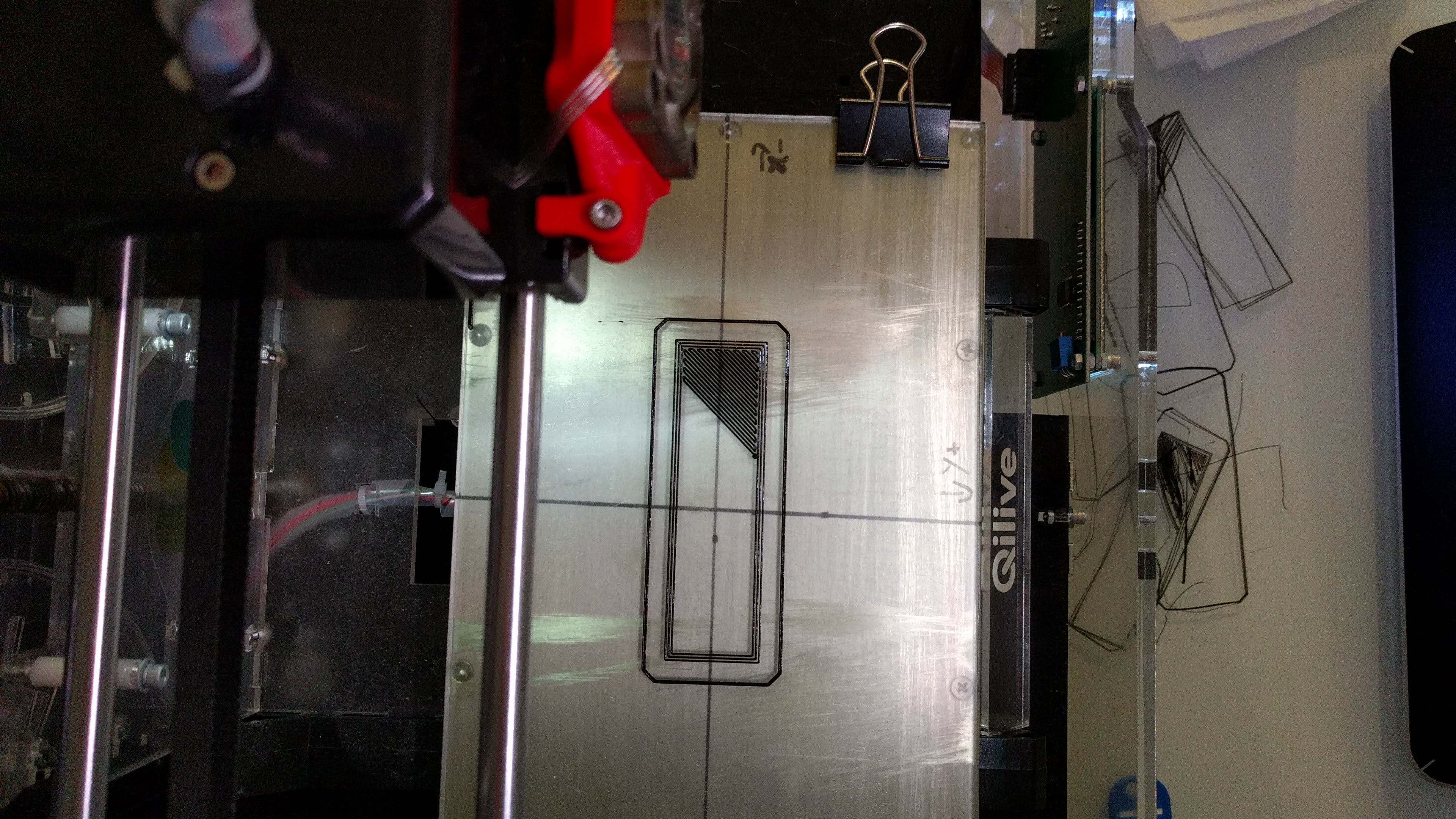

I have a problem. My printer doesn’t wanna close the gaps between the lines on the first layer. I meanwhile tried printing closer to the bed. I am now printing my first layer at 0.2mm.
I also tired bumping the first layer width to 200%
What can I do?
BTW I’ve printed this model inumerous times on my prusa i3 mk2 and it comes out fine.

@Max_Moors Did you stop the print after this? Or did you print it completely? If the rest of the layers look fine it shouldn’t be a problem with the extrusion amount. But if the other layers are also printed with less material as expected, I would suspect filament diameter is on the low side. Can you measure the filament diameter with ia micrometer?

From the picture it looks like underextrusion, though the outline seems to be OK. Also the dot-like looks in the fill suggest a problem with continouous flow of material.
From that I suspect sth in the nozzle interfering with the free flow. I would try a few cold pulls to clean it up and see if that fixes it.
At what speed are you printing? 210′C for PLA is very hot IMHO. So I reverse my suggestion and suggest trying again with 190-195.
@Jan_Wildeboer the dot is there because I stopped it there. But I’ll try a couple of cold pulls and see what happens.

@Marco_Medeiros I’m now printing the model to see if it is under extruding on the normal layers
This is the top layer. Looks like the extrusion multiplier is correct but then the first layer doesn’t look like a good layer due to the separation of the extrusions
