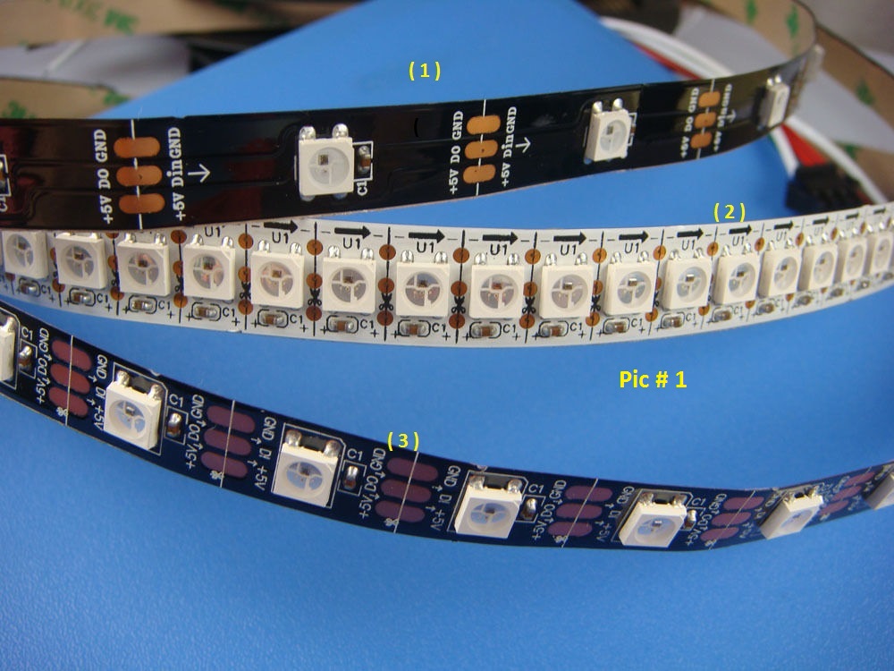

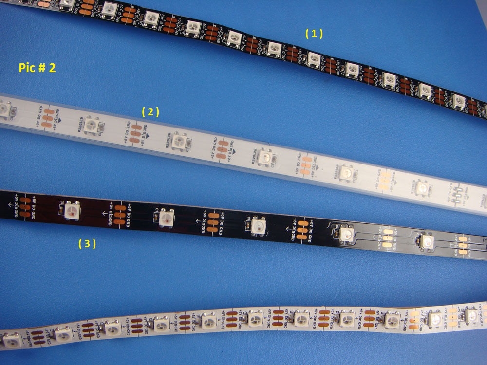

Ok I have attached a few screenshots and links so that you guys can help me pick out the one that best fits what I am looking for. I am getting a bit confused with all these numbers, this is my first time buying one of these and I do not want to mess up. On the links I have a controller, because what I want to do is use these as christmas lights, but to later on upgrade it by adding it to an arduino board.
I am not understanding what they mean by 30,60 and 144.
On the first pic i am looking for either the one on theop or the one on the bottom, in other words, the black ones. But I am looking for 16ft of this. I prefer the one on the bottom, which is the 60 i believe, according to what they are saying. But can I get this in 16ft? Please I hope someone can help me out by telling me which is the one I should order. thank you in advance for your help!
The 30, 60 and 144 numbers you are seeing refer to how many LEDs per meter are installed on the strip…144 LEDs per meter―like in pic #1 (2)―is quite dense.
Usually, you can buy the individually addressable LED strips in 1 meter or 5 meter increments…but you can always join more together, though you may have to inject power at more than just the head of the strip if you have a lot of LEDs.
For Arduino control with the FastLED library, some of the most commonly used strips use ws2811, ws2812, or ws2812B chips. These are easy to set up and get blinking. Look for one of these numbers when buying.

Well, 5 meters works out to 16.4042 feet…so if you buy a 5 meter reel, that’s pretty close.

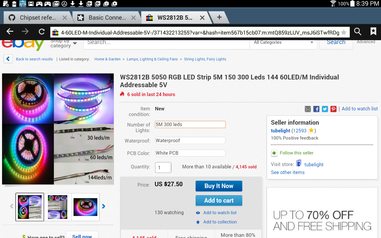

@Chad_Eby ok so you think this is my best bet . My wife says this is the one. Is she correct? Because I need 4 rolls http://www.ebay.com/itm/WS2812B-5050-RGB-LED-Strip-5M-150-300-Leds-144-60LED-M-Individual-Addressable-5V-/371432213255?var=&hash=item567b15cb07:m:mtQ859zLUV_msJ6iSTwfRDg
But did you say Christmas lights?
