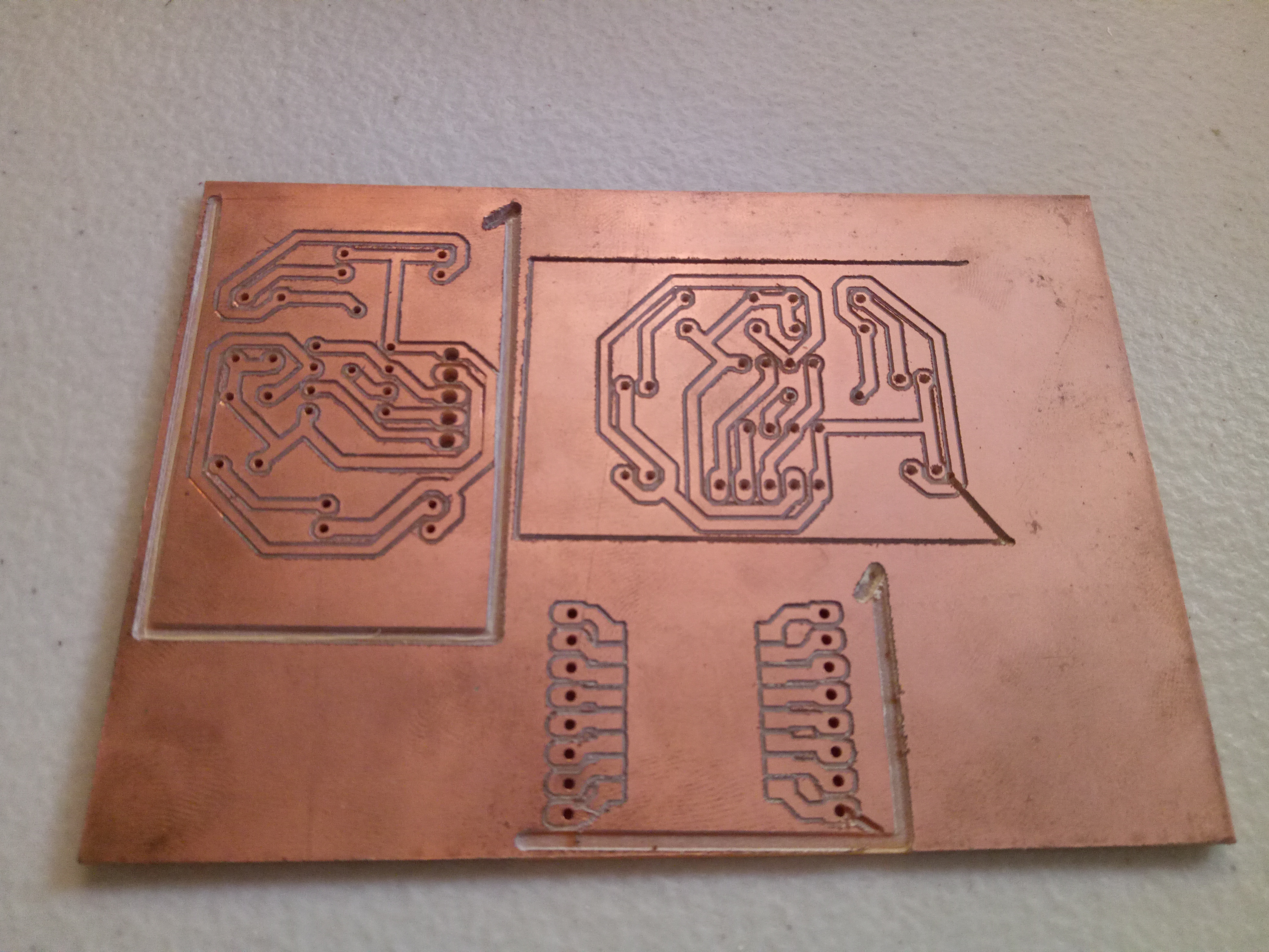

Hi everyone. Thirst thing I wanted to thank everyone how created and participated in the development of chilipeppr. I finally got a small CNC specifically for making PCB. It is working fine so far and below there is a photo of my first few PCBs. As you can probably see I’m having a problem when it cuts the outline of the board. It gets to the top right corner and decides to come across diagonally cutting straight through the traces. Has anyone got any idea of what I’m doing wrong. When I run the simulation it doesn’t do that. Thanks a lot for any hepl

Most probably this is a hardware issue, it seems that your machine is skipping while moving to the left when milling in full board depth.
Try cutting outline in 2 or 4 steps.
It’s clear that your tools are dull or you are not using the right speed & feed rates.
@andrea_buono Does the outline look OK in the 3D viewer? Maybe you could post a screenshot or share gcode file?
I had similar problem with outline path in the past after dragging BRD file onto Chilipeppr (there was a post about it) but all works fine now.
I don’t think this is a loosing steps related issue, as milled traces are not distorted and the outline line is straight, just wrong direction = improper coordinates in the gcode file.

Thanks for the reply. I ran a few more tests changing different settings but no difference. I however managed to solve the problem by using the milling layer in eagle for the outline. This worked with no problems. Might be a coincidence but not sure. I’ll run a few more tests and try to find out what the issue is.

Gcode look good in 3D Viewer, I suspect that your controller is not interpreting curves correctly, can you try board dimensions without curves?
Yeah that looks like a g2/g3 arc issue.
I recall there was some limitation in GRBL in line length or number of digits, but I don’t remember what it is exactly.
Also, I noticed that some small numbers are in scientific format like the following line:
G3 X2.8398 Y-0.5 I3.3398000000000003 J4.440892098500626e-16
I don’t know if this is considered a valid gcode!
Those numbers are so long that I have heard folks have problems. I tend to go max 3 digits on decimals. That’s likely the problem.
I tried straight lines in the past and it also had problems some times.
Do I get such high decimal places because of the grid size in eagle or am I doing something else wrong?
The widget code needs to just limit the decimal places as Javascript handles those decimals fine, but Grbl does not.
I’ll fix that shortly.
