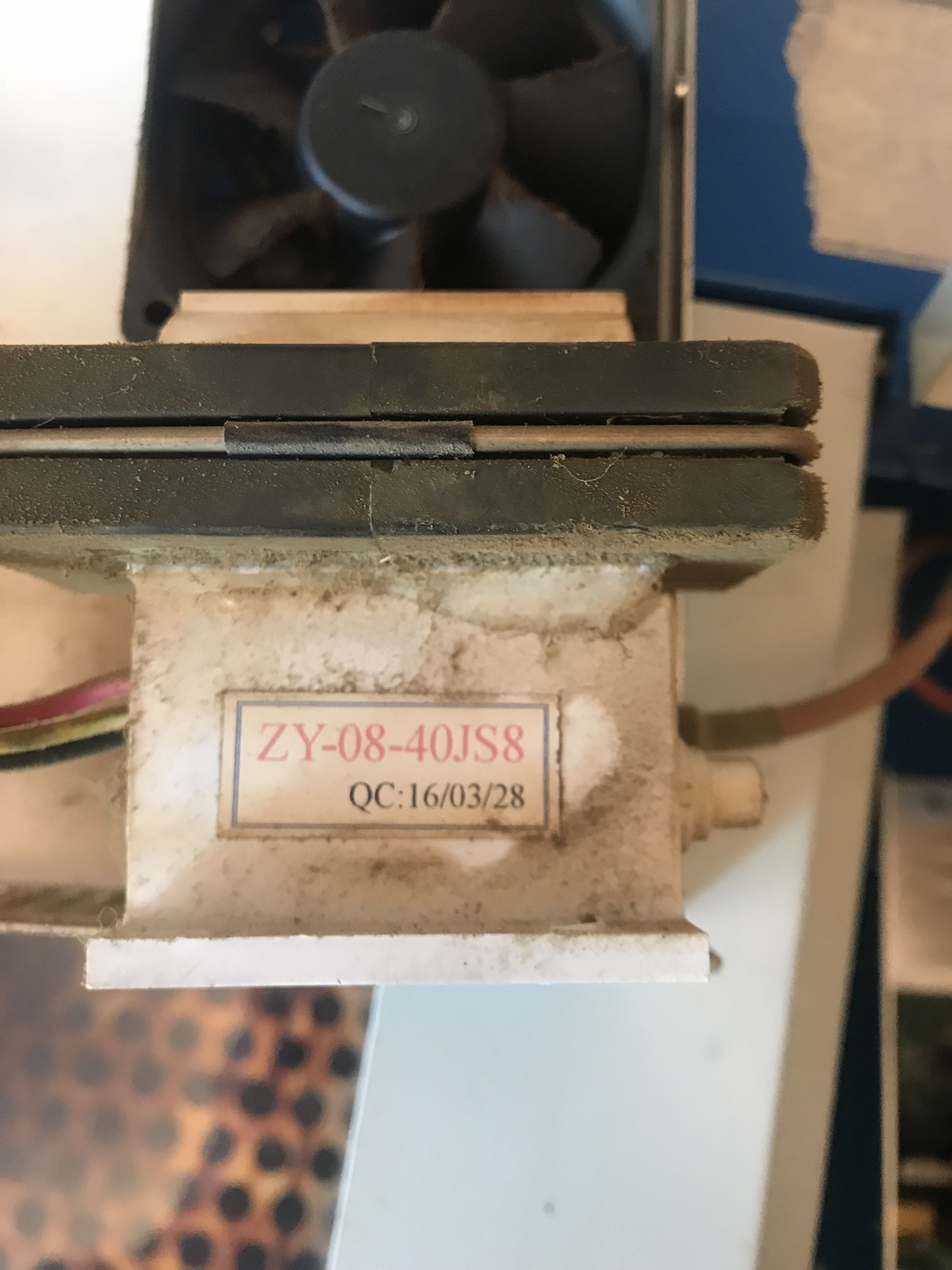

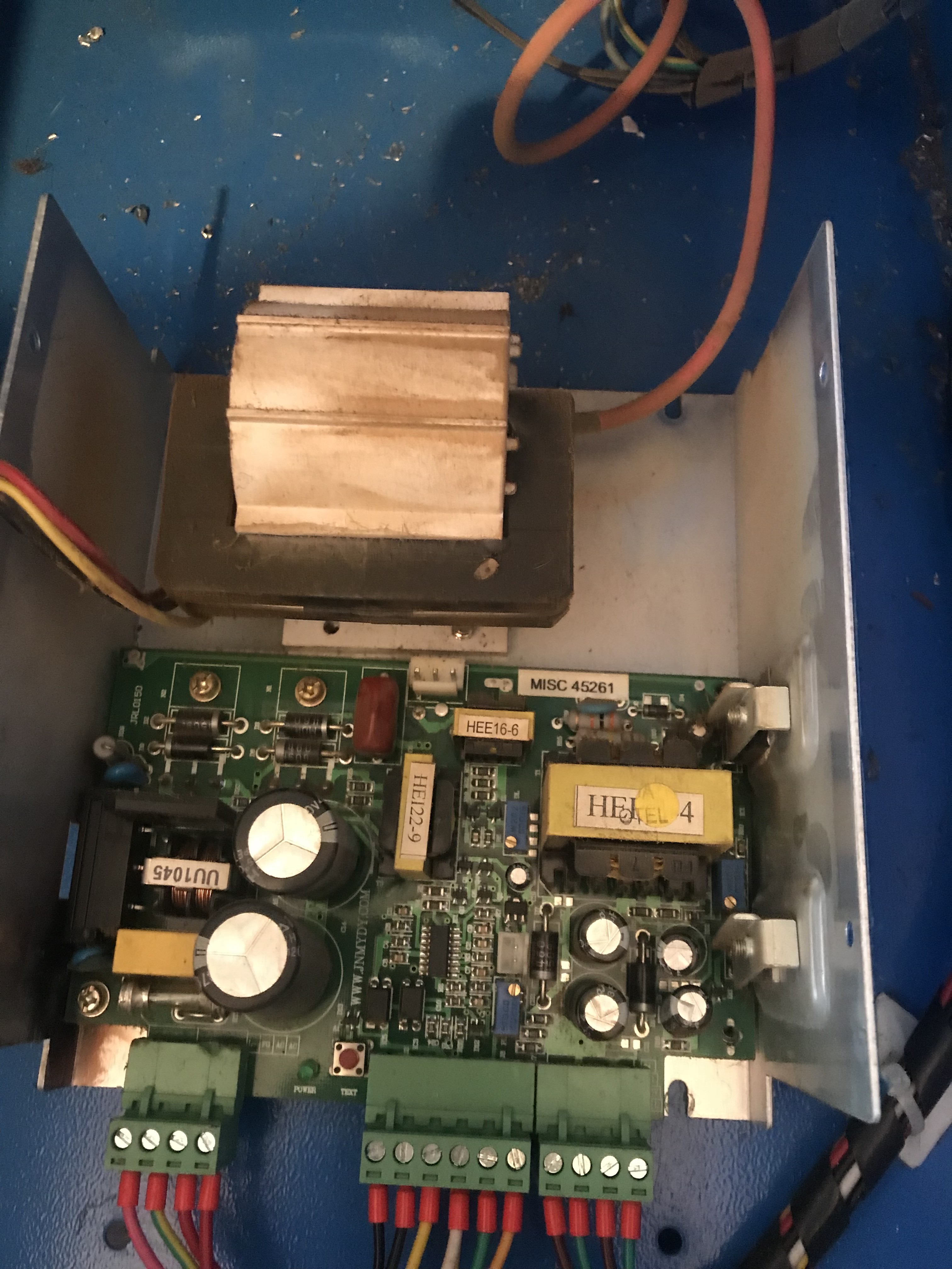

Post a picture of your supply showing the green connectors when you can.

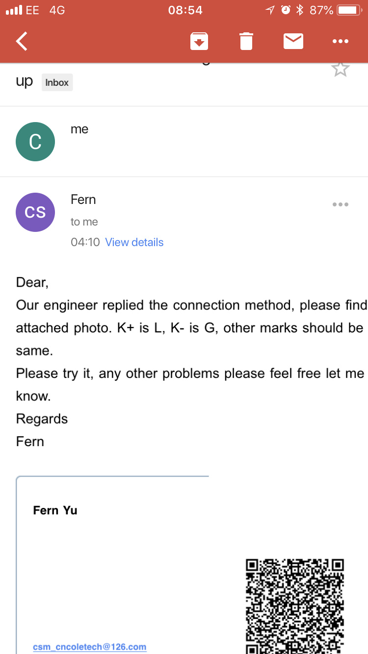

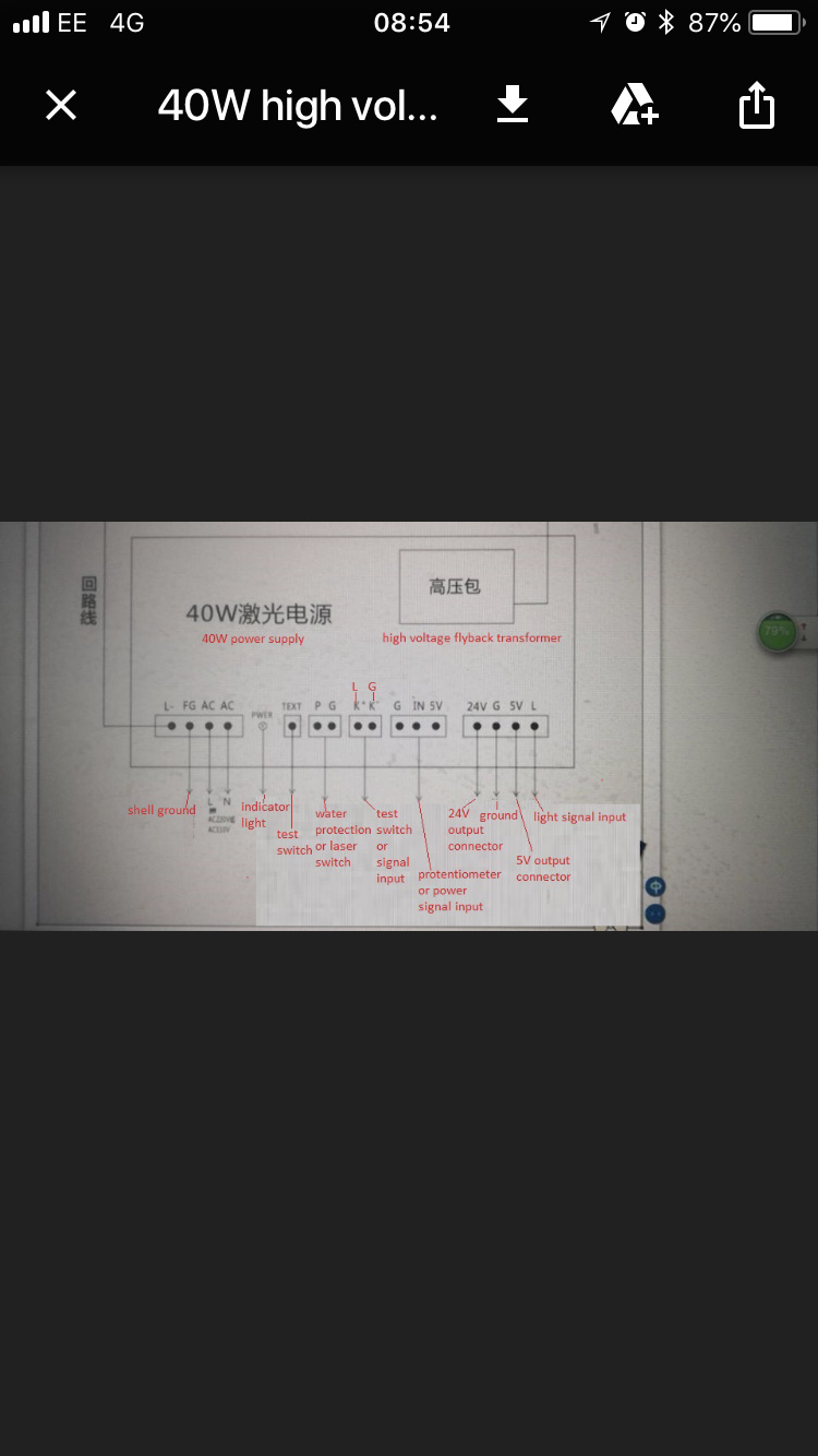

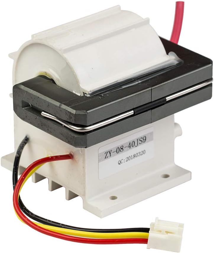

Hey guys update on this fly back, it’s finally arrived but appears to be the wrong one but the seller says it will fit and sent me wiring instructions which I’m trying to get my head round or you guys may have experience with this and may say yay or na don’t do it? Not sure anyway pics to follow

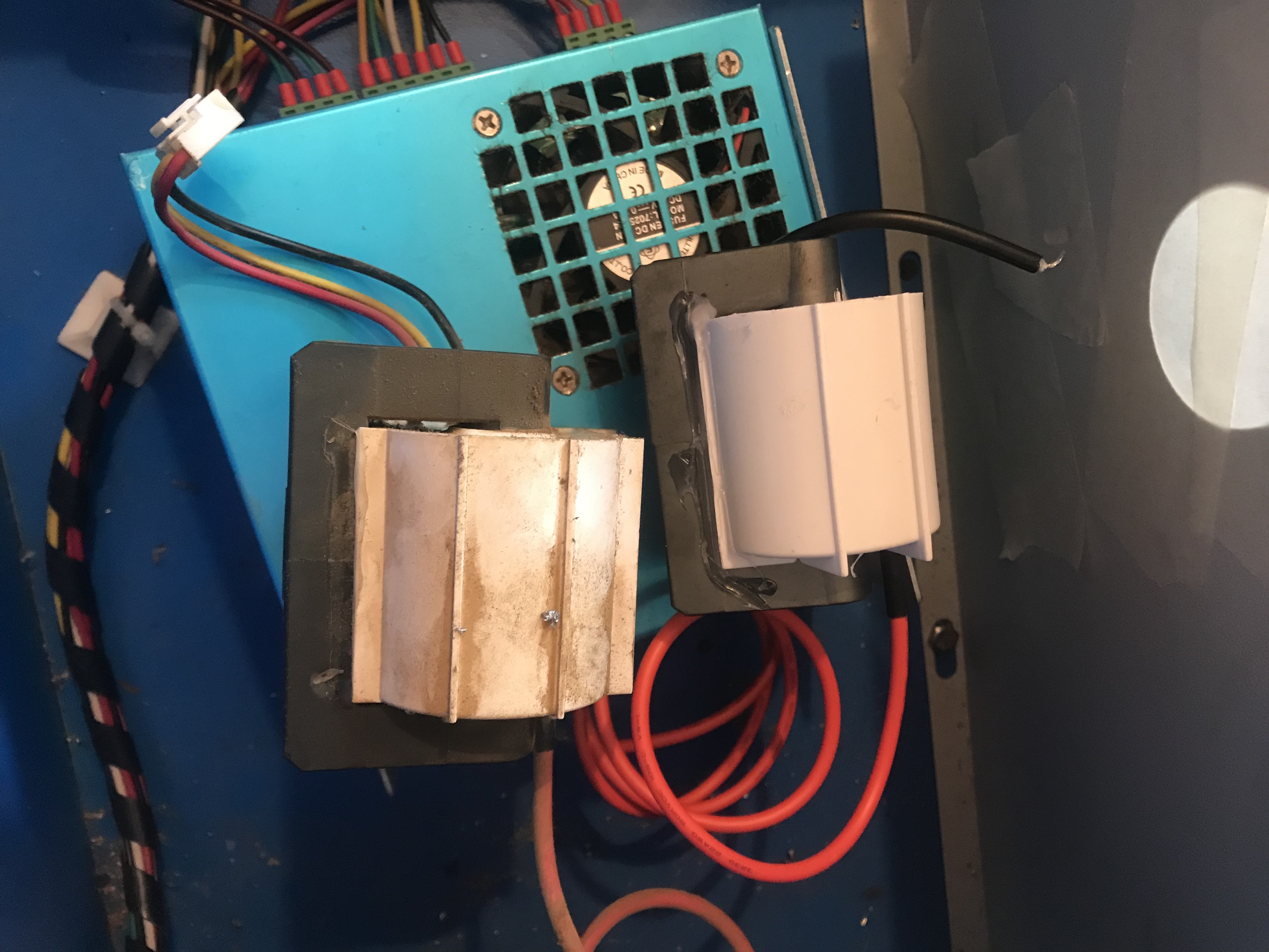

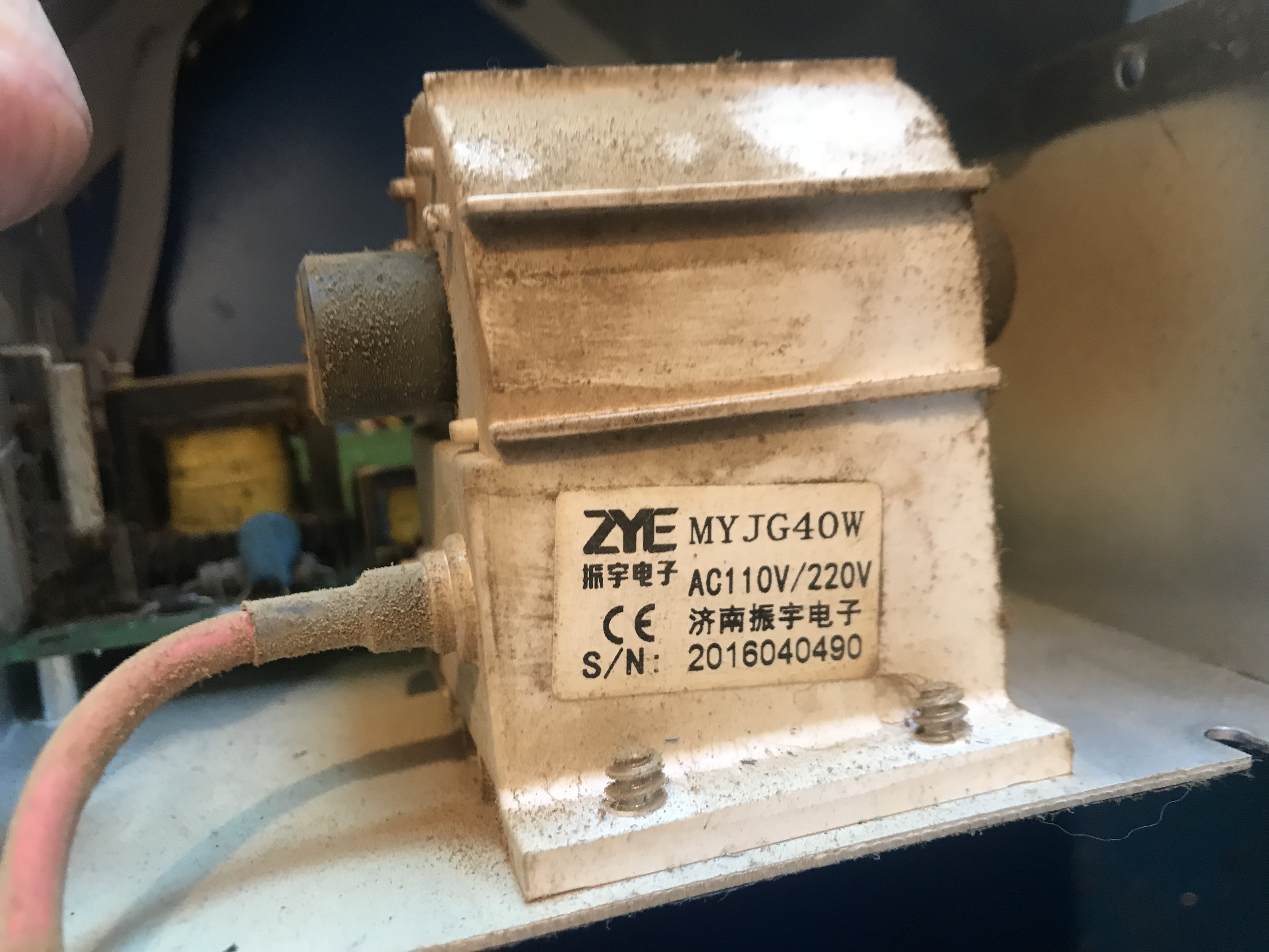

The top picture is new and old fly back as you can see mine has 3 wires with a plug which I ordered and they sent me the new one which has one wire and no plug
