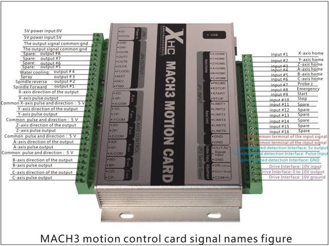

I have an old XHC MACH3 MOTION CARD maybe 1st generation (black on the top)
I not find the drivers for this card (plugins for MACH3, xml, NCusbPod.dll…)
Someone can help me?

It’s likely they kept the same USB drivers for their whole range. It’s not something you would change from a working design. Try the later model drivers. The other thing you can do is to get the USB descriptor from windows device manager - that will tell you the make and model of the USB interface chip.
Have you plugged it in and seen if it is identified? Looking around on the net, if you don’t find any info on a driver, it’s usually because it’s a common interface and doesn’t need one.

@Mike_Thornbury that’s what I thought but it was not working correctly so I opened the Readme file and it was write that the old cards are not supported. After 2days looking for it in Google I got the driver from a Chinese cnc manufacturer. I still have some problems with Mach3, I success to move all axes but I not get the reading in Mach3. When I try to home the machine after to home z axe the machine stop. Thanks for your help.

Have you gotten the USB id from the controller?
The fact that you are moving an axis, even if it stops, says there is connectivity between the computer and the controller.
More info would help: What OS are you running? Does Mach correctly identify the device? Can you issue basic commands to the device? Have you gone through the (rather laborious) setup for the card in Mach? Is there any indication of why your Z-axis move stopped (like a tripped end stop?), do you have end-stops installed and are they NO or NC?
