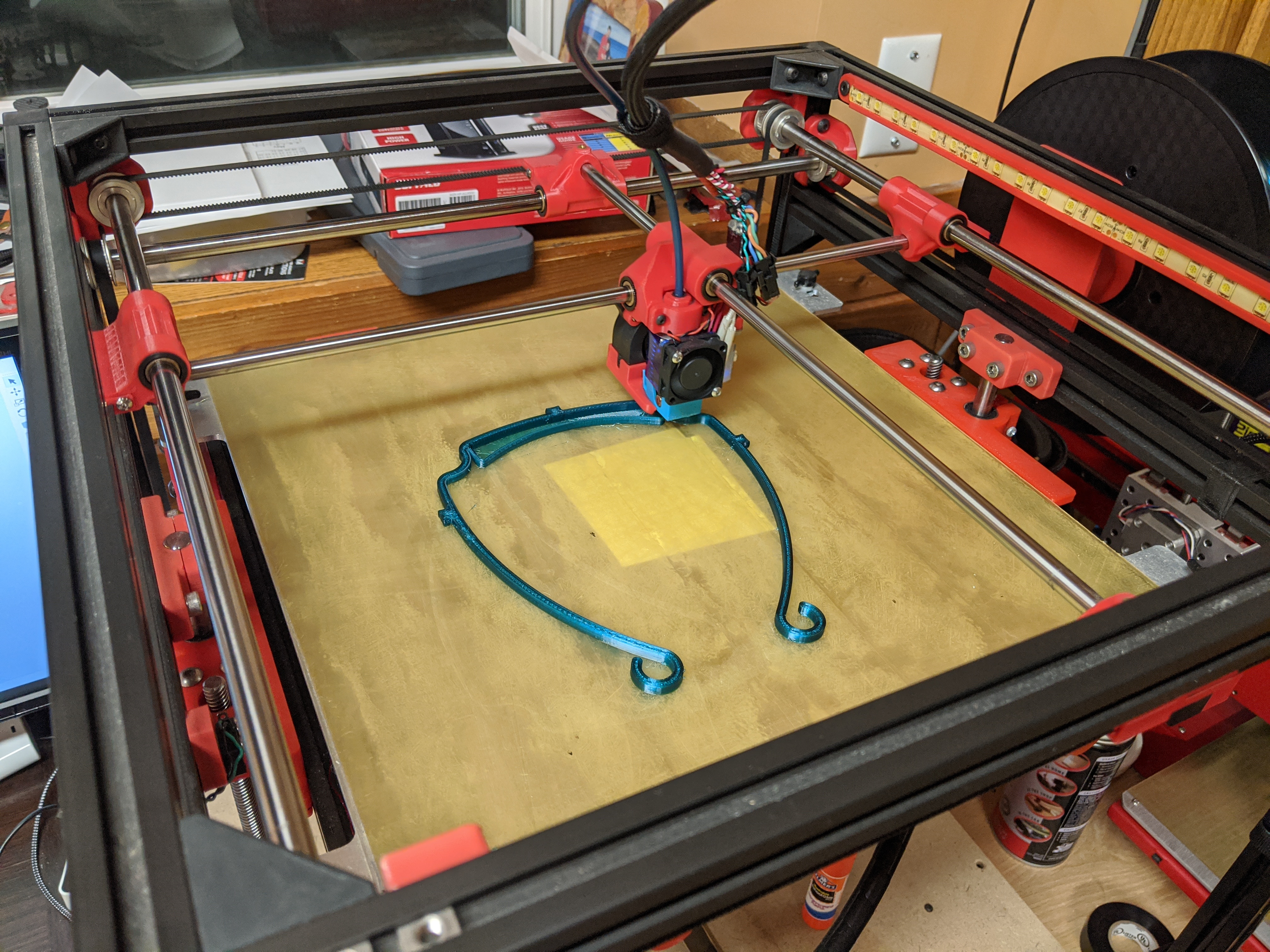

Hello John, the bill of materials would still get you close, but the things that have been upgraded are several of the printable parts which are in the community upgrades folder. Also the firmware and electronics are a bit out of date. Currently I’m using an SKR version 1.3, but an SKR version 1.4 would be a good choice. A standard rep wrap discount full graphics LCD or one of the many touch screens would be a good option. And I’m currently running a BL touch on one of the upgraded carriages. I also recommend using the new side carriages which are a modification of the ones designed by Zane Baird. My printer is currently producing a whole bunch of the face shields and working well. The last thing I would probably do is use the TR8-8 lead screws instead of the more expensive and stiffer misumi lead screws. It allows for faster z movement and is cheaper.

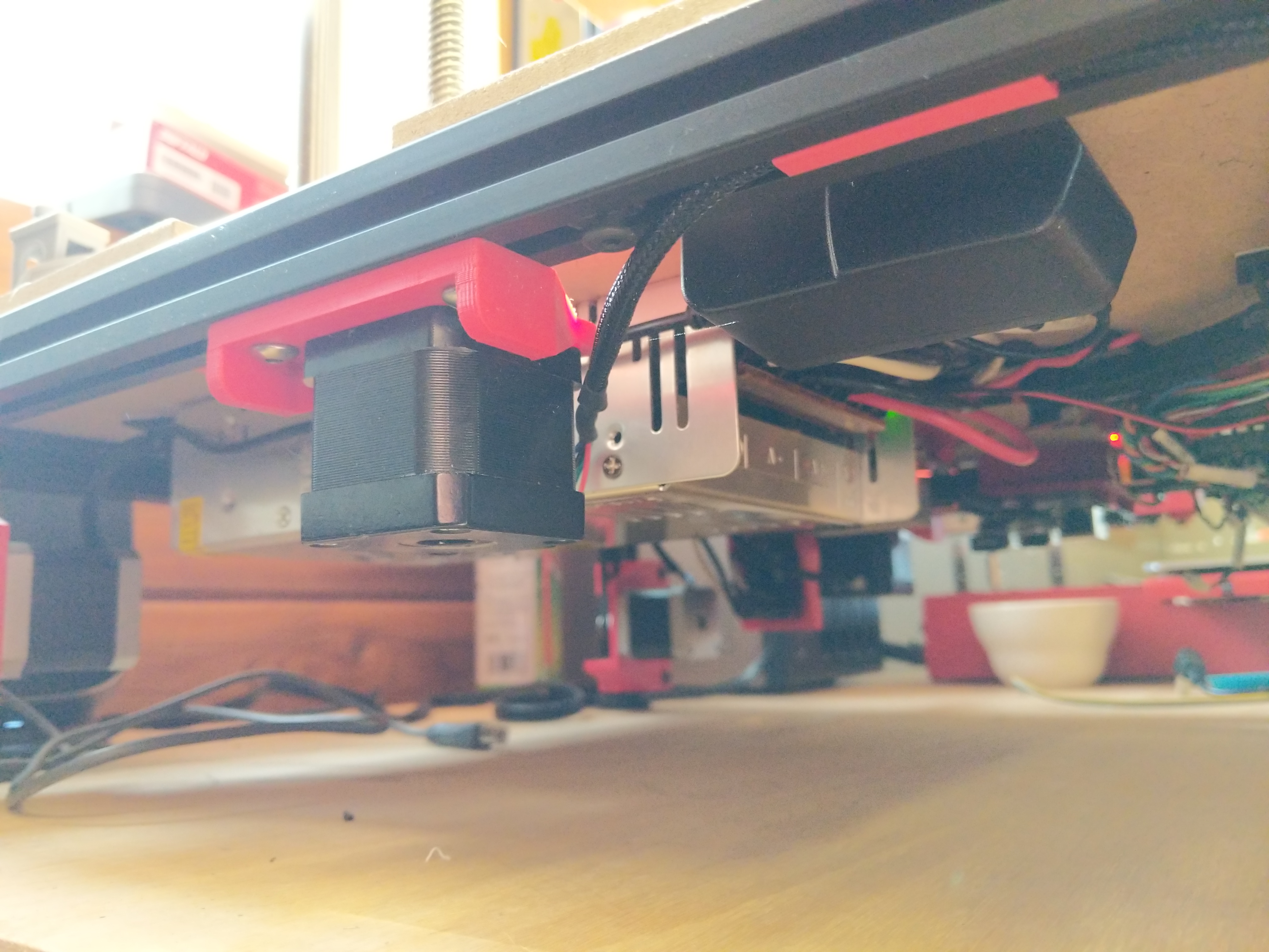

As you can see I’m actually using two integrated lead screw stepper motors on z now just to have no belts running underneath the bottom side. It does mean they have the possibility of getting out of alignment, but if they do I just run it down to the bottom and bump off. Then rehome and everything is trammed back. and using the BL touch means I don’t have to worry if things are slightly out of alignment left to right.

I do like the two lead screws with it integrated motors. And Marlin now has the ability to use a BL touch or probe and run those two motors independently to automatically tram the bed. You use one of the stepper motors on extruder2 to port on the board. You need one extra stepper driver (rather than running the two motors in parallel) but it’s a pretty small cost for a nice benefit.
