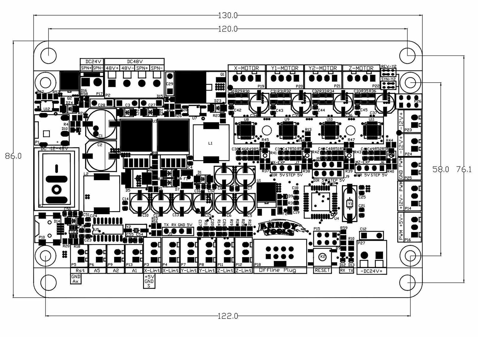

OK, here’s a few pix of the control card.
I suspect you’re right - the driver MOSFET shorted out. There is a large device right
next to the DC connectors for the spindle - “KIA3510A”. A quick search verifies
that it’s an N Channel MOSFET.
Exactly one listing on Ebay for such. I do have an SMD hot air rework station… wouldn’t
be THAT hard to unsolder it. I’d have to be careful not to melt the plastic connector shroud
right next to it. OK, 5 of those are on order.

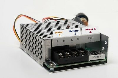

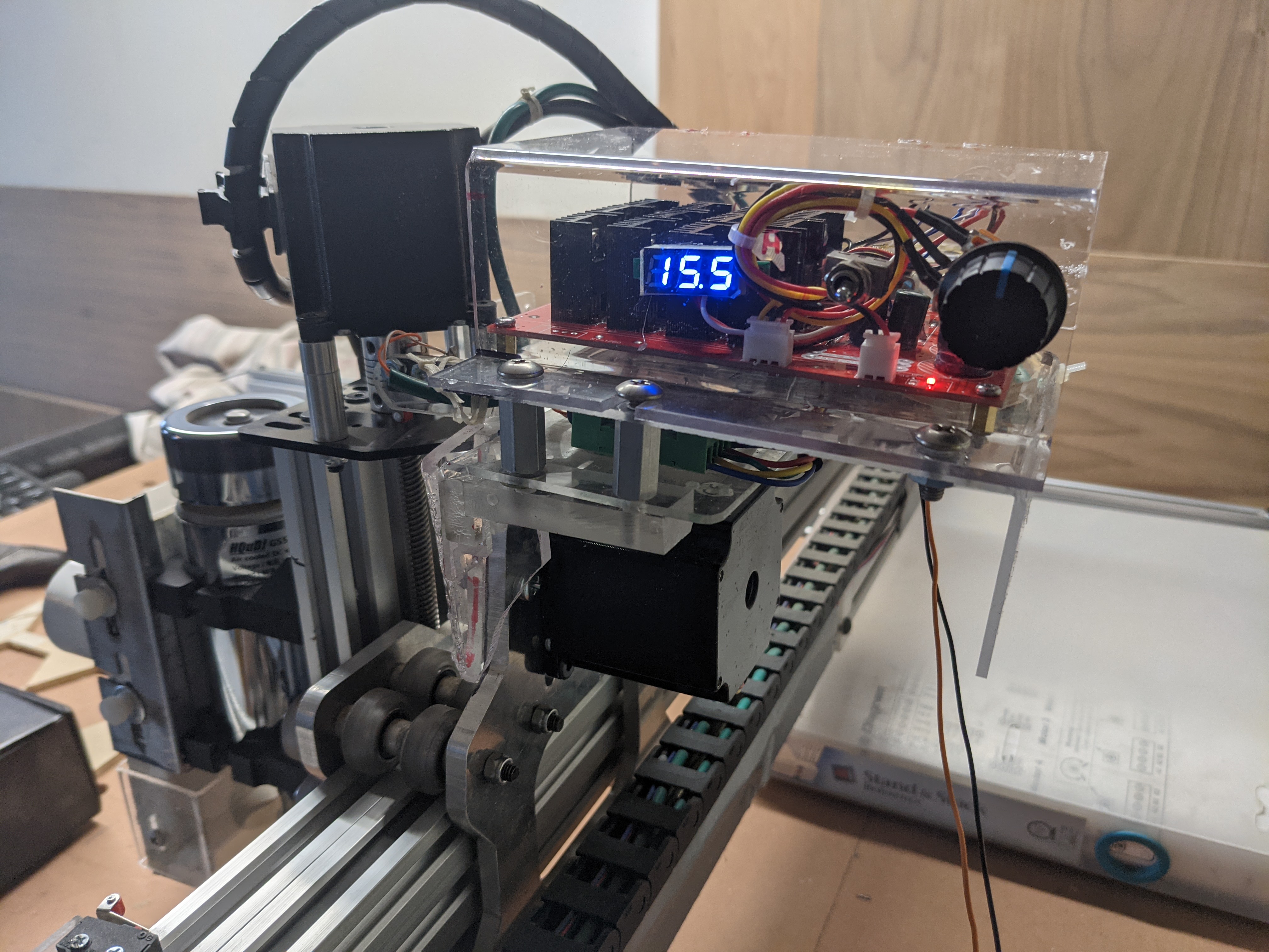

This is a photo of my 48V DC spindle motor driver as an example. I modified it from a china-made unit and it features PWM and manual control with a DVM to monitor motor voltage.

Apparently, there are now a few GRBL boards that control 48V spindles directly. This is one of those. Here is an Ebay link to the identical board:
Note in the specs:
    Power Supply: DC12-48V
    Spindle:48V  0-500W
I think the Chinese CNC manufacturers needed a board like this so they could market 500W machines. It’s clearly minimal compared to your unit.
That’s a new one for me :). $34 controller and built-in spindle drive.

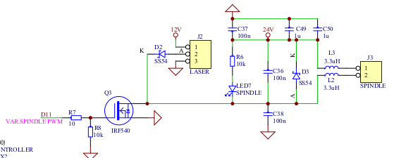

Probably much like my Woodpecker 3018. Here is the driving circuit for both the laser and the motor control.
pwm-woodpecker-3.2
I have a 500 watt spindle on one of mine, but it uses up to 100 volts and I vary it’s input via a pwm to voltage converter.
Even if the device can handle it, it’s assumed a good heat sink, which isn’t on these boards… Most of these boards are 1 oz copper and the width for 500mA is rather wide… I’m surprised at a 5 amp ability, that sounds more like the actual connector.
I’ve used the irl520 for many switching application, including to switch inductive loads. It’s reverse diode is good to 35 amps pulsed. I have not used snub diodes since these mosfets have had the reverse diode on them…
It’s all relative…correct? :crazy_face:
:smiley_cat:
I assume this schematic is the drive section on the controller board?

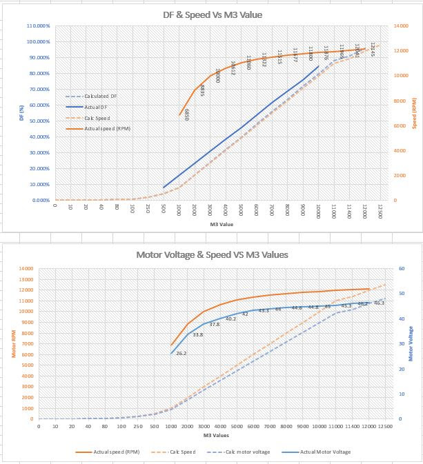

I would be interested in the fidelity of your programmed vs actual DF.
What I mean is if you program the PWM to be 50%DF what is the actual drives DF.
I have found that it can be quite far off due to switching delays etc in the driver.
I have tried multiple MOSFETS and gate driving schemes including push-pull.
I have never pinpointed why the MOSFET will not switch on/off in a reasonable time. I suspect some kind of DV/DT condition that keeps the gate on.
The reason this is a problem is if you are setting speed in a CAD program the actual spindle runs way too fast because the driver is not turning the motor on/off at the right DF associated with the M3 value. This ended up being a problem because when cutting wood the chip loads were wrong due to excessive speed.
I finally just built a graph and consider the error when I program the speed in Fusion. I don’t like this because it is hacking the speed in Fusion just to make the ugly driver work.
This is an example from a RIO-Rand (Chinese) driver. My newest one is better but still too much error.
