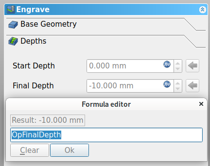

You can choose “Clear” and set it to, say, -2mm
But I don’t know what you intended. It’s following the outline. it’s not doing a variable-depth v-carve; it’s just tracing the outline of the font at the selected depth.
You can change to “Use existing solid” and select the sign body. That way, when you run the simulator using the Path_Simulator button or typing the “PM” shortcut, you won’t have stock obscuring what is happening.
Watch the bit as it traces out the lines.
Select just the Engrave OP and then the Path_Inspect button (“PI” shortcut) and you’ll see that your selected Z is chosen. For example, I set it to -1, and get this:

Where’s the “clear” button? How do you get to that formula editor? When I choose “Depths”, I get a display with the depths grayed out, and I cannot change them. This is BTW Freecad 0.20. As to “what I’m trying to do” - just trying to get to know the tools. I plan to mess around first with the simulator, then with scraps of plywood or MDF.
You can either click on the round blue f(x) button at the right end of the entry box, or just type = — there, you can type your own equations, or just clear it to make it no longer an equation.

I deleted the file and started over. And this time, it just worked. First I tried with a simpler “block print” font. Got a nice big G-code file. Then tried the fancy font again…another big G-code file. Your hint about deleting each “formula” and typing in a number for the depths worked fine.
