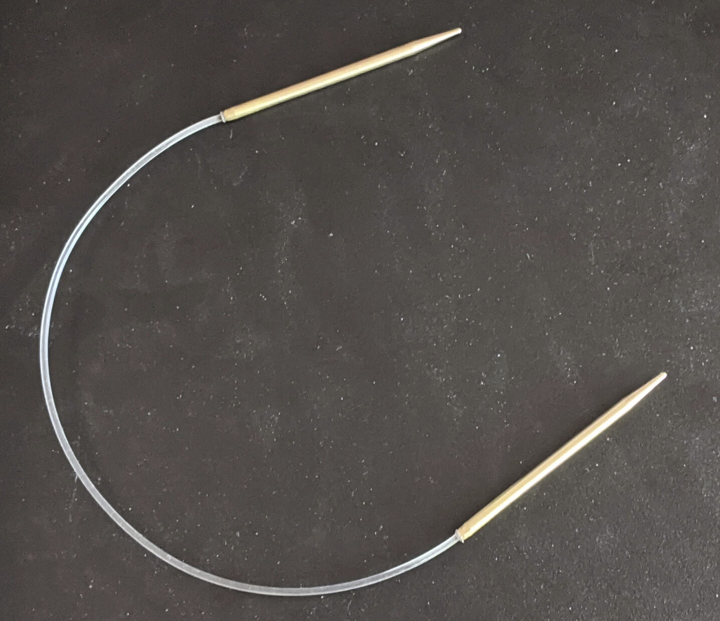

I was informed by the household knitters that there were no #4 (3.5mm) circular knitting needles in the house, yet a set was required for me to eventually wear a hand-knit wool hat. Since I have a few pieces of ¼" brass stock and some nylon filament, this sounded like a fun lathe challenge. I used a sharp brass tool with no back rake and minimal relief.
Since I succeeded, here’s my recipe.

Install the filament as the circ cable:
- Cut at least 26cm of 1.75mm filament. Use a tough smooth plastic. I used nylon; PETG is probably also appropriate
- For each needle, insert the filament, then hold it in a torch flame.
- Use the smallest flame you can manage.
- Put the tip of the flame 1cm from the end so that it is heating up at the base of the hole.
- Push in gently on the filament while heating. As soon as the filament starts to melt, immediately remove the needle from the flame.
- Hold the needle and filament straight while cooling.
- If a bead of melted filament forms outside the hole, trim carefully with a sharp blade, but do not nick the body of the filament
