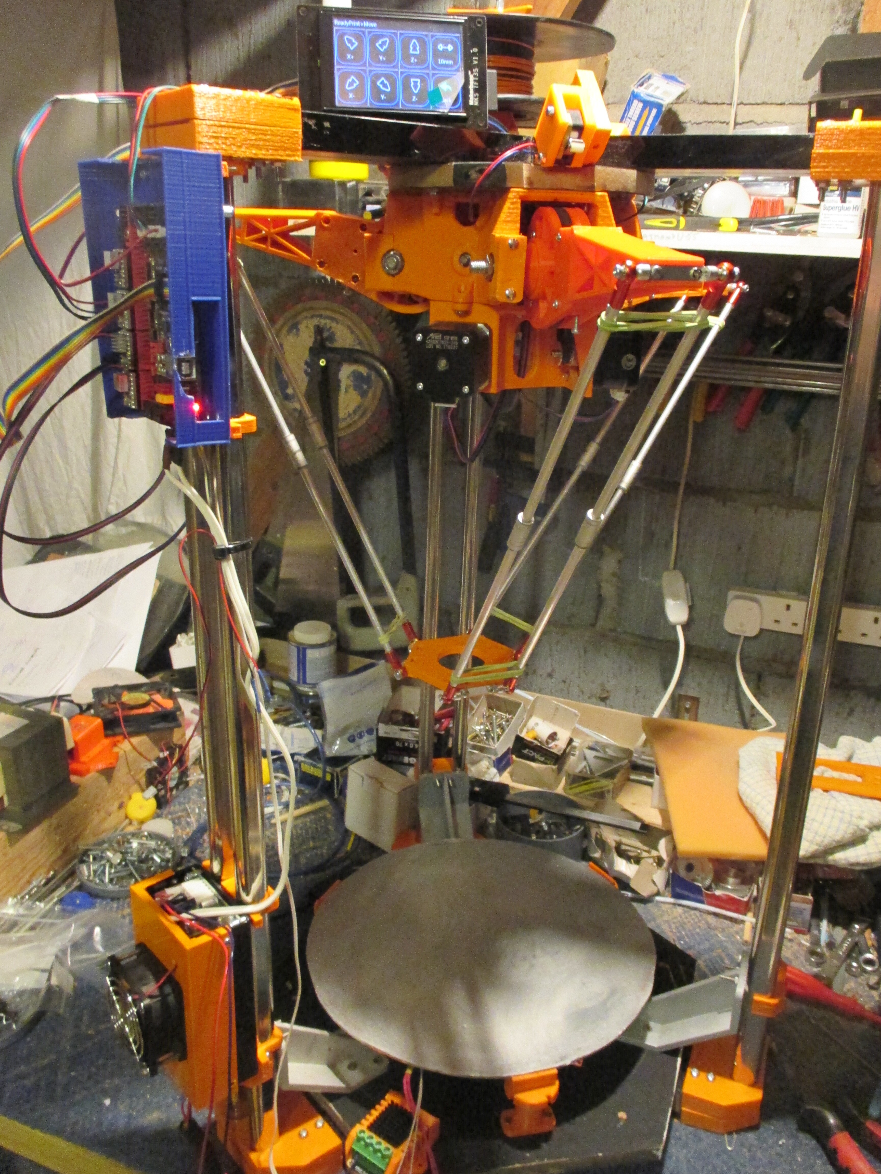

Hardware configuration is firepick type layout ( hope the photo is clear enough). At the moment I’m using a spare SKR V1.3 board I had because it will run smoothie and the touch screen I’ve lifted off another printer to try this machine. If I can get it running successfully I will change it for a smoothie board so that I can use the wifi.

Having never done a rotary delta I will have to review the details to get an idea of where the problem resides. But perhaps one of the smoothie guru’s like @Arthur_Wolf would be a better starting point.
Thanks Eric hopefully Arthur_Wolf will notice the post shortly
I’d appreciate a video of the homing.
Also, can you try adding to your config:
delta_halt_on_error false
Also, try setting the W parameter to 1 (M665 W1 I think) and try running the homing again?
Looking at the code, it looks like you’re trying (through config or movement) to ask the machine to do something that’s mathematically impossible.
Your input is very much appreciated Arthur, I will try and make a short video tomorrow.
with regard to the line you’ve highlighted in the file, I have seen this in the eeprom somewhere so I will go through it tomorrow and post again.
Thanks to you Arthur homing is successful!! , as I hope the vids show. There is still a problem I have to overcome and that is when the arms are below the horizontal homing stops when the arms reach horizontal and it shows “homing cycle failed- check the max_travel settings” but whatever I try makes no difference. but if I raise the arms to just 1 or 2 degrees above horizontal homing works as it should (I think) problem, the vids are larger than this program will allow .
The option I added prevents it from complaining, but it’s complaining for a good reason you need to figure out based on the math.
For the video, try youtube.
It was complaining for a very good reason Arthur, and as usual the problem was right in front of me-- I had entered the wrong dimention for the Delta_Z_Offset . There is still a lot of tweeking to do but it is now basically working as it should. I managed to upload a video of it homing at the end of a “print” ( I have yet to install extruder and hot end) The video is on Vimeo I think you can find it seaching for Rotary Delta 3D Printer
So glad you got this to work, I added the video to the gallery on the wiki.
Thank you Arthur, but lets not forget that if it was not for your input I would still be scratching my head wondering what to do next !!
If you want to thank me, once the machine is printing, make a video showing it’s printing, publish it to youtube, and give me the link so I can share it with the Smoothie community :slight_smile:
